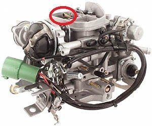

A couple things I spotted while looking at the still picture of the video, it appears like your missing a rubber vacuum plug (even though now your saying you've dealt with them). And it looks like your missing a screw to hold the top half of the carburetor to the middle half. It's right next to the block-off plate to OVCV.
Originally Posted by mct75
I removed the...secondary "lockout" linkage and metering needle flap (the thing that looks like a choke on the secondary, whatever that is). The entire secondary is fused shut so there's no point in having the linkages in the way.
The secondary valve serves a variable venturi for the secondary barrel. With it forced closed, I expect the power will be reduced. But let us know, I'm curious.
The secondary barrel has no venturi. Therefore the top plate initiates the vacuum to draw out fuel in the secondary circuit.
Plus in the video, I don't see the mechanical main accelerator pump move when you blip the throttle. Or it could be your not moving the throttle valve enough for the linkage to engage.

Thanks for the pointers! Good catch on the screw. Off the top of my head, I think I removed it when I took the wiring harness (choke heater, OVCV, FCS) off. I will look for it!
I've actually got all those vacuum ports soldered shut. I had horrible luck with parts store vacuum caps cracking and leaking on me. The solder should be permanent, but removable with some effort.
That diagram explains perfectly what the "metering needle flap" does. I guess when you're flowing that much air you don't really need a venturi. Except my secondary throttle plate is jammed shut. It looks like carbon/black goo has encrusted the shaft so thoroughly that vise grips just start to round it off. No idea what really happened but it will never open again. I'm happy with the lack of top end (a 350k mile motor should not redline anyway) so the one-barrel nature of it is fine with me. Opening the metering needle does seem to affect the idle (which is of course 100% primary) so there's an interaction there I am not understanding.
The accelerator pump does work, it just takes a bit more action before the cam starts to move. I have some pics and videos of me playing with it all.
