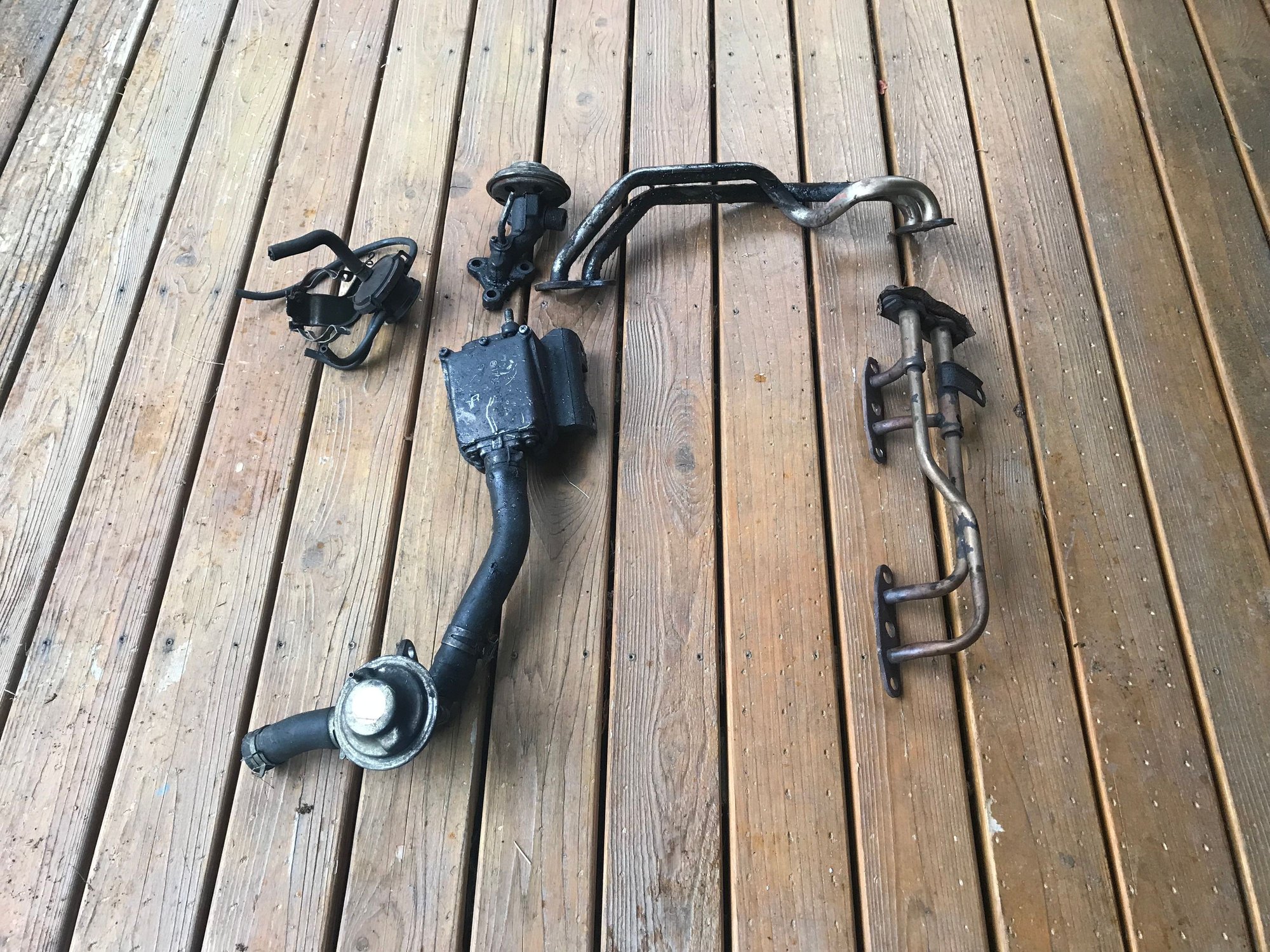

Finally got all the parts and the time to take this on. EGR delete not so bad and wished I had done it sooner. Watched several videos and surprised to see so many EGR configurations on the 22R. Mine required the 2 plates on the exhaust manifold and the one triangular block off plate on the other side. Some of the bolts a bit tricky to get to but could have been worse.
So much stuff came off---
