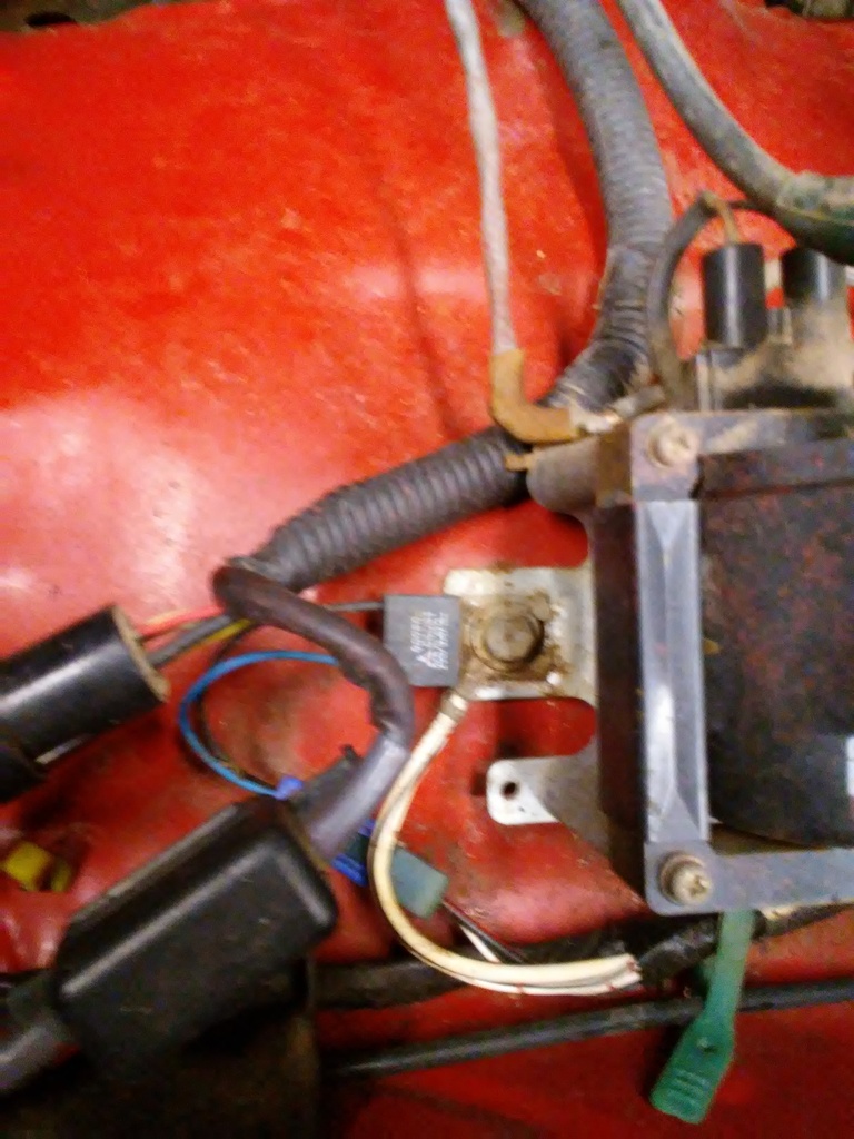

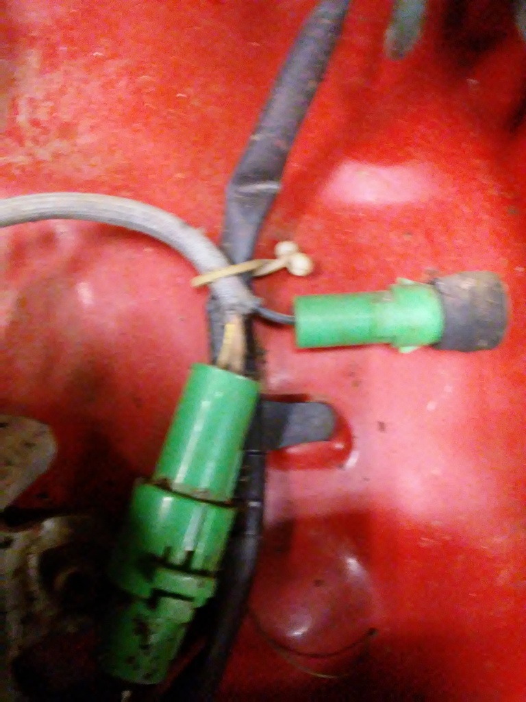

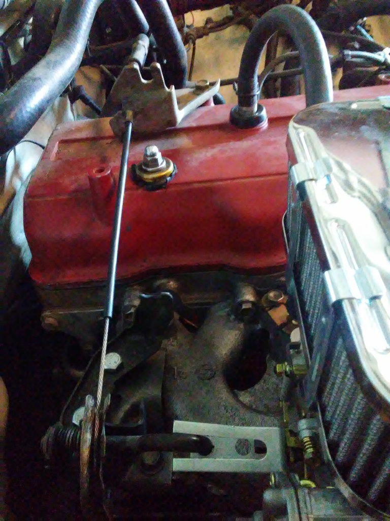

So the top photo shows the tan and black wires in question Wyoming9, I'm sure they are the roadblock to spark, just don't want to blow my coil up experimenting. The lower photo shows the throttle arrangement I have. Just doesn't feel or look right. Been too long since I had a carb under the hood, don't remember.

For the throttle cable It comes through that bracket behind your breather .
The bracket you have on the Carb needs to move to the Valve cover .
That should line the cable up to pull correct
Once you look at it it will be a DUH moment we all do things like this that is why another pair of eyes helps
Just what wires are connected yet to the igniter ??
Are there any wires missing .
Are the positive and negative coil wires attached ??

The correct way for your Throttle Cable is below. I think the one down on the Intake might be for Cruise Control or something. I am no help for you Coil Problem. I do see you have a cable a little different then mine. Yours might be an 83 cable???

The lower mount is the transmission cable.
Trans cable assembly

I'm going to assume that plug next to the ignitor isn't plugged in the ignitor.
Best I can find that ignitor module only has two plugs, one is the distributor Ne, the other contains power and a tach output, some have the test connector also which is tach signal coil negative post.

That plug with the black cap is one of the test connectors
In that age there was only two green plugs coming off the coil igniter
Who knows what might have been added or subtracted by the previous owners

I don't think I noticed the check connector before. I was looking at the other plug, taped to the harness and plugged into the assembly. That has what I'd say are odd colors for a power and "ground".

Key off there is no power on the heavier gauge wire correct? Verify that it is connected to the ignition switch Ig2 pin 7. That'll be the coil supply.
The black line should tie into the tach signal. Verify its connected to either the tach gauge or emissions controller pin #4of13 on the California or pin #11 on federal.
