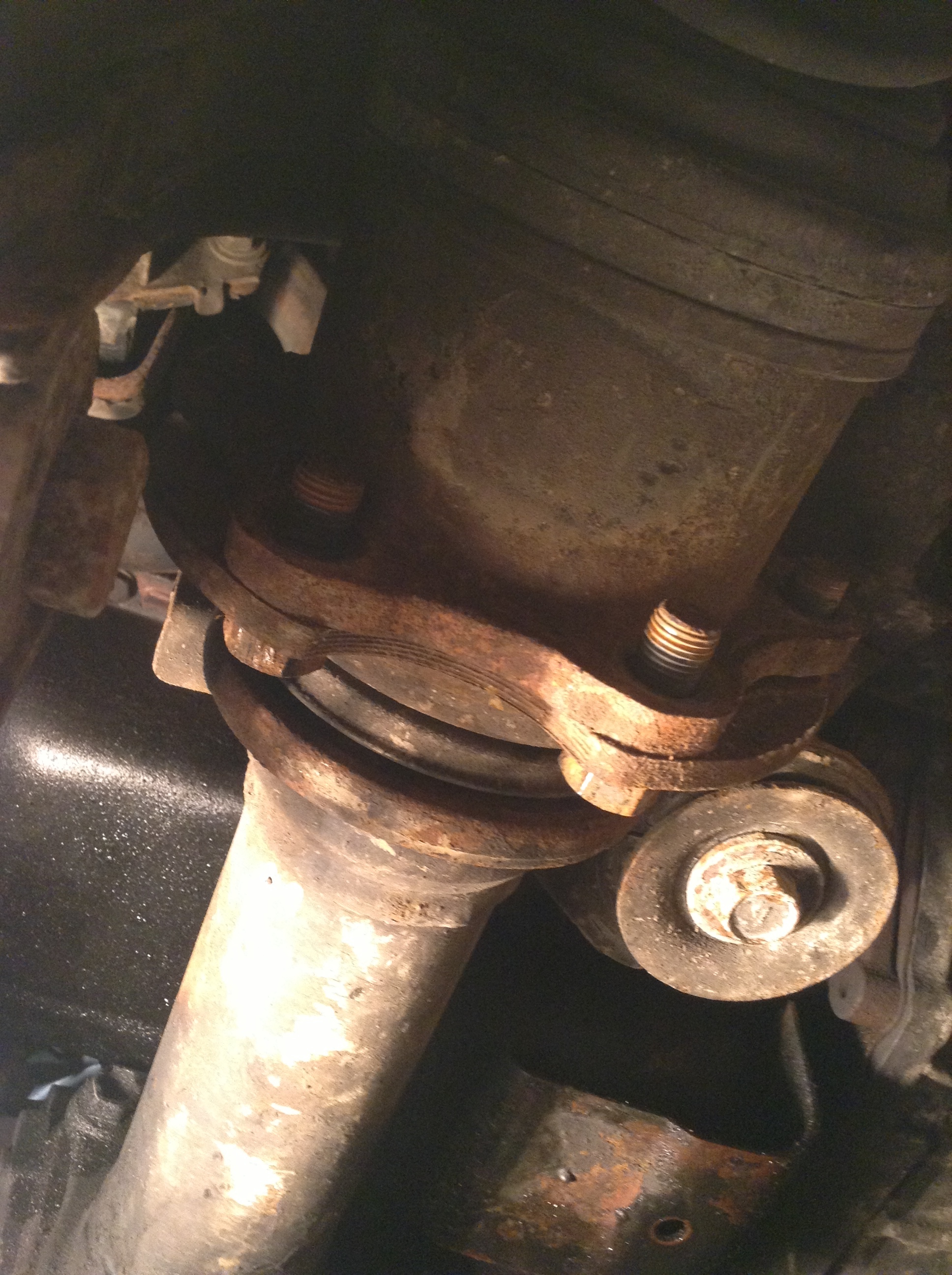

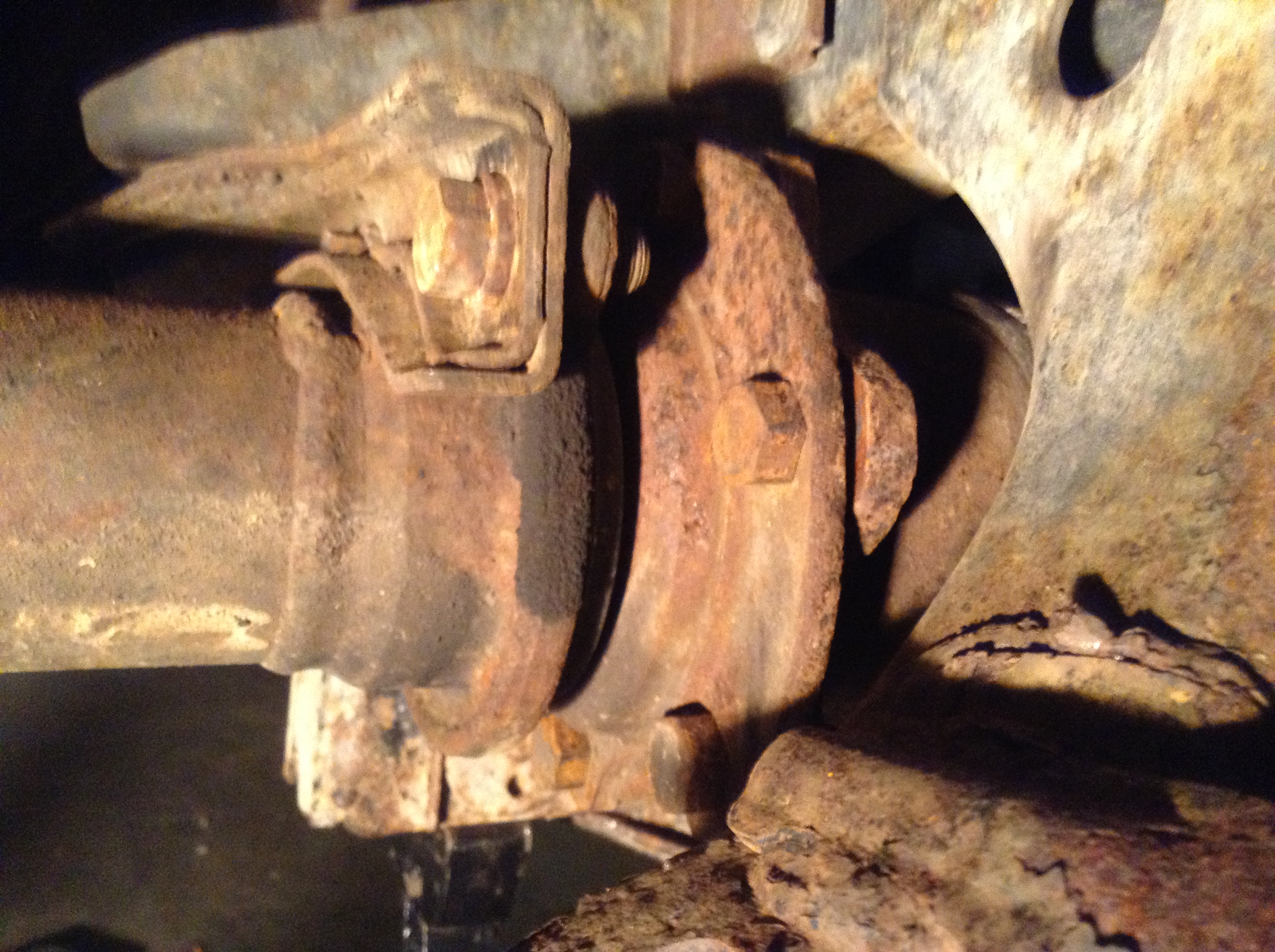

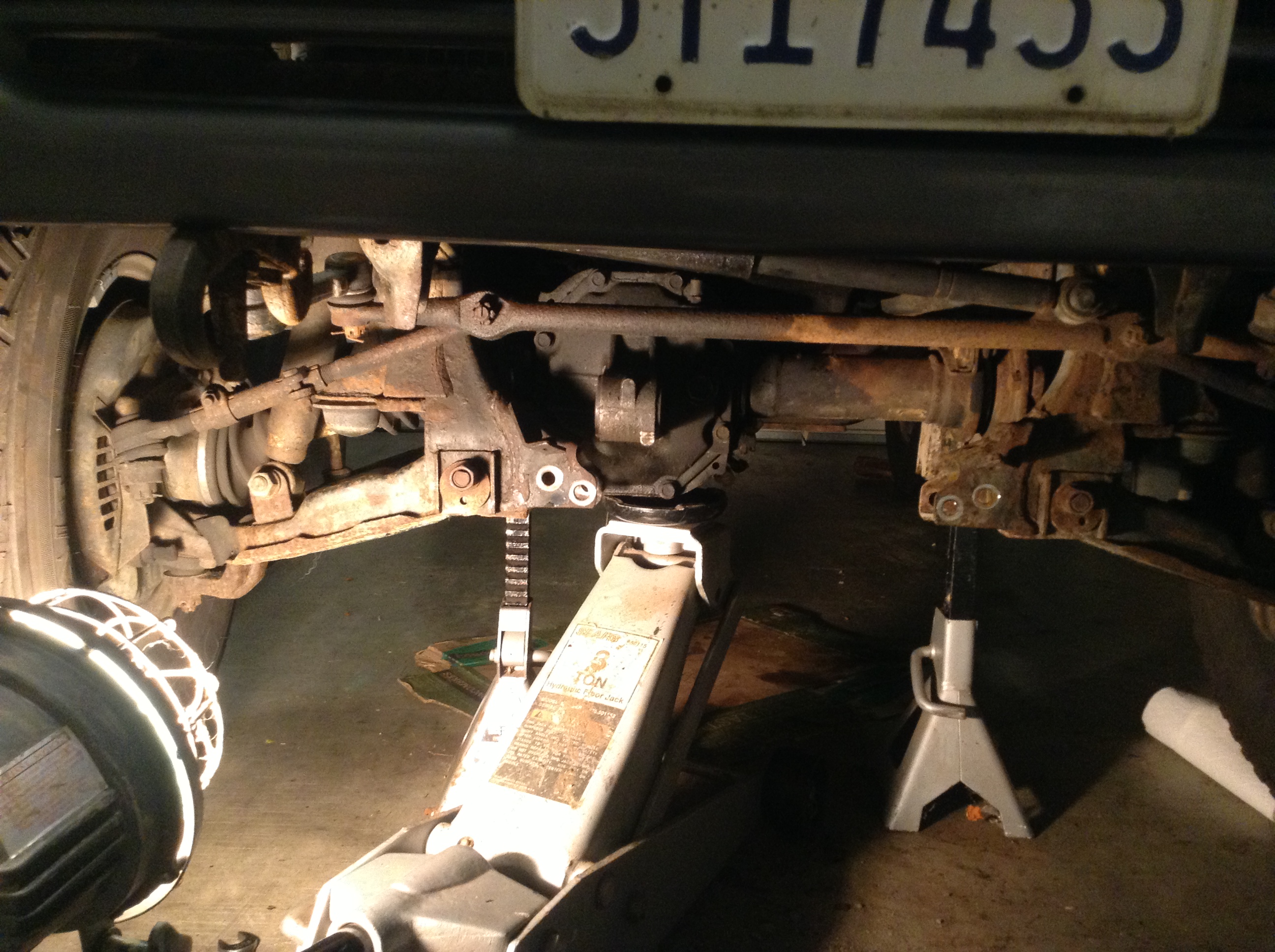

I decided to replace the rod bearings and repare my leaky oil pan, but i can't seem to pull the differential. I have all the bolts pulled, cross member, drive shaft, mounting bolts, i just cant seem to get the bolts from the CV joint out. You can see in the picture I got the nuts off, but the nuts are still in there. How do I get them out?
