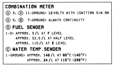

Looks like the older ones just didn't have a fuel light. I also ran across the ohm specs, looks like they are an exact match.

The 86 diagram:
The variable resistor is the level sensor. What the float is attached to and moves as the fuel level rises and drops. Essentially, it changes the resistance to ground of the meter. As the resistance changes, the voltage through the gauge changes, and the gauge pointer moves accordingly.
The symbol of the circled resistor is the sensor for the Low Fuel light that comes on with about 1-3 gallons left in the tank. When it's covered in fuel, it has one resistance, keeping the light shut off, and when the it's uncovered, the resistance lowers, providing a path to ground for the voltage applied to the lamp, allowing it to come on.

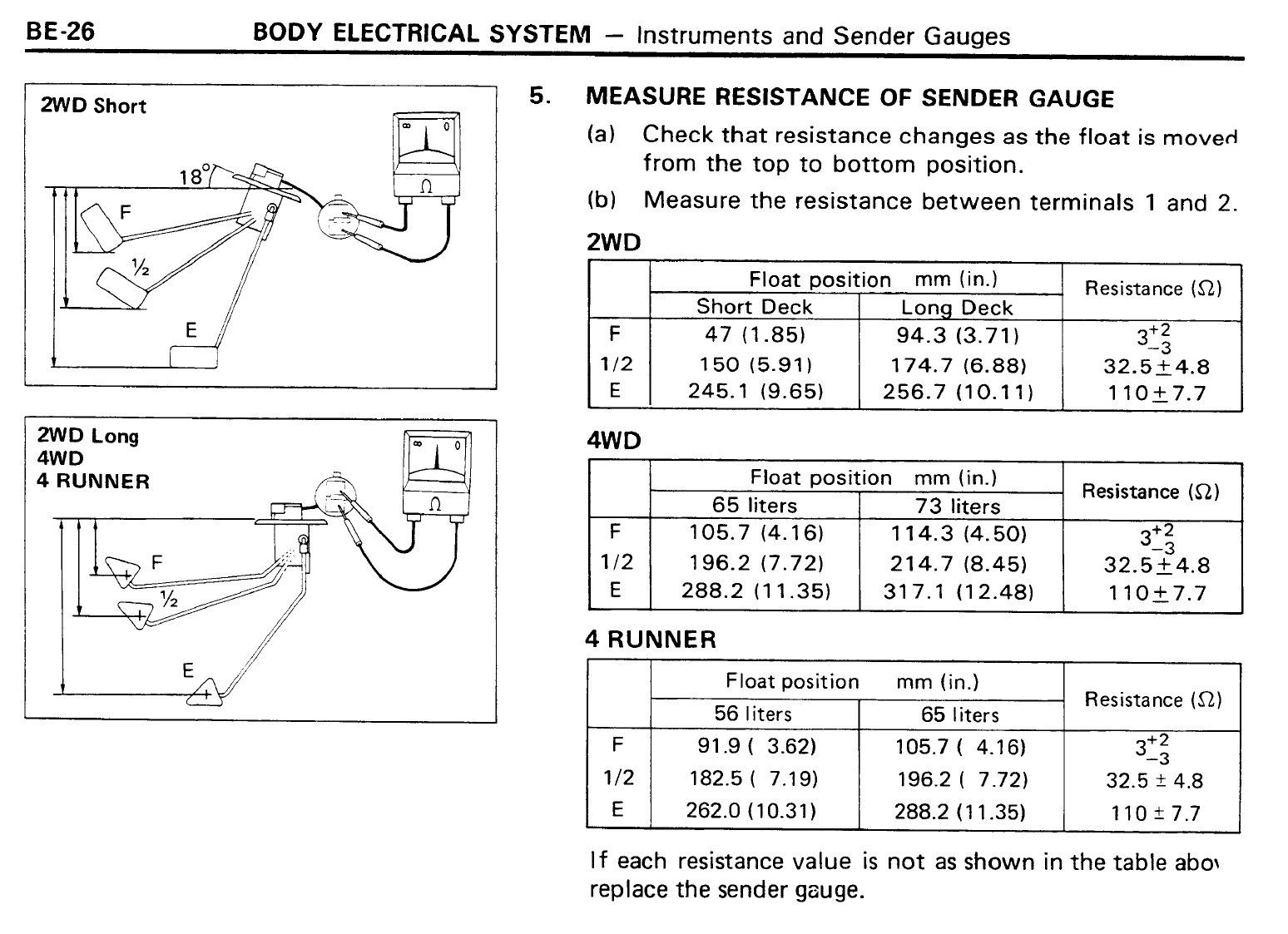

I received the $40 aftermarket. I tested the ohms and compared them to the diagram in the manual (same as previous post) since my original was shot. The range on the new one is closer to 12 ohm - 80 ohm, instead of 3 ohm - 110 ohm. What this means in real world on the actual gauge in the truck, as I currently have it in the tank playing with it is that....a full tank registers as 3/4, and 3 gallons registers as just slightly above E, and empty is just below E. If I was so inclined, I could probably open the cluster, pull the needle, and reposition it a little more towards full. However, I would much rather have an accurate E than an accurate F, if you know what I mean...lol. The wiring is no biggie, going to splice in and reuse the round plug style. Weird, though, I swapped the positive and ground to see if it made any difference. It did not. Overall, I am happy with the cost, the quality, and the variance is acceptable for my bare bones fun truck.

If that aftermarket sender has the fuel light circuit, I'd say add a light somewhere so when it's low on fuel, it will give atleast a warning, instead of running out before it hits "E". Most vehicles can hit "E" and go a fair distance before fully running out, so anyone else driving it will be really confused if they run out a bit early. My 95 ford diesel runs out right as it hits the red of the "E" line, but it has 2 fuel tanks, so now I know there's no fudge range in that gauge.
You could "hack" the sender a little, adding resistance inline would increase resistance, and running a resistor across the signal and ground would decrease the resistance. Would have to do some math to estimate the effect, easiest would be to install a pot, but not sure if any are rated for gas, or how well it would hold up to the road elements. A standard resistor is pretty rugged though. Adding resistance inline adds old value + new value, so 80 + 30 would make you hit the 110ohm (assuming that's full though?). For the other, I had to look up the math again. basically 1/12 + 1/x = 3 ohms, yay for algebra. Looks like it would be a 4 ohm resistor. Of course problem with that is, the "full" ohms would be 3.81 ohms, so would work for empty, but full would be so far off, probably unusable.

I actually thought about the resistor idea, but like you said, you can only fix one side of the scale or the other. Or, lol, have a pot wired up inside the cab, dial it one was for and accurate full, and as you run down the tank, dial it the other way for an accurate empty. All that, might as well spend the 150-200 on the proper float.
