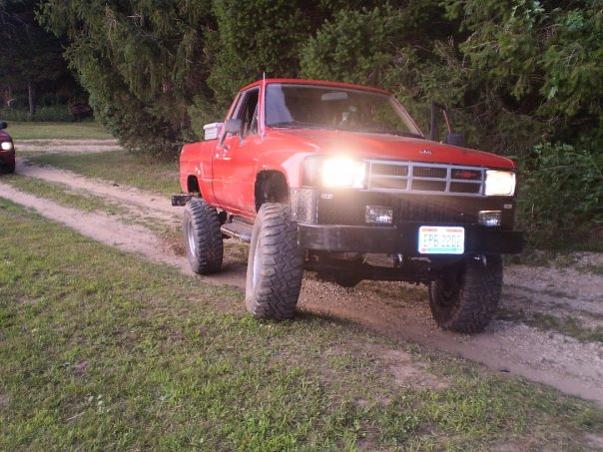

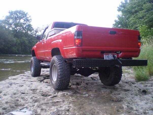

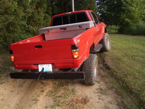

Ive got a 1985 extended cab pickup with a SBC 350 in it. RUns like a top, however have a few knick knack problems I don't exactly know how to tackle, and could use some guidance. Ive used the search but haven't exactly come up with what I need. Thanks in advance for the help.
First off-Ive got that damn leaky hub issue. It is leaking diff grease on the front drivers side knuckle and making a damn mess! Is it the inner or outer seal? I am confused as to which one it may be, and how difficult it is to replace each one? Do I need any specialty tools/pullers?
Also, Ive got some more diff grease leaking in the back. I looked up a parts diagram, and it is the rear differential oil seal...It looks like it is right under that "cup" on the tail end of the diff where it bolts up to the driveshaft. How do I get that off and where do I find JUST the seal, Ive looked everywhere!!
Anyone know of a good place to get front steering components such as linkages, arms, etc? I am in dire need of an alignment but need to replace a few parts first.
ALso- what kind of shocks are a good replacement? Ive got a lift kit on my truck, and need some new shocks. ANy suggestions?
Oh, and my truck is a pic whore...so here u go
