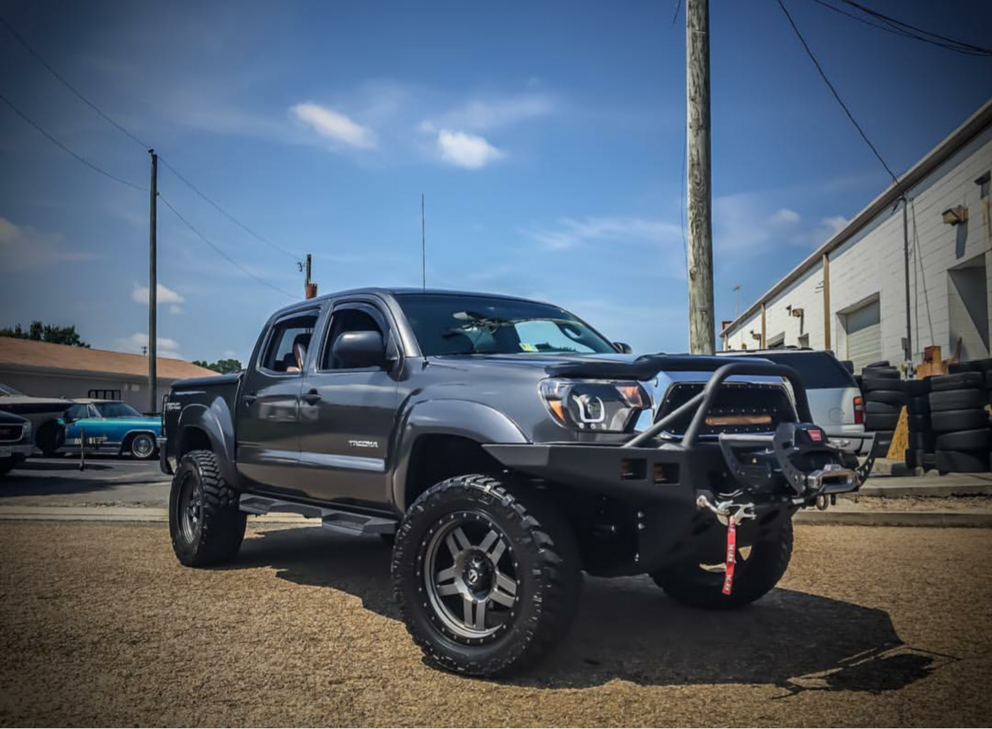

True I've built a 2013 Tacoma and wanted to go Ole School.....lol

Nice rig! Is than an old Cadillac in the back?

I belive so. This was at my buddy's stereo store.Howes Audio.

I'm starting to love red trucks. I forgot until just now I've already owned two red trucks and a red VW, MG and Corolla. I guess I DO like red. That cleaned up nicely. It would be nice to have a truck with no ECU. Are you somewhere in VA due to your screen name?

Your 2013 is beautiful.
