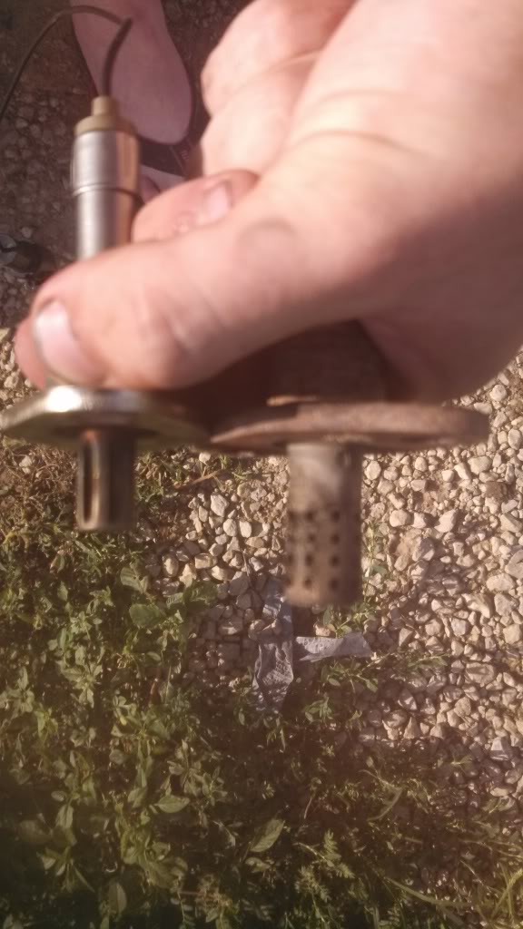

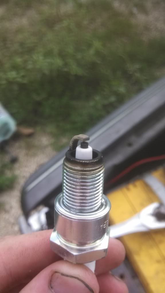

Pic of the #1 plug (all look like that). And the o2 sensor compared to the stock one. Can't reuse it cause the wires broke.
Could the o2 sensor not getting a good reading cause it to run lean? I've tried adjusting the TPS and it fixed the rough idle I had but not the lean condition. I don't want to put any more miles on this until I fix the lean condition.
It runs fine and has plenty of power, the plugs are just white. It will sometimes pop or misfire on decel a little but I think I have that fixed.

I'm not sure you can tell a whole lot in 15 miles. Engine is fresh rebuilt, so its tight, and will run a bit warmer. This could add to your possible super clean burn. The only info I would rely on is an exhaust sniffer to tell me what the actual readings are. You could monitor O2 voltage/readings but that won't necessarily tell you precisely what the engine is doing, although it should get you in the ballpark if its trying to over-richen the mixture. Just my thoughts....
And from my experience, a decel pop is usually indicative of an over rich mixture. Causing excess fuel to enter exhaust, where it ignites. Or an exhaust leak sucking in oxygen which then ignites excess fuel.

400 something miles on it and the plugs are still the same for the most part, I think it just burns really clean still. Still having problems on decel and very light throttle especially when cold, so I think I'm gonna grab an o2 sensor and TPS off a junkyard truck when I get the chance and see if that helps.
