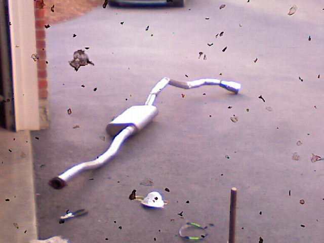

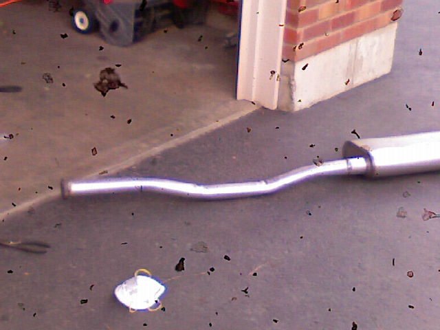

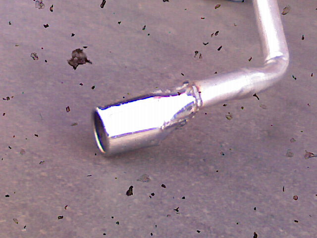

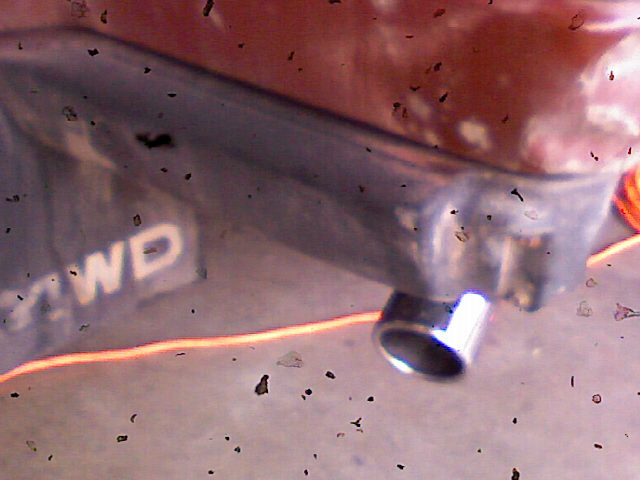

i've got a few pics of the finished product. not bad for a first time project in welding. Couldn't have look prettier, but couldn't function any better.

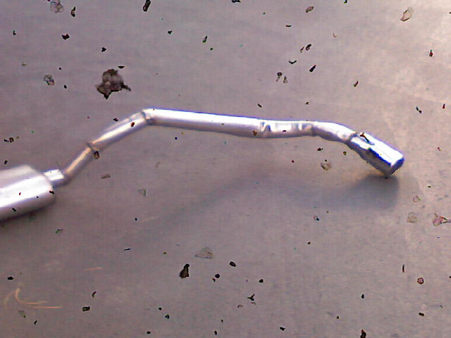

few more pics

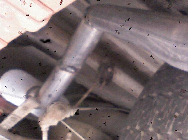

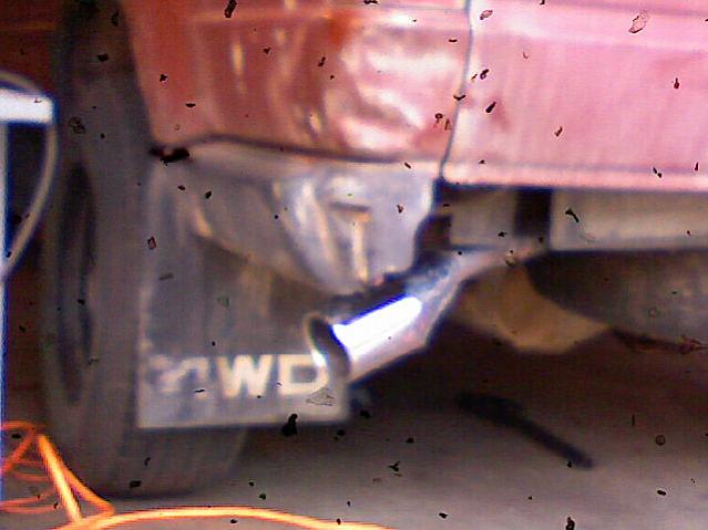

and a couple more

Not to bad congrats. Does it sound cool? Do you feel more power?

Yeah, it sounds pretty good. It's a little louder than stock, but that's about it. Perfect for me cause I don't want to hear a loud exhaust in my cab as I drive everywhere I go. That get annoying really fast. I got a pro flow 18" or 19" muffler with 2.25" exhaust.
As far as power, it's tough to tell (there's got to be, there's not cat and it's free flowin now). I'm sure there is, but I haven't had much time to drive it around or test it out. I'm still workin on the weber 32/36 that I installed a few weeks back (possible vacuum leak and it needs tuned).
As of now, I don't think my truck and any emissions items on it anymore. ha ha ha
