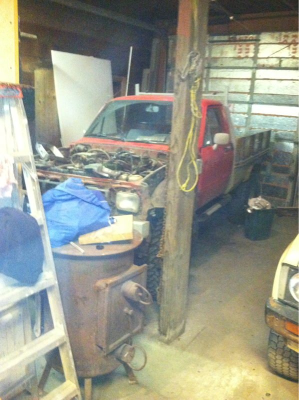

I have this 1983 toyota that my dad bought from the show room in 1983 . It sat in my yard for 10 years then I got it going! I wanna paint it now and been wondering what kinds of paint 2 use! I wanna keep the body red but it would be cool to have some more Input!

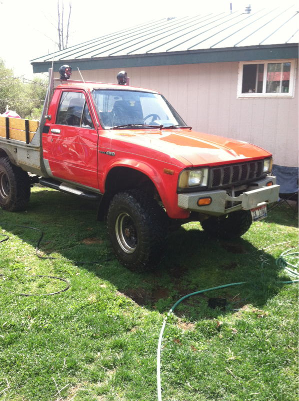

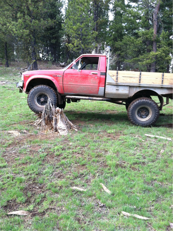

More pics

From those pictures the paint looks good for being original. If you are going to keep it red, try simply doing a deep detail (cut, buff, wax). You would be surprised how good old paint can turn out.

Just drive that thing! There's nothing wrong with it. I wouldn't worry bout paint til ur ready to fix the dents, then I'd be afraid to USE the truck. It's perfect the way it is, unless ur wanting a mall crawler instead of a man's truck. Lol.

Were these trucks clear-coated from the factory? Mine doesn't look like it.
OP, I like your front bumper.

I also wanna paint the flatbed!! My dad put alot of work into (I was a baby at the time) mostly for rust prevention... Ill get some better pictures when i get home.

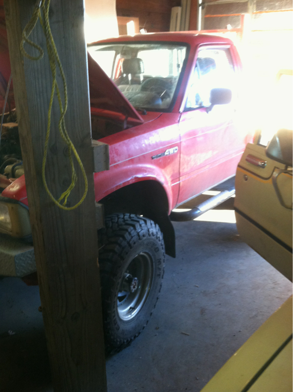

So last night I took my front end apart and started sanding! I bought a quart of a glossy red and glossy black! I'm gonna do black on the lower stripe on the doors that extends onto the fender. And black on the stripe on the hood

Looks like it has lots of dents, are you going to fix that? The most important thing about paint is prep, lots of how-to on the net, you can also look for ''50$ paint job''. Got any pics of the other first gen next to it?

Hey thanks!! Pretty much all the door dents pushed out! I'm gonna call around tomorrow all the scrap yards for another fender because my driver side one is gonna take alotta bondo.. I have done my research and I have been taking my time on the prep!
