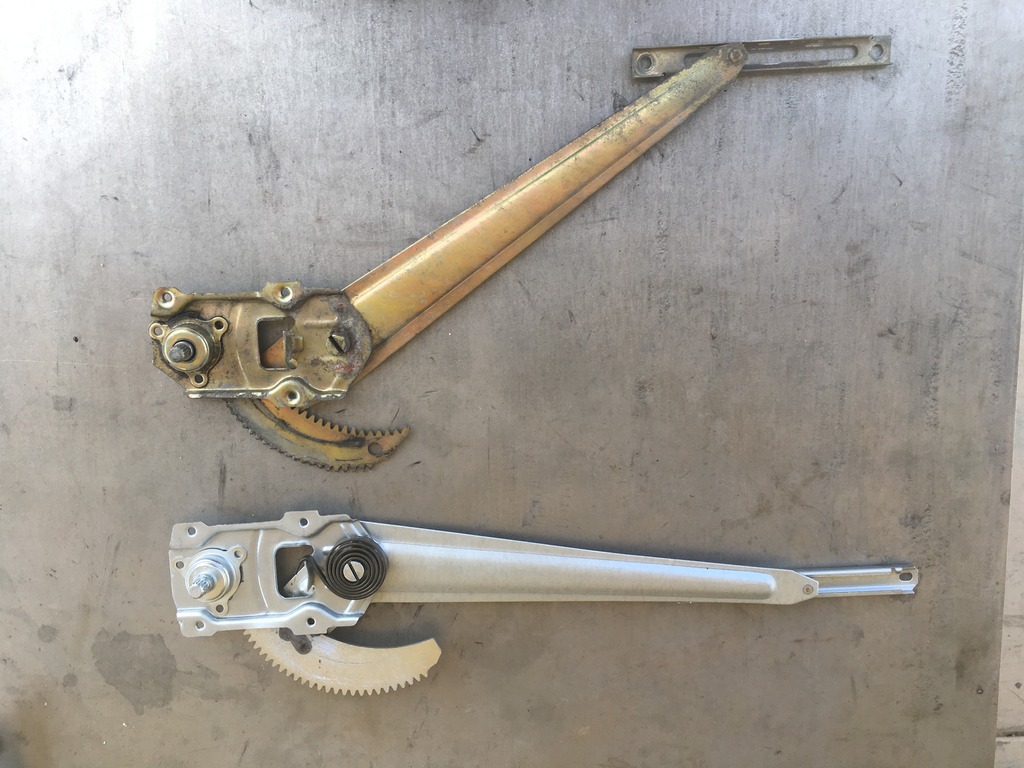

Going to update this thread for others looking for pre 84 window regulators. The 84+ vent regulator will not fit the earlier door without a modification, the arm is clocked about 30 degrees differently from the original part. But, it can work with some cutting and welding.
I had difficulty finding a pre-84 regulator, and when I finally did, it was about $80. These are about as low-tech as you can get, so I wasn't going to pay that.

It took about 30 minutes for me to get it installed and working correctly. Here are a few pics to show the differences and what I did to get it to fit. Hope this info helps someone out.
Comparison, original 83 to the 84. See the difference in the arm - it's bent about 30 degrees. Note the gear radius is placed in approximately the same position on both.

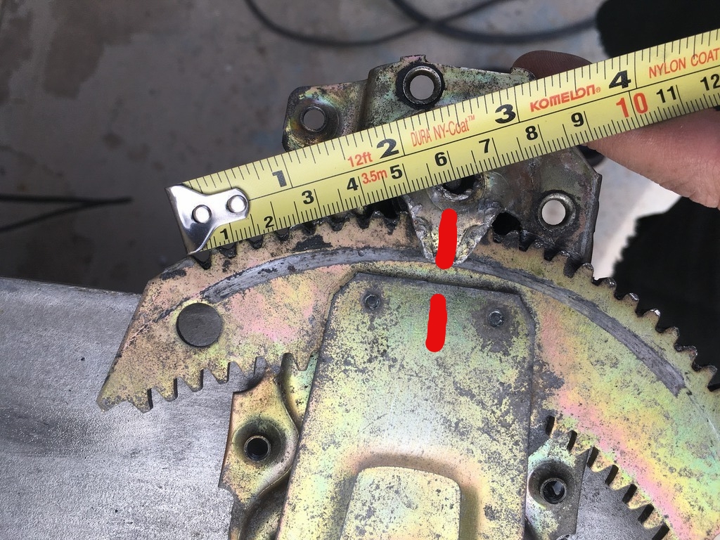

On the first installation, i noted that the window rolled down a little too far, below the top of the door by about an inch. I removed it and made this measurement from the old to the new. Note the two red marks I made, line the arm up as such, then I measured from the center of the gear to the end of the last tooth. See next pic.

Here is the same measurement on the new arm... It has two too many teeth allowing the window to roll down a little further than stock. No problem, weld it up

Actually I thought I would have to drill those spot welds and re-clock the gear as well, but after cutting the arm I realized I wouldn't have to. Either way you need to cut the arm. If you look at the pics closely, the arm on the new one is actually bent (or doglegs), so reclocking the gear alone wouldn't work. Besides that, because the arm isn't straight, it contacts the forward window track support (where it bolts to the inner door skin) before it can reach the full down position.
