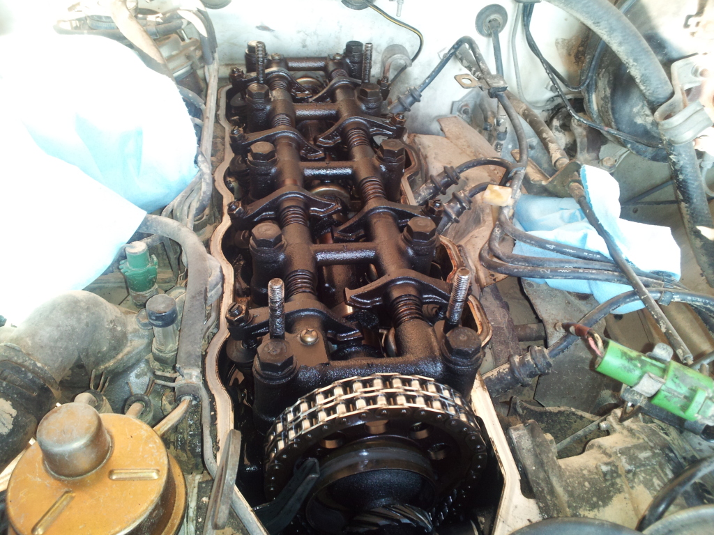

My 83 has a dual chain on it
Old Aug 7, 2013 | 06:52 PM
83Toyota88's Avatar
Joined: Apr 2011
Posts: 1,220
From: Memphis, TN
