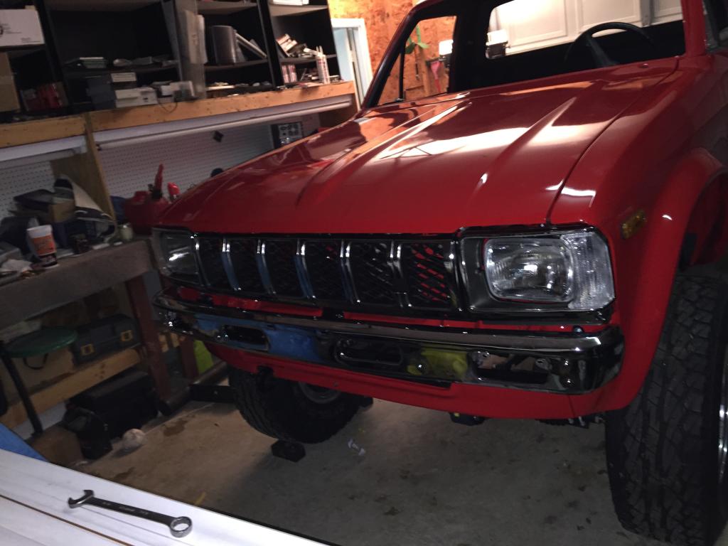

I will bestow upon you what knowledge I know about bumpers. The early bumpers (79-82) WILL fit a late (82-83) truck BUT the bumper brackets are NOT interchangeable between the bumpers so you'd have to get the bumper brackets that match the bumper. The holes in the bumpers appear the be the same, but they are spaced differently both horizontally and vertically. So for my 83 I had to get 79-81 bumper brackets (direct bolt on) to match the full wrap 79-81 bumper that I found. Just installed it this week (still needs to be adjusted so it fits straight):
Now here is the kicker, you have a 2WD so I'm not too certain on the bracket compatibility since those brackets are completely different than the 4WD brackets. I would start by finding so early brackets and seeing if they fit first. Then find the bumper.
