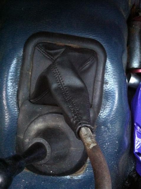

81 pickup
I need to get both shifter boots for the trans and transfer. They're pretty close together so I'm not sure how the universal generic ones will fit, the base seems pretty large on those. I have to weld in some new metal because the tunnel was cut up and mangled when I bought the truck, so I'd like to find some decent boots with the metal ring and use them to help create my template when I patch the tunnel.

Unless I'm wrong, what I searched around was no one makes factory spec boots. Read some post about nos ones for like $120 something on ebay. Definitely not going that route.
Guess what I'm asking, if any knows, or can measure theirs, those that have the origional, what the size for two aftermarket boots would be. I've seen sizes from 3 1/2-8xx inches in squares, rectangles. Parts stores around here don't really stock them, would have to order it.
