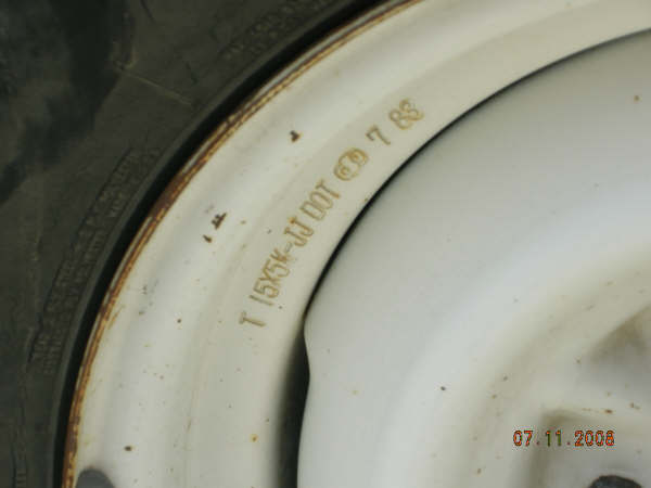

Stock is 15 inch, dont know width except 225-15 is perfect replacement to original imo, I use the larger 235 as there a bit better ride and easy to find. Not many vehicles used the 225 but can be ordered.
Doubt you care about original but put it in anyway. When I went to the 235's it did slow down more in 5'th going up a long grade like the grapevine and sometimes have to shift to 4th where I didn't before but can live with it for the few times a year going up steep hills.
My 15" wheels are 5.5" but think they came in 6" also. I do need a stock 6 lug 15x5.5" wheel or 2 if anyones close within 75 miles of LA?
PS. Tire pressure; I use 29-35psi rear depending on load and no more than 24-26psi front cause of solid axle. Others will disagree depending on tire size perhaps

I think you mean 225, not 255. I have 235 on original SFA steelies and they bulge about as much as I'd be comfortable with; I already expect to see a little more centerline than edge wear in normal pavement use. SFA steelies are either 5.5 or 6 inches wide. Later IFS steelies are 6".
What size wheel you should use depends on what width tire you want. 15x8 is appropriate for 235-275mm (about 9-11 inches) wide treads. 15x10 for 265 (10.5) and up. If you want tires bigger than 30" diameter but not wider than 9", you pretty much have to increase rim size to 16 or 17; nobody makes any 235/85R15 (but they do make 235/85R16). I've looked pretty hard.
