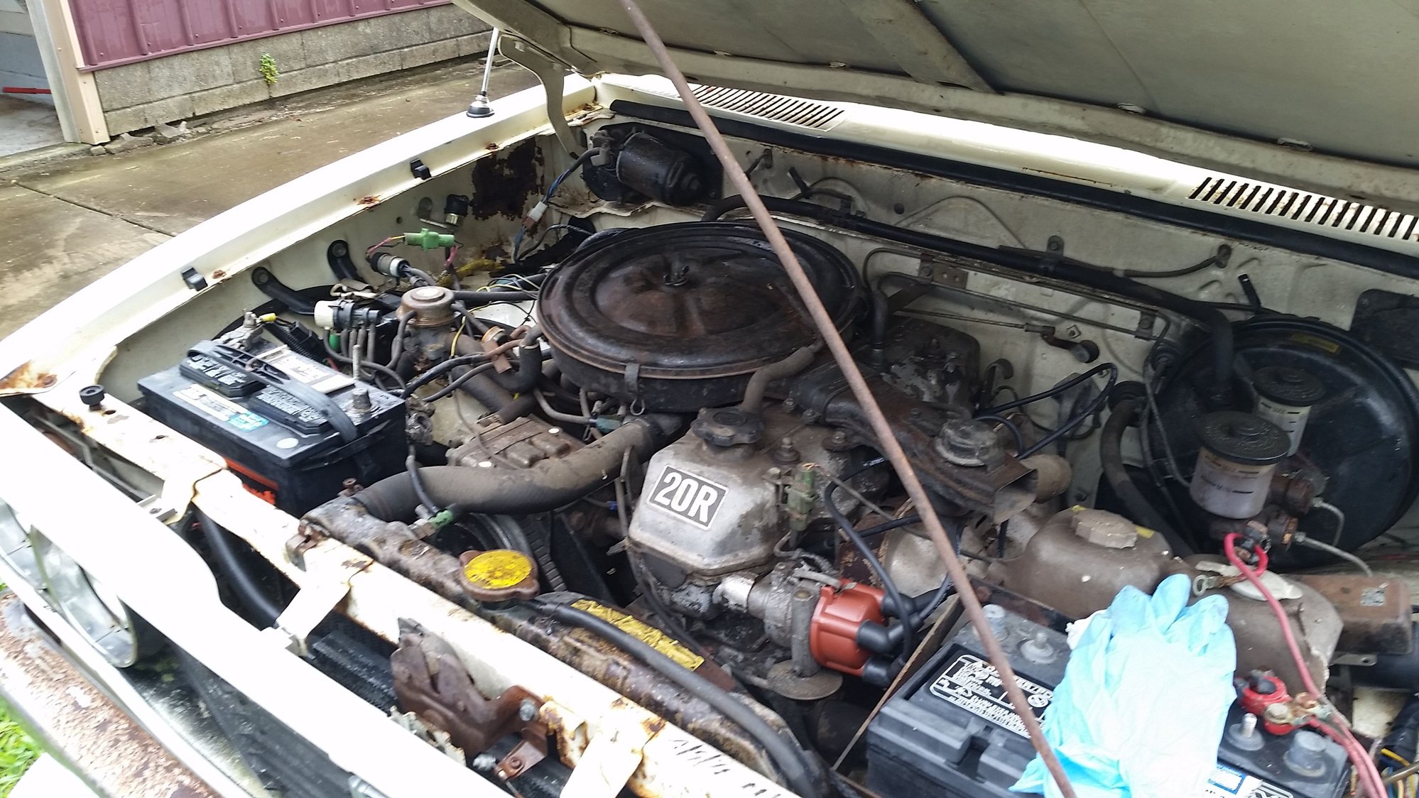

Please help me identify this rat eaten electrical/vaccum part on passenger fenderwell
Rodent chewed the wire on this part. Has a vacuum hose on it.
1978 Hilux 4spd m.t.
Not getting fuel to carb, but I hear "click" when I turn ignition key. Runs if I pour gas in carb.
Also, if I disconnect oil pressure switch, would the fuel pump work if it were in good shape?

Which fender is this? Take a wide angle shot so we can see where the hose goes.
Wheres your fuel pump? Is it mechanical or electric?
If you spray starter fluid to get it running will it keep running or does it shut down immediately?

Passenger side fender. Fuel pump is electrical and it's in the tank.
No need for starting fluid.
Starts right up when I put gas directly into carb; runs until gas is used up.
I think hose goes over to area under breather and a bit to the front side of it.
It's raining hard right now. I'll take another pic and send when rain slows up.
Thanks for you effort to help.

That thing in your photo is a vacuum switch. For my 1987 Truck, that vacuum switch is used for part of the Deceleration Fuel Cut System. I am not sure if it is the same for your truck.
A vacuum switch of this type is an electrical switch that either turns on or turns off based on how much vacuum is in that vacuum line going to it.
Are you getting fuel from the tank to the carburetor inlet? This will help narrow down where the problem is.

Vaccum hose attachment. It's the topmost one.

Where vaccum hose hooks in around carb.

Wide angle looking at fender well

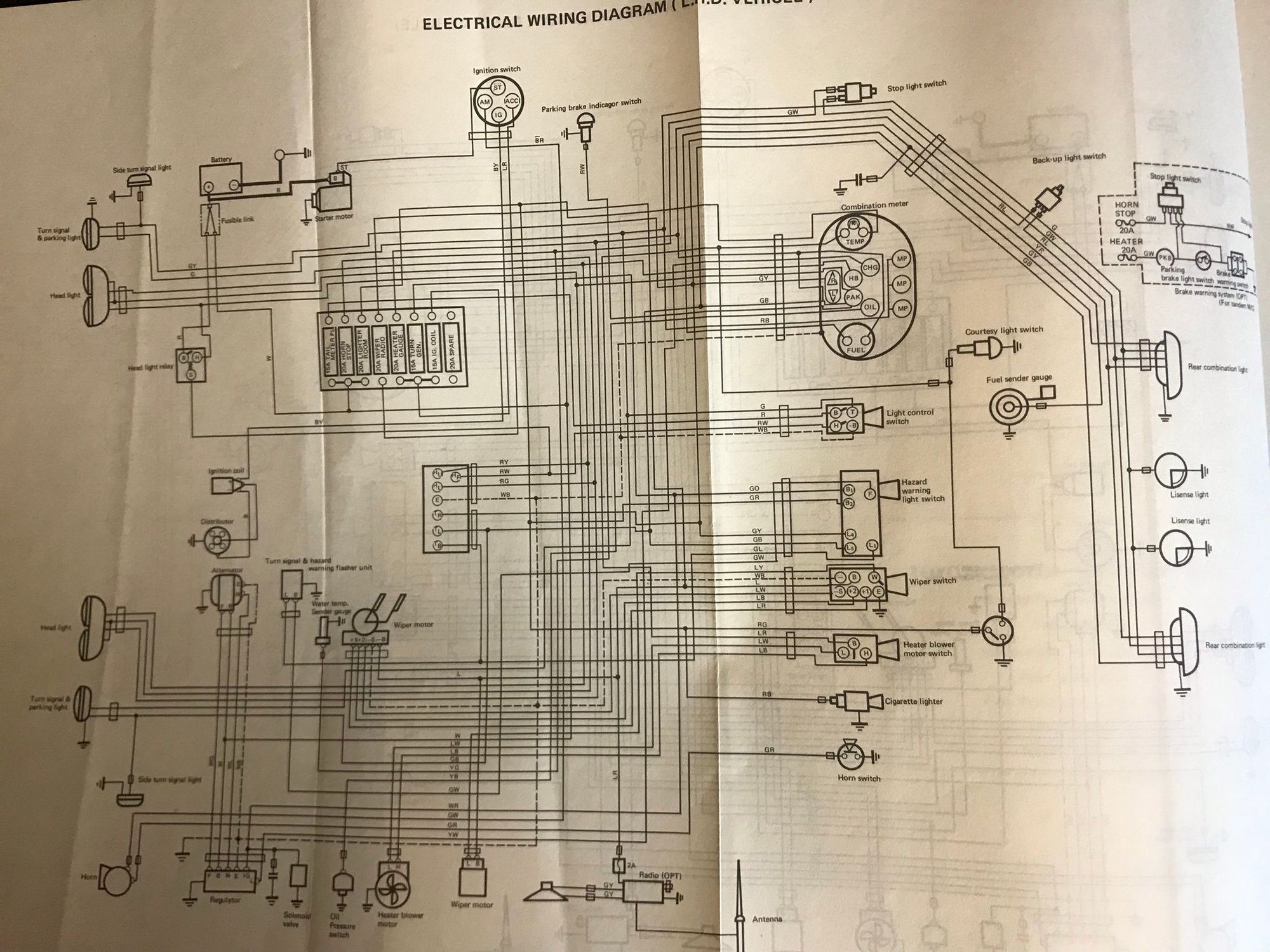

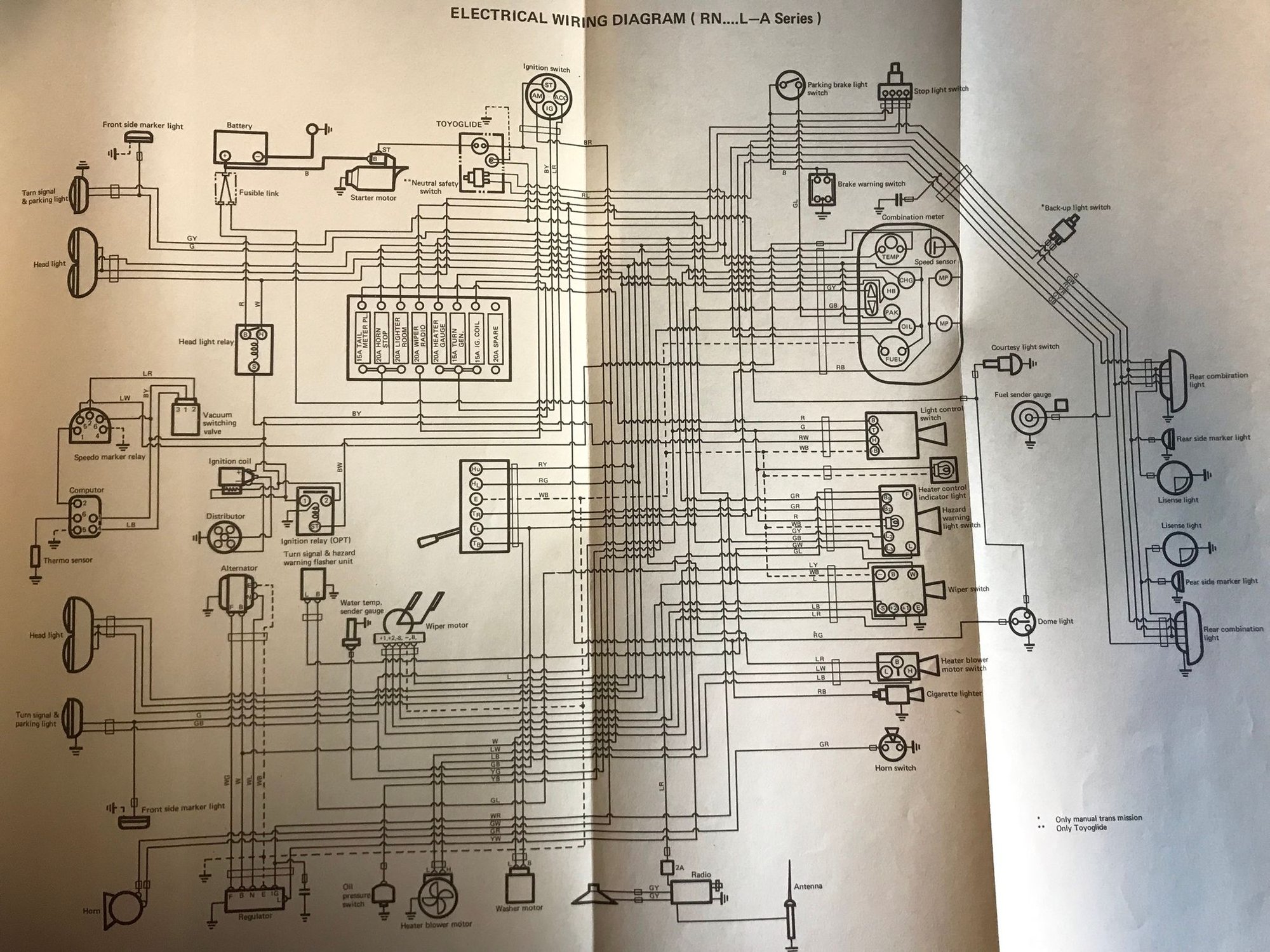

Maybe these would be helpful. I'm also having a starting issue. Good luck!
Old Aug 21, 2019 | 08:35 AM
Rusker's Avatar
Joined: Sep 2008
Posts: 177
Likes: 12
Here is another diagram that is a little easier to read
