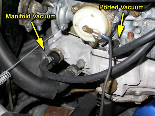

1) I am having troubles finding how to hook up all the vacuum lines for my 84. Does anyone have pics or a good diagram from an 84? Lots more going on than what the diagram shows from Weber. The EGR vacuum modulator has 3 connections, not one. Is the dist connected to the vacuum switch still or just the carb? Where does the ASV vacuum line go to, or does it get plugged?
2) Will the Weber pass emissions? I say this because it seems like alot of vacuum lines are blocked off and/or re-routed.

Attached Thumbnails Weber 32/36 dgav-33b1-manifoldported.jpg   Weber 32/36 dgav-33b1-distadvances.jpg

Originally Posted by Drs22r
More convo over here. https://www.yotatech.com/forums/f114/weber-32-36-vacuum-problem-250601/#post51908498
Come check out my diagram and provide your advice. Looks like from your pictures I have one connection wrong.
