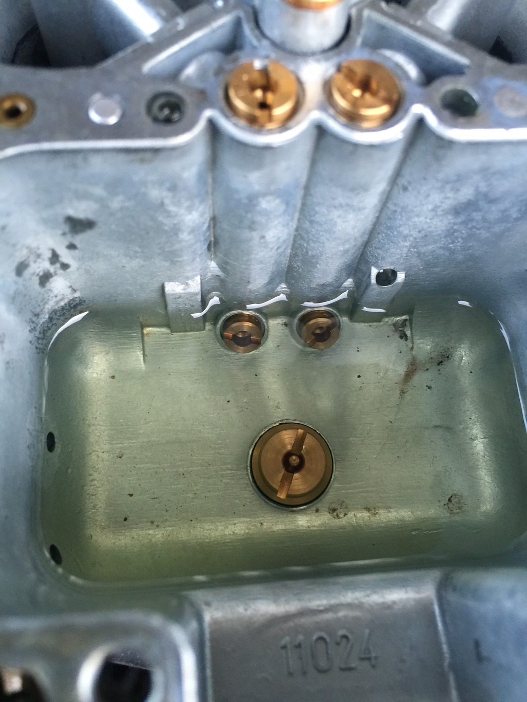

Ok float settings were way off. I bought a small caliper and used to it set the heights of 51/35mm. Here is bowl after top was removed.
Some gas in there, but what I noticed was when I removed the fuel line nothing drained out of the hose. So maybe the fuel drains back or something when the truck is off?
Mixture screw is at 1 and 1/4 right now. Sounds pretty good but take that for what it's worth lol.

Was this before or after adjusting? Anyone else know if this looks right? I'm readjusting now for the same problem.

ONCE I had to address this problem on someone else's truck. We installed a check valve in the fuel line between the tank & pump and it worked. Seems the tank had some mild vacuum to it, which was drawing the fuel from the line back to the tank, leaving the line between tank & pump empty. Still not sure why it was doing this. Toyota never installed a fuel line check valve stock.
Thanks, turns out my float level was too low, and that seems to have fixed it for now. I guess it drifted lower than it was. I removed my holley pressure regulator, onto which I had just installed a gauge. I thought maybe I got a fragment of teflon tape in it when I was doing that. Removing it seemed to help for one day and it was back to really long cranks first thing. I found out my float was adjusted to 51mm instead of 35, which was book level, but there's a vid of a guy who seems to have been in the business of Webers for a long time citing this book value and showing you not only to adjust to 35, but to limit the travel of the float to 2mm. Never explains why. I did that and I was back in business. Smelled a little richer at idle, but it's always smelled too rich at idle as a Weber. Anyway I put the regulator back on after that trying to remedy that richness but it's not excessive, it didn't change it but I tested it with ther long, hard accell uphill on a highway and it never starves for gas like before, so I know the float is good. I could retune for the idle jet again and see if it's different. During this time I also upjetted at frist the secondary idle and then the secondary main 9putting the secondary idle back as it was) and each of those jets in their separate tests have eliminated the mid to upper acelleration flat spot.
Now that's all done, I am back to like it was beforee on the cold starts, 2-3 quick consecutive attempts to easily start from dead cold in the morning. Once it achieves idle, it starts first crank until it sits for 10-12 hours or more. I might be able to get it to go in 2 attempts if I loosen the choke flaps back up a little. Maybe check valves would help it start quicker, I've been eyeing some $1.50 ones on ebay. There's got to be something to the amount of time it was taking just to get the float level high enough to start that was taking so long. So much cranking, so little fuel, my lines must be empty. I changed the fuel pump recently enough and even that filled the line without missing a beat in that moment with the engine having been run the same day. Theres got to be a thermal cycle with the whole truck temperature causing a vacuum like you described.
