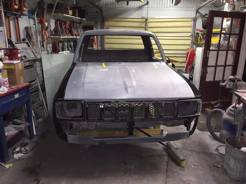

Can't really help you out with pictures since my truck currently looks a little like this:
But if you send or post some pictures of where you're at rigt now, I might be able to help you out.

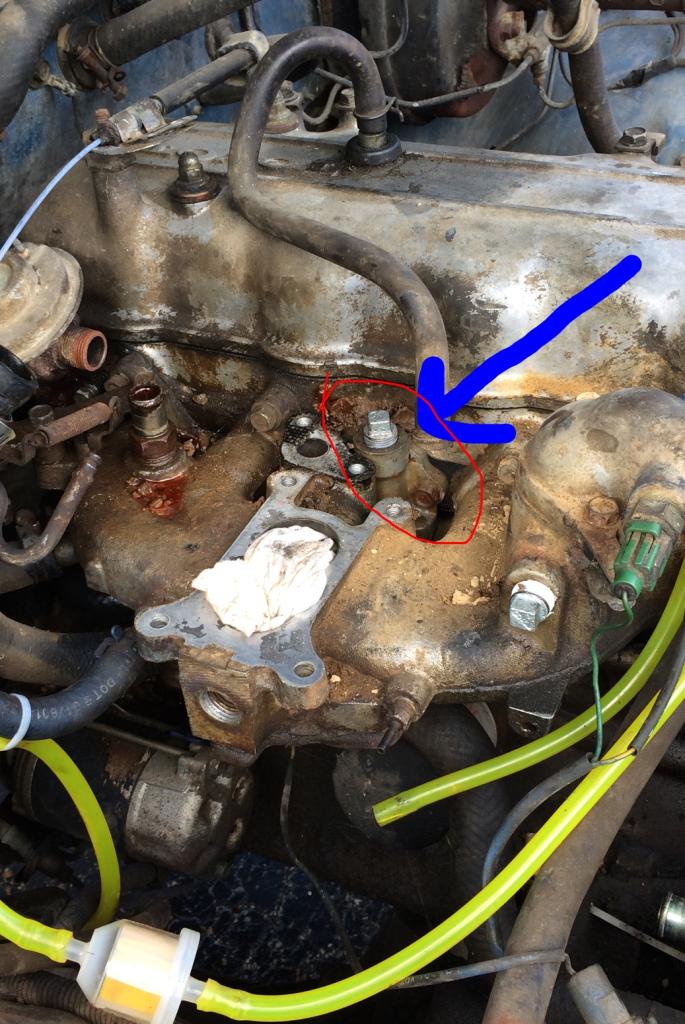

Actually, this might help...
I will use the barb on the bottom side of the intake manifold plate to feed the inlet of the heater control valve (which feeds the passenger side of the heater core):
If you don't have that barb, you could also use any coolant bung on the intake manifold
Then I will run the outlet (passenger side of the heater core to the hard coolant line down by the driver side engine mount - there is a barb off of it from the factory for the heater core return (pictured below behind the alternator):

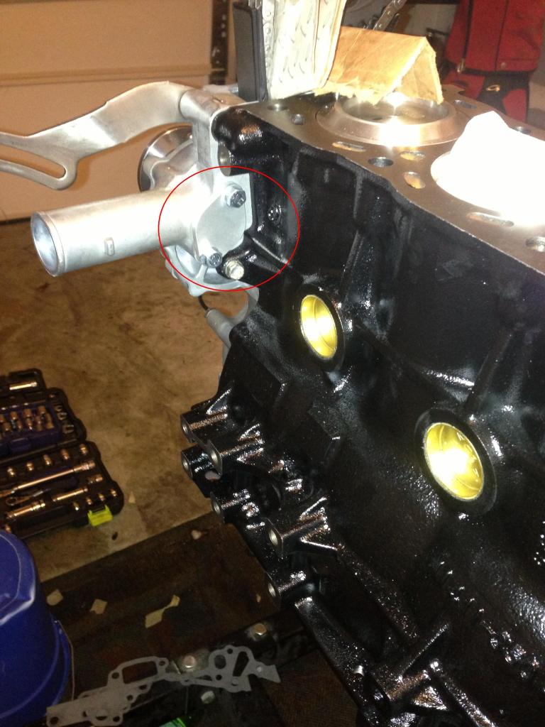

Or if you don't have the hard line (which I have discovered that some trucks don't) you can run it to the pipe that was on the back side of the timing cover on the driverside (circled in picture below):
Did that help?

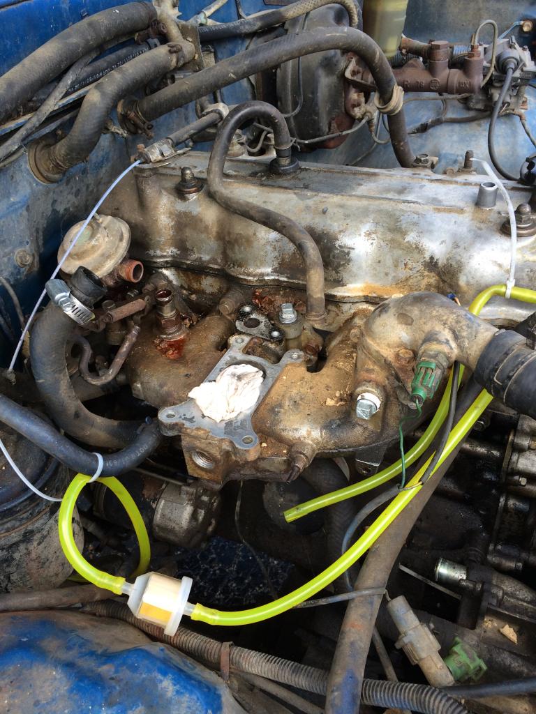

A quick picture

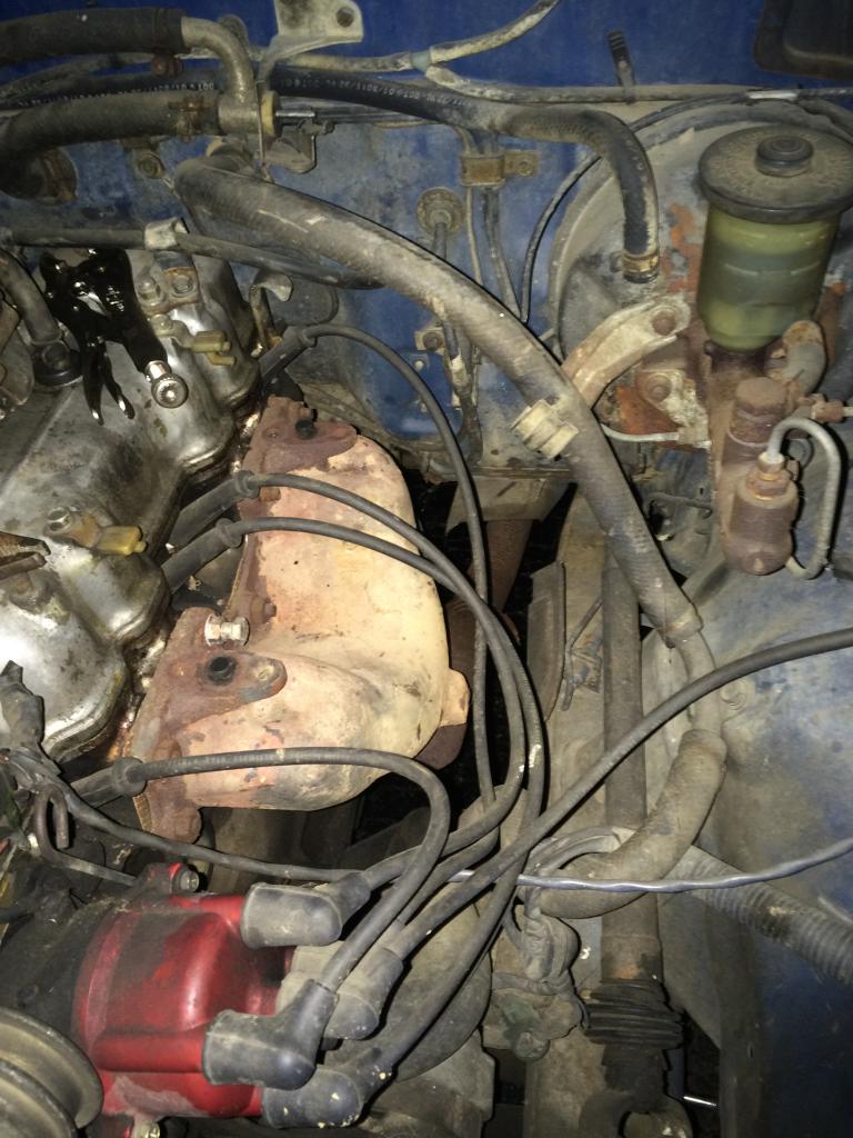

Size:  148.4 KB here is what I have done waiting on my weber. I have also plugged all the vacuum portals that are open in this pic. I am going to run the heater hose to the timing chain cover on the passenger side. Will I need to tie the other line in anywhere to run it to the driver side to allow flow? If that makes sense.

Where is the heater hose going to on the driver side? I would just leave it where it is.
Old Oct 4, 2014 | 05:30 AM
Yoda38052's Avatar
Joined: Sep 2014
Posts: 55
http://i42.photobucket.com/albums/e3...ps2uebawwm.jpg http://i42.photobucket.com/albums/e3...psndximdsv.jpg
So I can hook up the line to timing chain cover on passenger side and it should all flow like it should since it's already hooked up on the driver side correct??

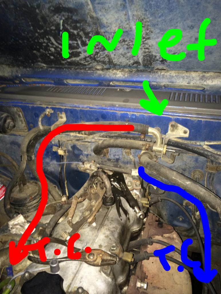

Old Oct 6, 2014 | 08:55 AM
Yoda38052's Avatar
Joined: Sep 2014
Posts: 55
I'm sorry bud I've just never done this before.. The T.C. Is timing chain cover in the picture. Is this correct flow? Again, I apologize for questions but I want to make sure I'm hooking it up correct. Name:  4F31D82F-3404-4ED8-A147-B9C6163A6960_zpscaf7pjh4.jpg

The bracket that the green arrow points to is the heater core valve I was talking about.

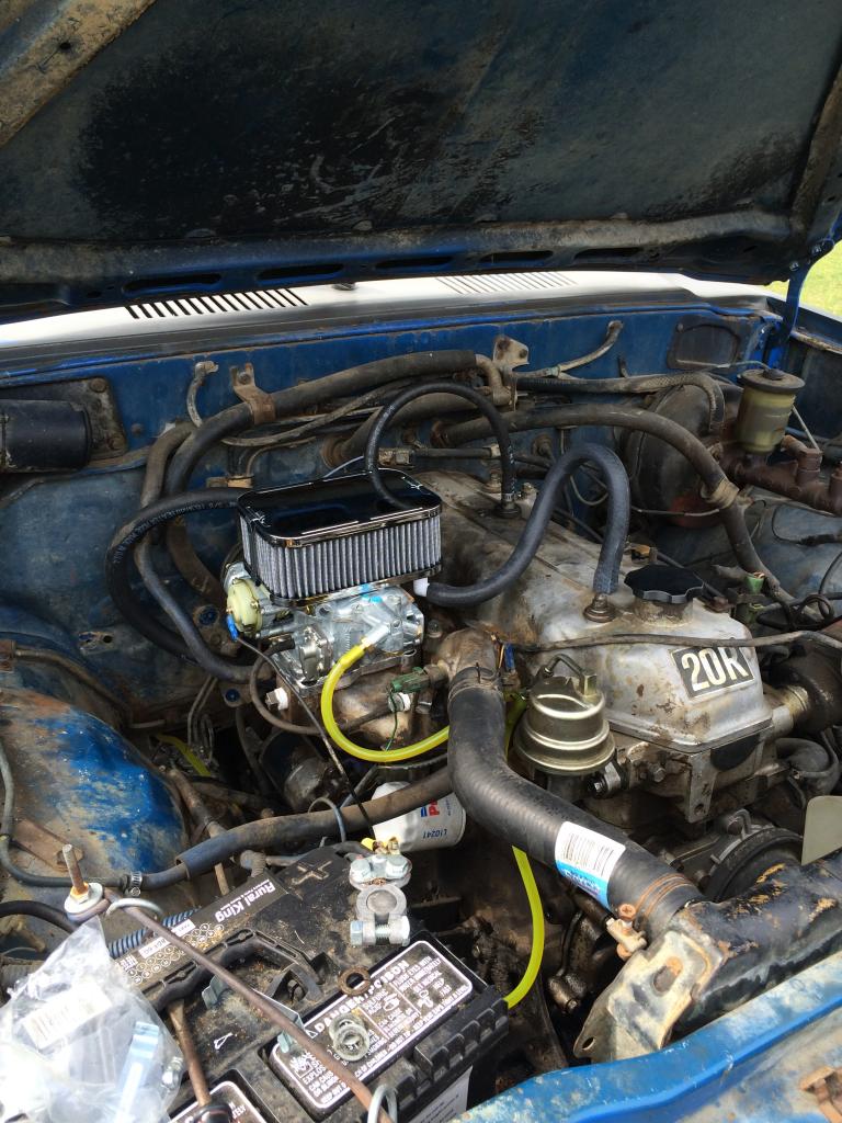

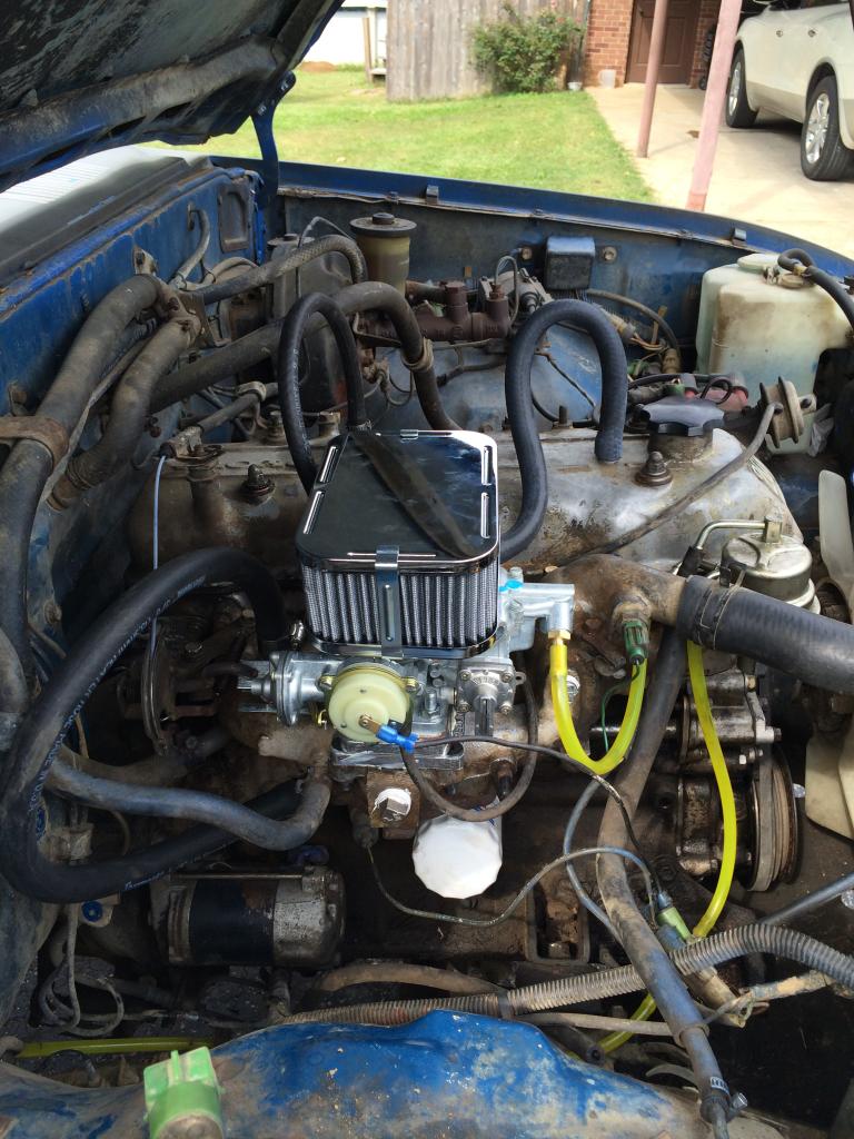

Well ladies and gentlemen.. I have my weber installed and here are some shots.. Thanks for all the info that was given to help me achieve this awesome result.. God Bless!!Name:  970F9D33-2021-40D0-82A1-B0D905559842_zpszx6ydvmw.jpg

Yota, That's exactly how mine is done. only difference is mines a manual choke. should have good heat too. remember heat only works correctly in defrost, and heat setting on dash. I'm glad it worked out!
M
