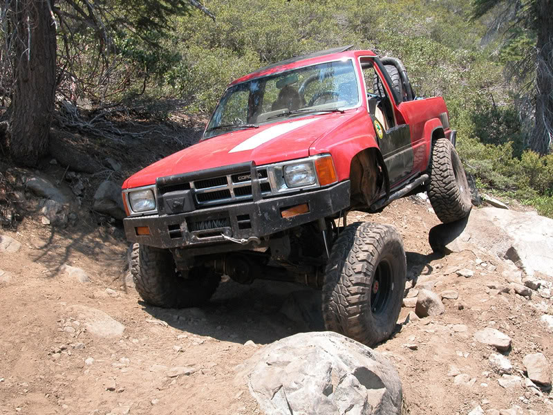

Hey I found some pics for ya.
Here is the specs:
'85 Yota std cab/short bed
22r
G5?
fwd shift w/ single twin stick
front:5.29 open, IFS hub swap, kong's Hi-steer
rear: 5.29 Detroit in IFS rear, Disk brakes
Stock Wagoneer spring w/shortest leaf removed
63" Chevies w/overload removed
35"x15r BFG Mud on Alum rims
re-enforced front crossmember, Fror Ifs box brace, ford shock towers(braced), rear shocks thru bed.
Sliders and rear Tube work rollover protection
acura seats, half doors, multi mount winch, custom rear bumper, Lo profile trans crossmember, power IFS steering...
plans to convert to pane and finish tube bed.

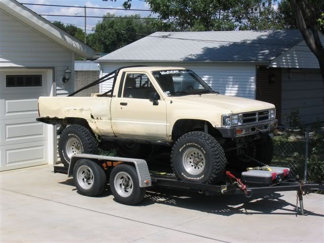

Truck Model/Year:Toyota 4Runner, 1985
Engine: DOA Built 22RE
Tranny:W56
Transfer Case(s)ual 21 spline Toyota cases (2.28/4.7), Marlin Crawler adapter and 4.7 gears
Front Axle & Gear:Stock 85, V6 brakes, LC rotors, Open with 5.29s
Rear Axle & Gear:87 IFS housing, Welded 5.29s
Front Springs:Wagoneer springs, 6" shackle, 2" drop box 1.5" forward
Rear Springs:63 Chevy springs, dual shackle
Tires & Rims15x10 black steel, 35x12.50 Goodyear MTRs
Frame Mods:Fully plated in the front
Body Mods:Trimmed fenders
Other Mods:Custom front bumper, Warn Winch, Marlin rear bumper, Marlin sliders, homemade front square shaft, Budbuilt xmember, Marlin high steer, other stuff
