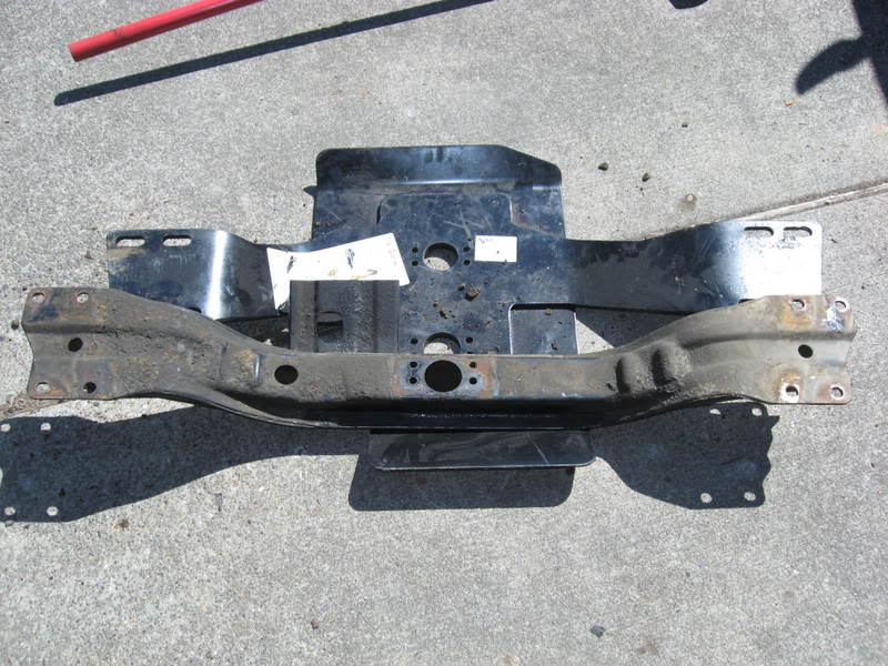

1st gen truck crossmembers mount to the outside of the frame, 2nd gen crossmembers mount to the inside of the frame.
I found this out when I bought a budbuilt crossmember off of ebay (listed for 79-83) for $31 but turned out to be for 84-95
stock crossmember is shown on for

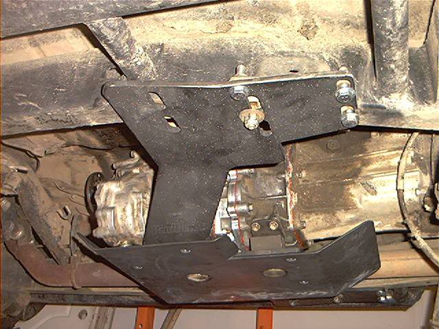

Budbuilt has done some of these that allow for a either an L series or W-56 in a 1st gen truck...

I looked to see pictures of stock crossmembers modified (cut and welded) with some plate as an extension for use with a W56, no luck...ibut I know that they are out there.
