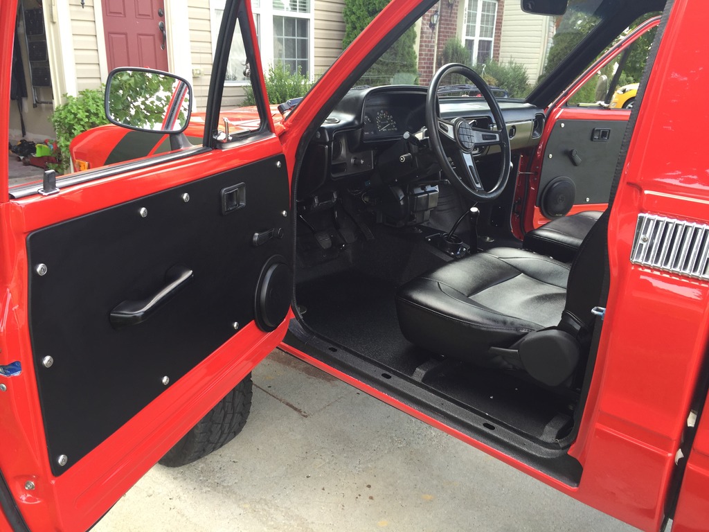

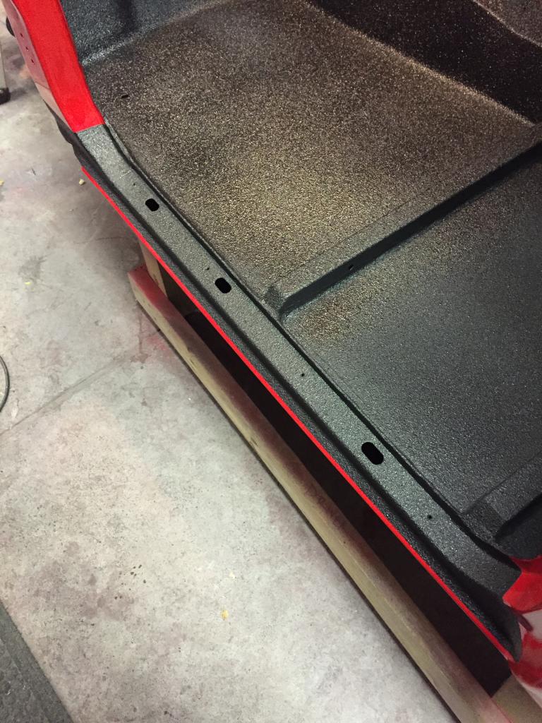

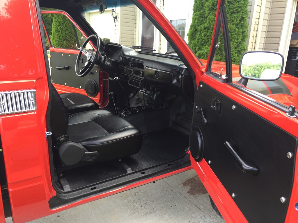

FYI, vinyl flooring breeds rust - water gets easily trapped under the vinyl and can cause extensive damage. If you want to waterproof your floors for easy cleaning, I would recommend coating the floors with bed line. If you take out all of the interior (seats, seat belts, shifter boots, console, etc) a place like Line-X would do it for around $200. Or you can do what I did and do it yourself with Raptor Liner for about $115. Raptor isn't a thick as Line-X but it has done the job for me so far and looks good:

Kawazx636; Thank you for the info, wish I have seen it before. I already applied fatmat on the floor. Hopefully it will prevent water touching the metal, or the worst is that the water gets trapped underneath it.
