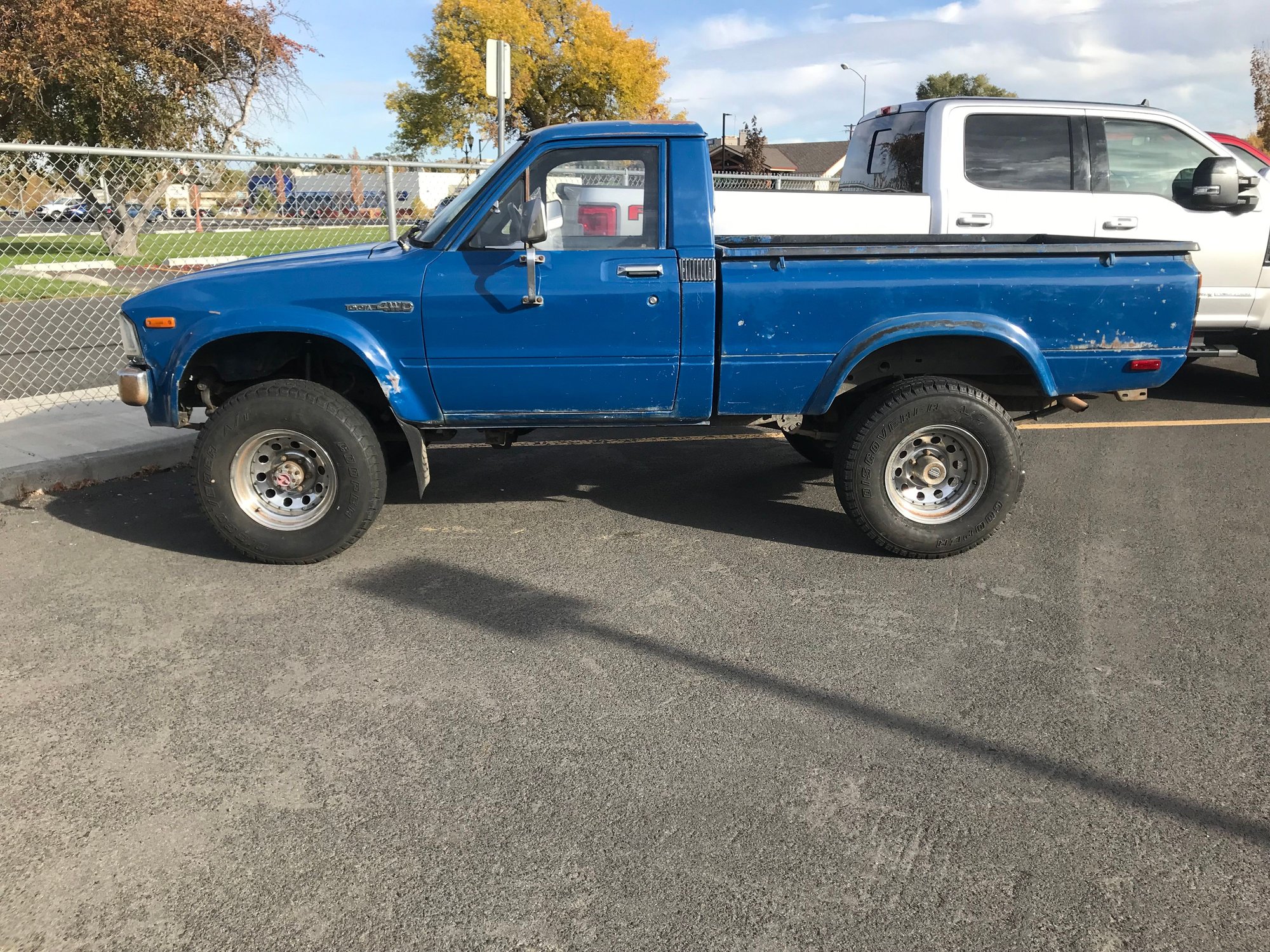

Hi,
Recently picked up this '82 with the intention of restoring it. I had one over 30 years ago and have kicked myself everyday since for getting rid of it. Anyway it had the stock skinny pizza cutter wheels on it when I got it but a buddy gave me these wheels and tires from his '82 Chevy pickup. The tires are 31's and it looks like there is still quite a bit of clearance.
Has this truck been lifted and what can I look for to give me the answer?
Thanks!

I would have to say yes. It's not much, maybe just an add a leaf kit, or some aftermarket springs. I would guess no more than 1 to 2 inches, or 3 inches at most.

id say its just the right height. how much you selling it for?
jk, but thats a good looking truck. keep us updated

A quick way to determine any lift is with the steering straight ahead the Pittman arm should be more or less vertical.
Add a leaf "kits" from that era were basically made for one thing...lift it cheaply so you could put bigger tires on. Coupled with old school hydraulic shocks rendered the suspension virtually in-operable.
As for shocks, stop peeing away money and get Bilstein's. I've had KYB's, they were O/K, definitely an OEM upgrade. I've had Rancho 5000's, on a full size truck towing a camper they may be good but on a light truck, well they are definitely old school. On my truck there is about a 1" add a leaf to level it done by a spring shop and it rides so nice now with the Bilstein's the wife will actually ride in it...not so with the Ranchos.
If you want the rear to ride smoother the trick of the day was to remove the helper springs but at the cost of spring wrap and axle hop during hard acceleration. Thus every monkey and his brother offered some kind of trac-bar, traction shock etc.
