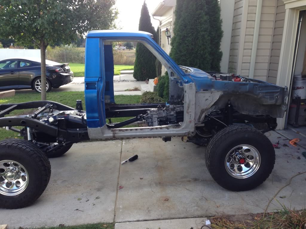

This is all I have right now that shows the heigh. I still have the cab off doing body work.
If I recall correctly, it is about 26" from the ground to the bottom of the frame.
