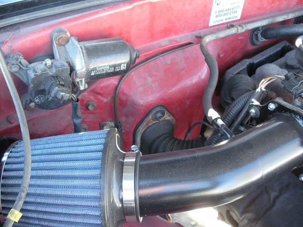

here is the shot of my engine bay with the 2.7 in a 93. the harness has a flange with gasket that i reused. i welded a plate on the inside with nuts so i could bolt in right in from the engine bay. it's a little funny, i have a black truck with a red engine bay and you decided red wasn't quite the color you had in mind either. i have more pics in my user profile. i don't want to post anymore in your build thread to confuse people. so take a look, thanks.
