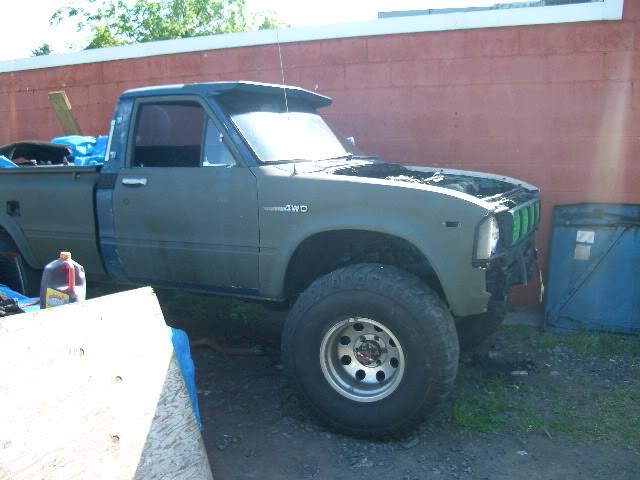

How do 33's not rub ith stock suspension? I'm running 35's with a 3" spring lift and get the tires rubbing on the rear of the wheelwell at full flex/turn, 33's were close but never hit.
truck2011.jpg?t=1197294929

mine is stock and it in no way sits that high i have about 3 to 4" clearance in the wheel well with 30 / 9.5. a 33 might physciall fit but it would rub like hell in turns or twisted. and a 35 ain't gonna go!
yours doesn't look even close to stock ride height. but back to the subject
3" for 33? 5" for 35? or 7" for 35?

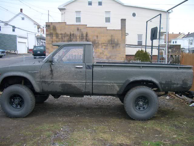

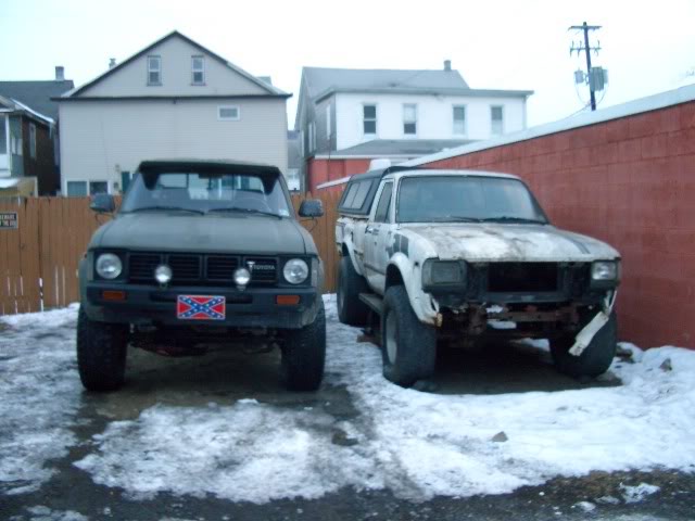

my truck is at stock height! i had 33s on a parts truck and 32s on my 79 and the sat equal!!!
1982 BONE STOCK! with 33s

the white 82 has 33x12.50s and my 79 has 32x11.50s the 82 is in a bit of a hole in my backyard to, but both sit at the same height
i even bought stock shocks with not problems for my 79!
y is it so hard to believe that a stock first gen can clear and run 31s,32s,and 33s, and clear 35s?

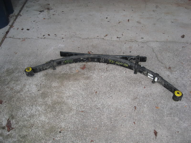

Nothing against NWOR but from what I understand their springs are stiff as hell....I have got a set that my brother in law gave me. Later I find out he only ran them for a week because he has zero flex in the back..I was going to use them to get rid of some rear blocks in my truck but am going to wait until I have the $$ to do it right with a Trail Gear rear kit..more money but the springs will function better for what I want to do with my truck.

Don't get me wrong, there are ton of folks out there that have gone with Downey or NWOR. Just my sister told me the story of the fight she and her husband had over the 'waste of money' on the springs when my bro in law said they did not work for what he wanted and ended up pulling them after a hunting trip a week later....Good luck with whatever route you go...
