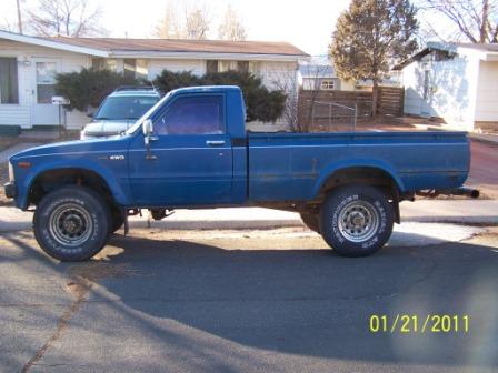

I've done some searching, but couldn't find any suggestions/answers. I've got an '81 4x4 long bed & I'm looking for some new shocks. I don't know what shocks are on it now (covered with rust) but it rides like my 3/4 ton work truck. If this is normal for a SFA, then I'll have to get used to it. I'm looking for a more comfortable ride at an affordable price ($250 or less). Here's a pic of my ride, it's on 31x10.5 LT & new tires will more than likely be 235/75/15 (budget). Thanks for any help.
