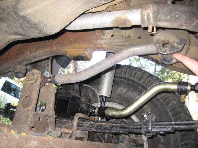

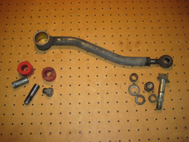

Old Jan 10, 2016 | 08:30 PM
BlazeN8's Avatar
Posts: 977
From: Southern California
The Torque Arm is what your discussing!
The one in my photos is an adjustable one that came on my 1985. I believe it may be a Pro-Comp unit? I've been meaning to find new poly bushings as these are shot and re-installing it but I keep on forgetting to get to it.
Without the Torque Arm the axle will rotate when braking and will cause the truck to pull to the side under heavy braking. Very sketchy!

Yeah, pain in the bleep for me too, I can't find the right size poly bushings. I think it may have been a Downey product? Guess that is why I keep putting it off. That and I want to go Hi-Steer eventually. Like you said, I too was annoyed with the RH threads on both ends so it can't be adjusted unless you remove one side. Yotamaster Eric warned me about the pull upon breaking resulting from no Torque Arm. For the proportioning valve at the rear just space it up from the axle housing attachment with a section of flat stock 1"x3/16" and properly located holes. Space it up equal to the amount of lift you installed to the rear. This is a super common bracket from anyone who offers a rear lift if you don't want to make your own.
