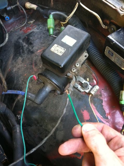

anyone know what this is?

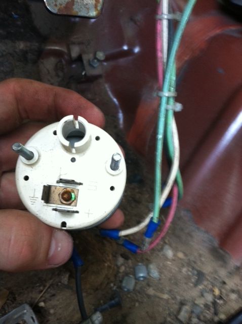

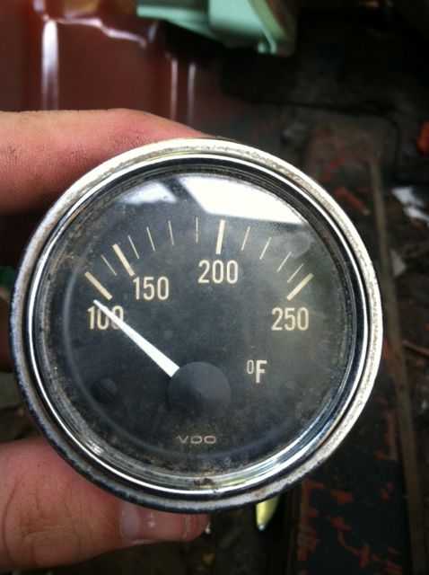

cant get this damn temperature gauge to work

only response i can get is the needle maxing out when i connect the wire from the fusebox to the +
You hook +12V to the +, Ground to ground. Now on the sensor that measures the water temp what connections does it have? More than likely it will have a +12V and then a signal out and possibly a ground. The signal out goes to the S on your gauge. Is this what you had wired up? Next thing is to check what the range of the sensor is against the range of the gauge.
you talking about the thing that has a spark plug looking wire coming off of it?
its your coil. it sends spark to the distributor.

nah i meant the loose wire in my hand its pretty long to just be a ground, I dont know where it goes...
i dont know about the gauge ive tried all combinations of those wires in the background which are the ones i pulled it off of when the wiring harness was in the previous cab. something is probly unplugged somewhere in the middle i guess... thanks for the responses

Looks like a wire that goes to an Rpm gauge.

you are the man
oh hahaha. my bad. i thought you were using the wire to point to the coil.
"this guy is doing a cab swap but doesnt know what a coil is?" <---this crossed my mind and i almost didnt respond because it didnt make sense

havent been workin on the truck much but still having trouble with the temperature gauge. I put a volt reader on the pink wire that goes to the fusebox and its geting 12 volts. but when i connect it the temperature just goes all the way to max as soon as power is applied. im thinkin the sender might be messed up but it was functioning fine even after the roll.

finally swaped the e brake cable out with the one from my old cab... temp gauge is now working... the truck was overheating so i bought a new thermostat, when that didnt work i went ahead and replaced the gauge, water pump,sending unit and fan clutch. turns out they sold me a bad thermostat... anyway the thing runs but the transmission is squeeking with the clutch engaged, feels like the clutch also isnt fully engaging. sometimes it is hard to get into gear. My next project will be replacing the transmission with a 5 speed. I currently have a L43 side shifter POS that doesnt fill out my now 1982 cab.
It is a green wire.
Presumably, the other end of it is the one connected to the coil. Ditto on the potential for tach signal wire.

so the truck wasnt actually overheating. Turns out the sending unit i had wasn't compatible with the gauge. its strange though because it would just slowly rise in temperature normally as it was heating up then just continue past 200. but if i drove it on the freeway i could keep it under. The whole time i was just getting a false reading...
