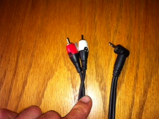

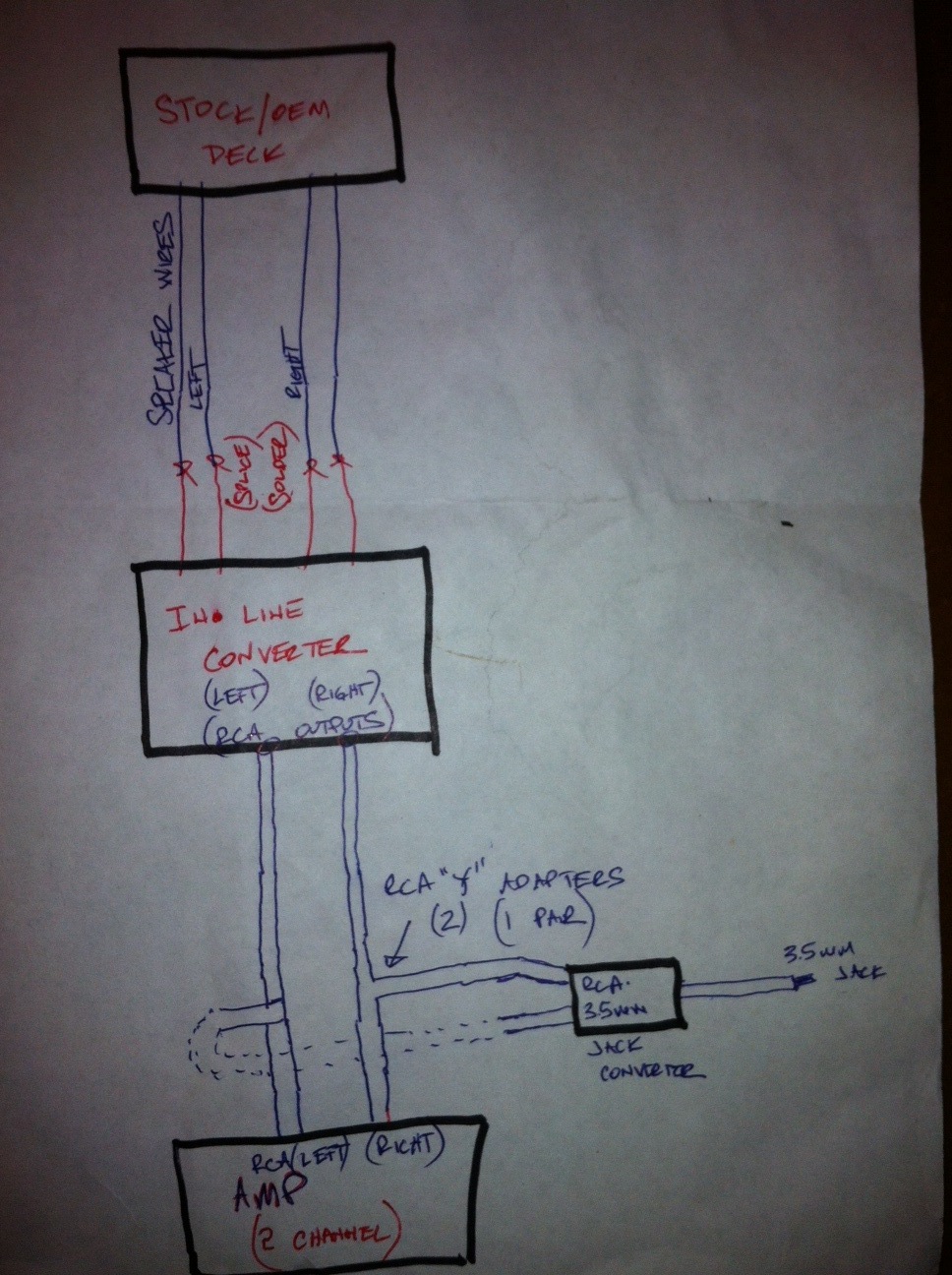

Here's a quick schematic of how the line-converter/ Ipod 3.5mm Jack setup is supposed look. Remember left/right RCAs and pos/neg speaker wires need to be separated. Essentially you can use your stock radio when there isn't any "signal" coming from the 3.5mm jack. When using the 3.5mm jack turn off the radio so you won't have dual signals going thru the speakers. Make sure the 3.5mm jack isn't laying against anything metal or you'll get some serious road noise (whine). With that said ground every component thoroughly.
All this stuff is easily available at radio shack. I ran the jack thru the bottom of the center console, so I can stow it away when it's not needed.
I hope this helps, we need more original 1st Gens 4x4s, good luck.

Excellent! Thanks. Yea this will help.
Only thing I'd have to change is alter this for an Android device.

Hey thanks for the good info. I do have a question though; if you have to use it with
The radio off, then the amp will need to be on. Most amps have the blue (remote)
Wire that hook up to the radio to power it up when the radio is turned on. How
did you bypass this? Thanks

Go to the steering column and splice into an ignition lead. I think there is a yellow wire I used for the amp.
