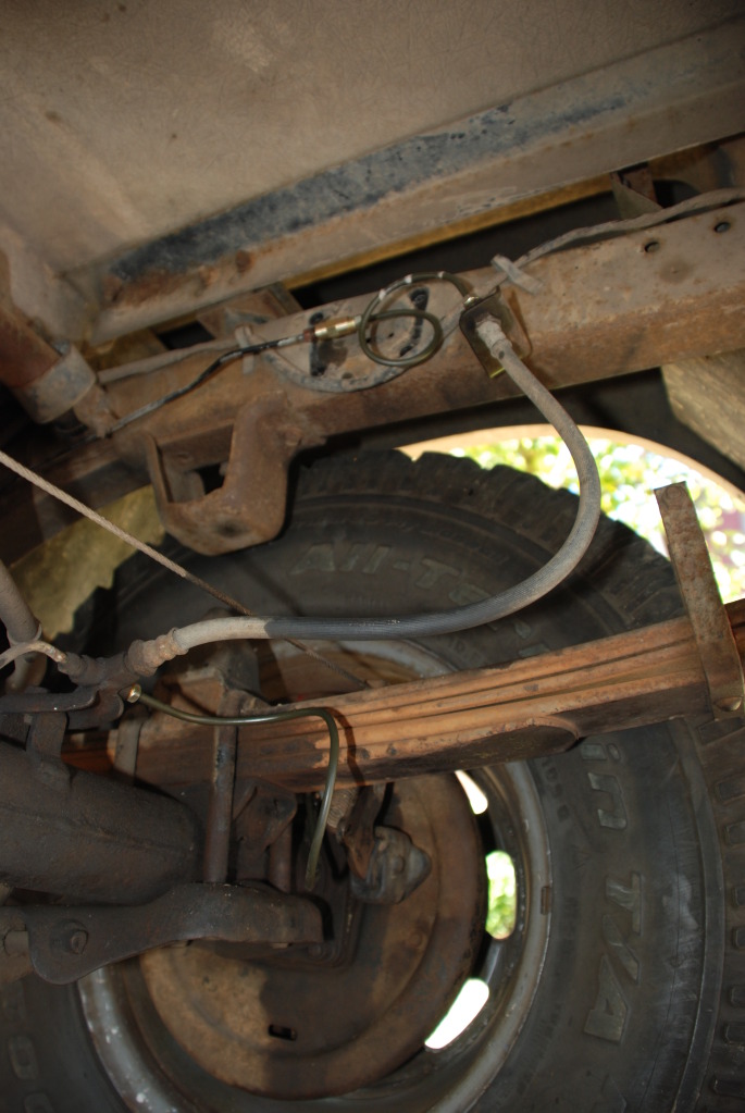

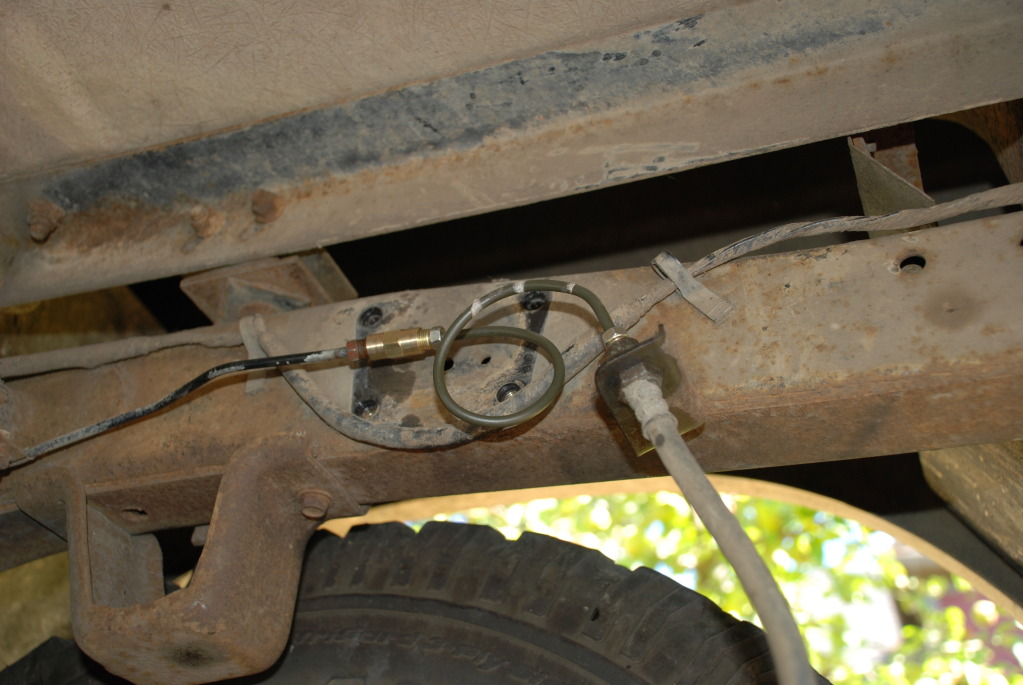

I finally got the wheel cylinders replaced, and the one brake line I broke as well. The other ones came loose no problem, so I left them in their place for now. They will be replaced in a few months when I do the disc swap anyway.
Bled the brakes, and now they are definitely better, and I can actually lock them up now, however the pedal still travels to the floor and the rears are barely getting any pressure.
So this morning I just eliminated the LSPV.
Now just waiting for a buddy to come over to bleed the brakes and see if that was the culprit. If not, it can only be the booster or MC.
...Right?
