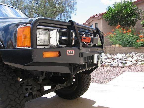

Unfortunately the '84-'85 ARB bumper will just not work for my purposes. If you look closely at the driver's side fender below ('83 with an '83 ARB), the front fender of the truck goes behind and below the ARB bumper, and ties into the front valence directly below the headlight.
On the '84, the front fender stops where the ARB bumper begins. Even if you could get the '84 ARB bumper to mount to the truck frame, you would have to cut the front fenders to do it. That's not an option for me because I'm trying to do a resto-mod and keep it relatively stock looking.
The '83 ARB bumper is a really unique design in that it follows the lines of the truck, and still incorporates the lower front valence. It's a shame the quit making them.

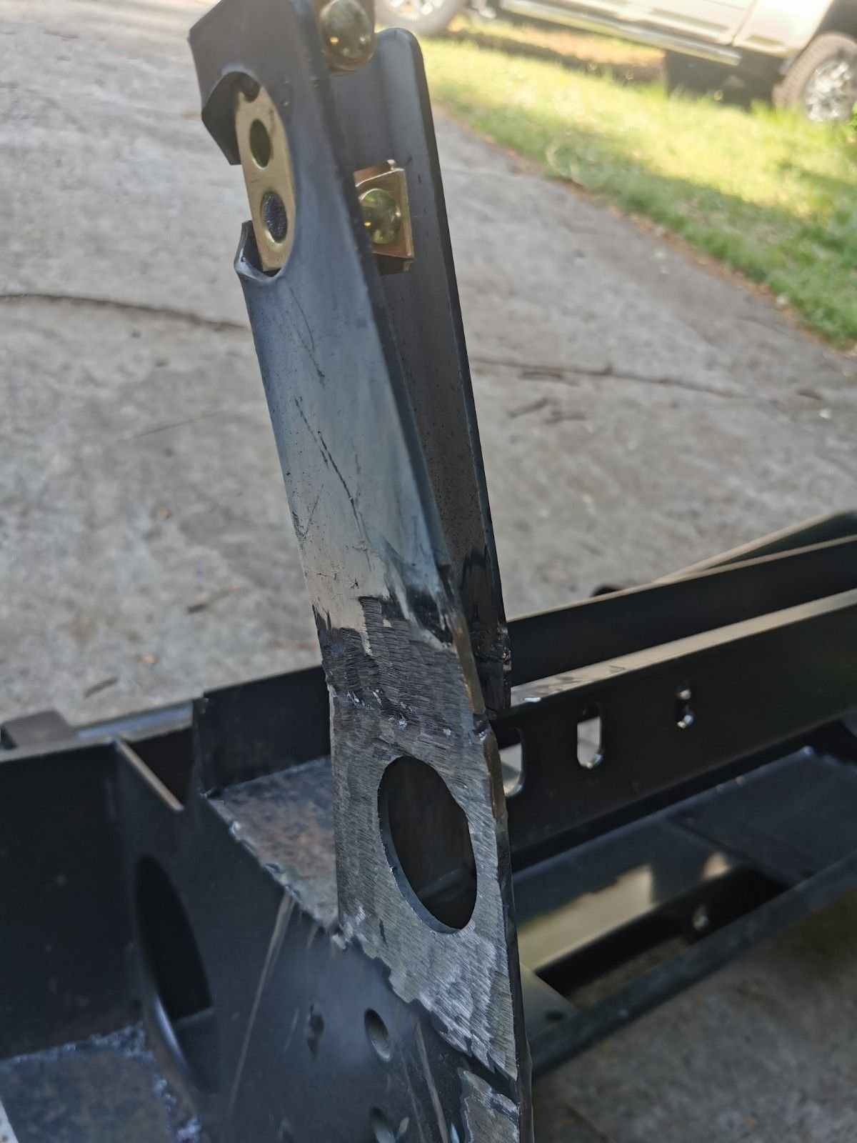

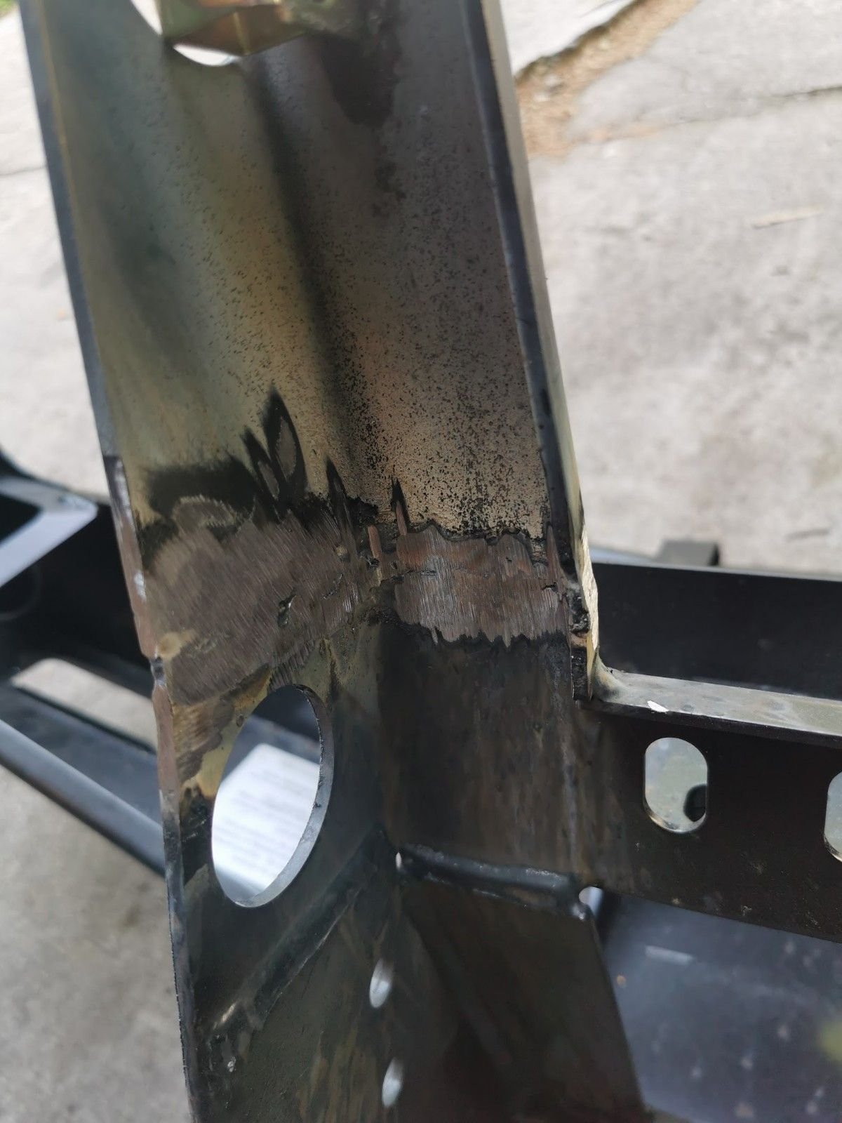

It does not, the frame its slightly narrower between the leaf spring mounts than the ARB bumper. Then the frame widens a bit and the ARB is narrower. I was able to notch the ARB bumper to have it follow the frame better and with a litte "gentle persuasion" and an engine hoist, I was able to get it in place. Re weld to close the notch and it was good to go!
As they said, It was a goood bit of midification to get it to wwork as the stock bumper mounts were in the way as well. The bolts holding the bumper to the frame lined up right where the bumper brackets bolted to the frame. I chose to drill out the threaded portion to limit the changes in case I ever went back

I went on ARBUSA and sorted it by 79-85 toyota pickup. Says its a direct fit but, its not. I had to widen it by about 2 inches just past the leaf spring mounts and "persuade" it to be narrower at the mounts.

Pardon the less than ideal welds, I never took more photos after I fixed the feed speed and amperage
