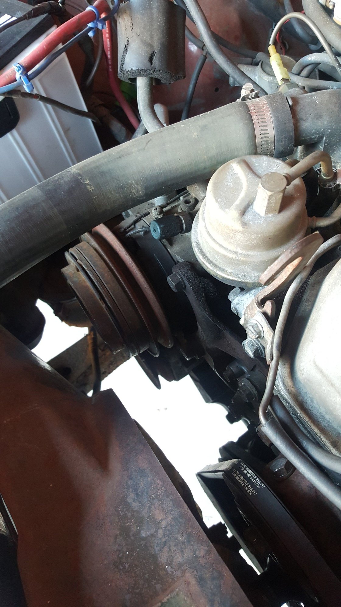

Once i got my truck home I did some more inspecting and noticed that maybe I am missing a belt on the air pump? All the tech diagrams I look at in the FSM didn't really show that belt diagram, but upon searching and looking at other peoples engine bays it looks like that maybe broke when I was driving and the engine stopped?

What you are looking at in the picture is the air conditioning compressor.
Judging by the apparent lack of shine, or polish, on the compressor sheave, there has been no belt on that pulley for a long time.
The existance of, or lack of, an AC compressor belt likely has nothing to do with whatever caused your truck to quit.

also smog pump would be under your ac compressor, unless that is a idle pulley for ac, I can see it under AC in pict..
