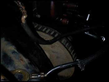

the way i see it is there is the 3 wire plug and the 1 white wire. i got the one white wire and the one black i guess the black is just a ground. and yes i know i got to put another end on the white wire
