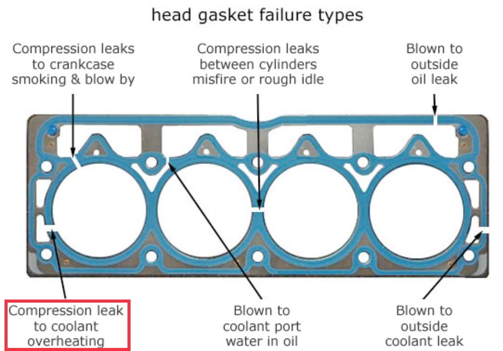

Are you getting bubbles in the radiator? Or excessive overflow into the recovery tank? Does the thermostat open as it heats up? Do you get good, hot, water in the radiator?
Oil in the water, or vice-versa? Do you have the "chocolate milkshake" on the inside of the oil filler cap? Oil in the radiator or recovery tank?
Does one of the cylinders have low compression? You can easily borrow a compression tester from an auto parts store to check.
Have you used an infrared thermometer, the "point-n-shoot" kind to verify that you are, indeed, overheating, and don't have a bad gauge, or sender?
Could the radiator be clogged up inside? Not getting good flow through it? Is the lower hose getting good n warm? If not, bad radiator.
Worst case scenario, the head gasket isn't really all that hard to replace, even for a shade-tree mechanic like me. I know, I've done it, and a mechanic I am most certainly NOT.
