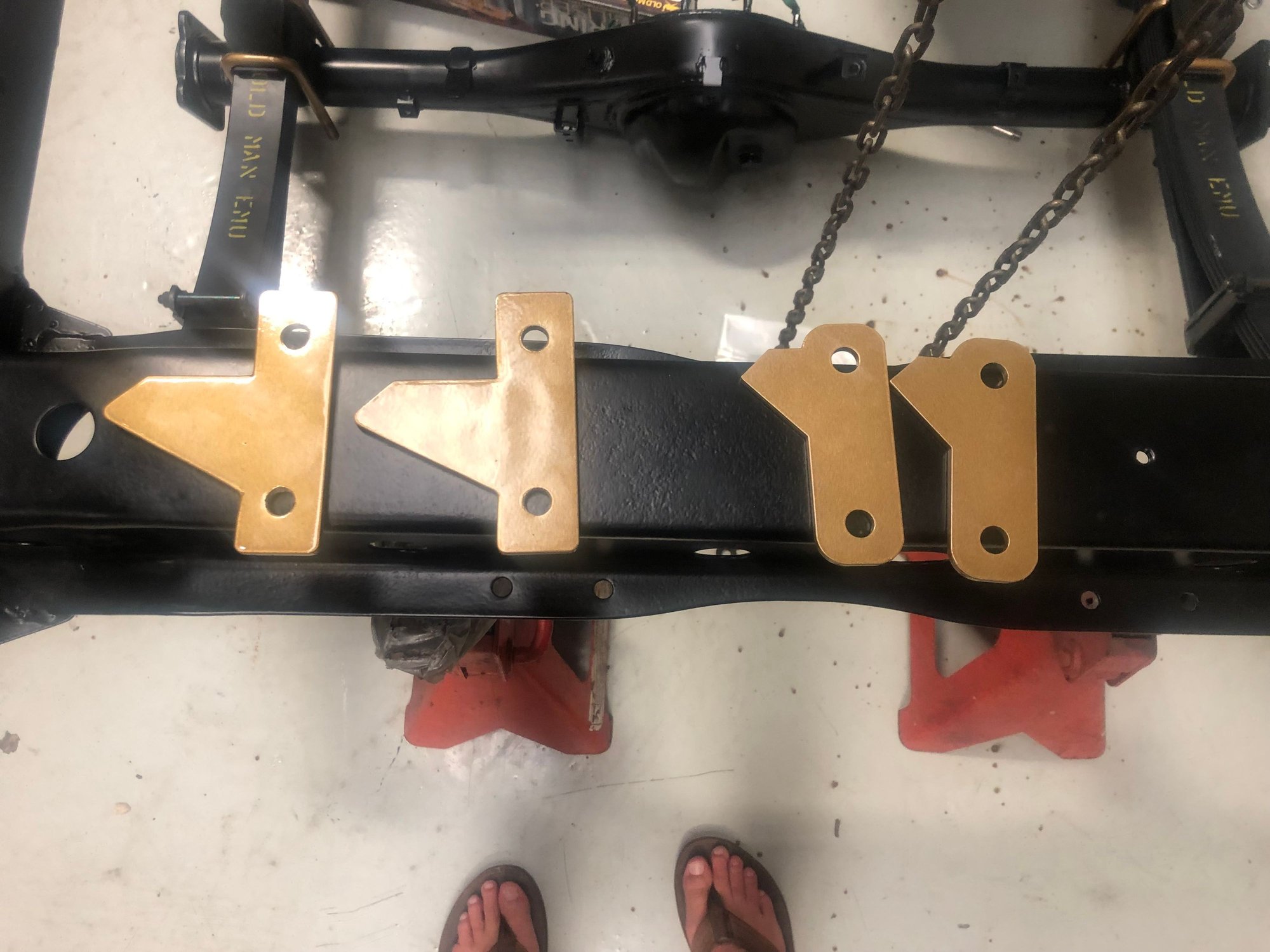

Looking for some help, I have been searching everywhere for this info, the company that I got it from can't steer me in the right direction.... I got a 2in old man emu lift for my '83 shortbed 4x4 truck. It didn't come with any instructions, so I have been trying to figure out in what orientation to install these anti-inversion plates for the rear leaf springs. I found a website that had some really good info on the installation. Since my truck is completely disassembled I just welded them up according to his directions. According to that website he says that the larger plates go in board, and the smaller ones go outside, but do the bumps go forward?? and also the way that I have them laid out is that the true top side, or do I have them inverted?? Thanks for your help!

My bet is, the bumps go toward the rear, but l don’t have a guess on your second question. 😔

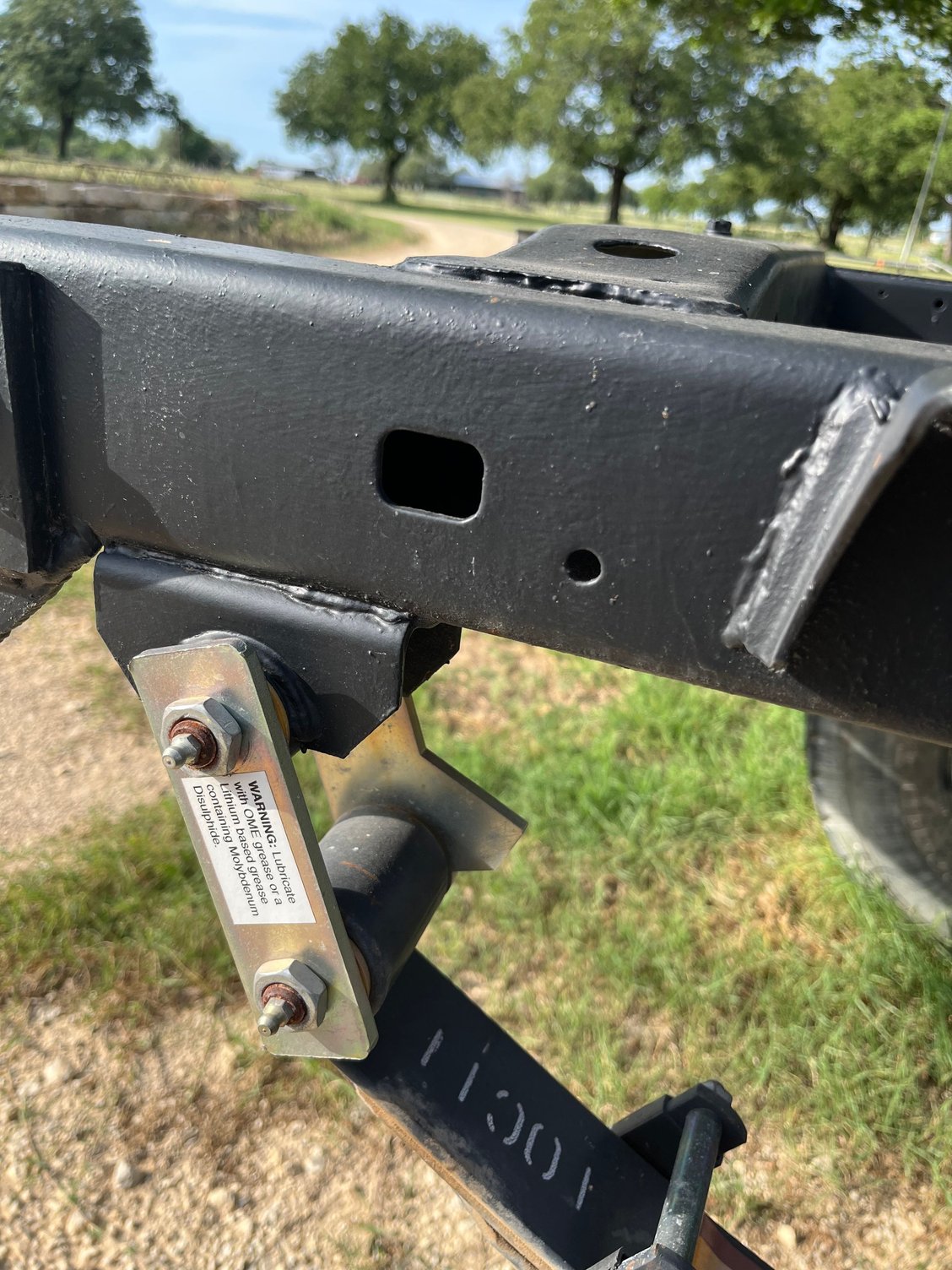

I can’t remember who I bought mine from, but was told to install like this on my 81
