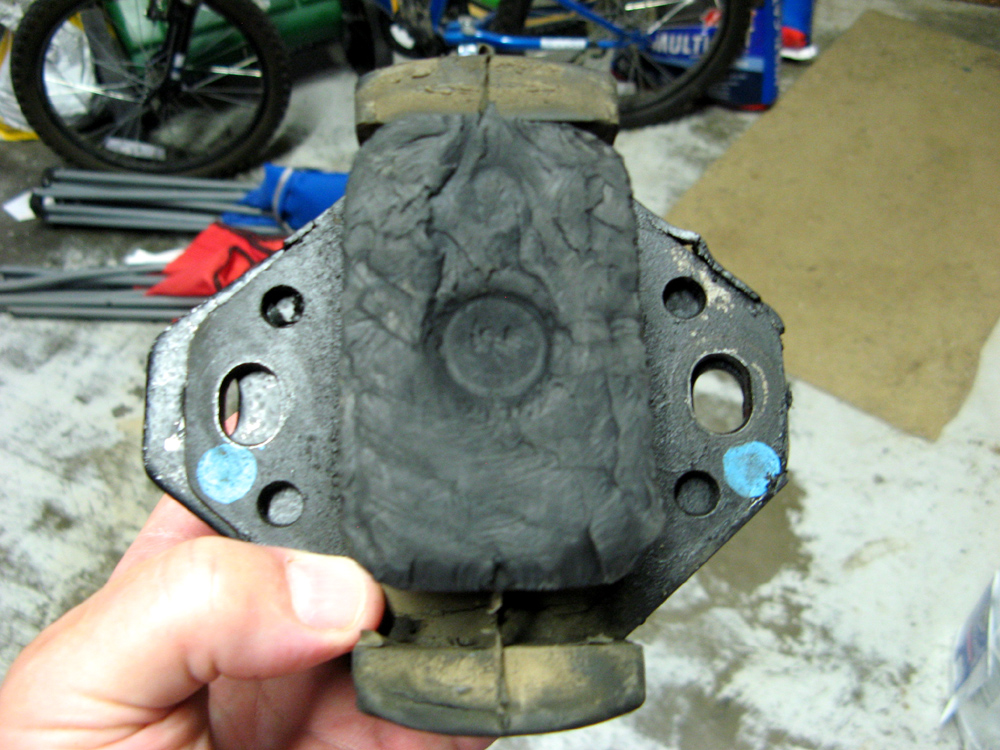

@#!o#!@
EDIT!
ROCK auto (did NOT) send me the WRONG mounts. CORRECTION, ROCK AUTO sent me EXACTLY what I ordered. Great price, wrong mounts though. IN FACT, ROCK AUTO IS REFUNDING MY ENTIRE ORDER PRICE, INCLUDING SHIPPING. I will pay for return shipping (they split the shipping with me...NICE FOLKS).
My '83 SR5 seems to be an unusual assembly line orphan. Anchor #8162 SHOULD fit! MORE later today when I see if the '79 mounts fit.
Anchor part #8162 mounts are the same ones O'Reilly auto shows a perfect fit, so I do not blame Rock Auto. But this means I have to match the mounts locally, now that I have the failed mount in a bag! And more delay. The subject/title of this post expresses my fuming situation- Yeah That...
Advance Auto near my house showed the same Anchor part! But, has a local store with another possible alternative we think might fit. I won't pay $70 x 2 for Beck Arnley (NO!). He'll have it at the store in the morning. $40 down the drain. I'll get $30 of it back eventually, but I have to pay shipping back to Rock, I am sure!@#!@! Not my week.
Oh, and the alternative parts start at over $30 apiece. I'll stop now.

My mounts from 4x werent exact but they weren't off that much. The bolt would still go through definitely. Sad to hear about your luck man. Low range off road carries stock mounts and their bomb proof ones. You could check them out.

Those bomb proof mounts at low range look excellent, but I need these today! I have Duralast (Autozone) and Beck/Arnley (Advance) part numbers to check local stores today, and match side by side if available. I am getting desperate, with jobs backing up! The motor needs to be bolted in again... tonight!
