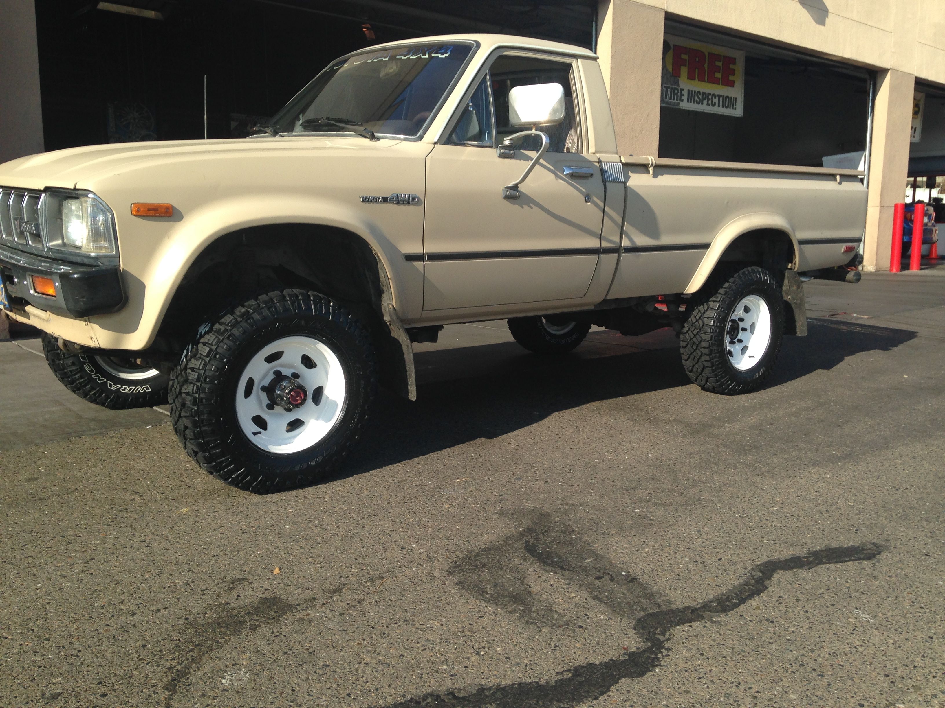

Hi All,
New to this Forum but a long time IH8MUD member. I'm the proud owner of new to me, 1982 SR5 4x4 LB with only 106,000 miles. It is bone stock and as I have a built for crawling 1973 FJ40, and a 1987 BJ70 I am keeping this beauty stock. I'm freshening up all the parts, knuckles, bushings, tie rod ends, stock wheels, etc. I've adjusted the Power Steering box as much as possible without binding and still have too much play for my anal Type A personality. Any suggestions on good sources for a rebuilt OEM push/pull Steering Box?

That's one clean truck. I'd use the chance to upgrade to crossover steering over push pull.

According to many folks in the know I'd need to lift the suspension in order to make room for cross over (high steer) conversion. I want to keep this truck stock. Thanks for the thought.

Yeah, you'd need lift so cross over is a no go. Nice looking truck, I think keeping it stock is the way to go as well. I don't know where to source a good steering box but I bet if you posted up on the want add section on here there's a lot of guys on here who have converted to cross over and have a push-pull box just taking up space in their garage. You could likely get one that was in good condition for really cheap. Just a thought.

Back to the original topic. Anyone have a good or bad experience with any Rebuilt Power Steering (push/pull) boxes out there ?

I use one on my trekker show truck .. all my steering components are new or rebuilt "stock" type steering , with addition to the drop drag link .
it's ok with the 35's and don't have any problems what so ever

I don't recall where I got it from ... but here is the # 04445-35011 for the kit

Are you sure there isn't slop elsewhere? Check your steering column U-joints. I was also chasing a slop issue, and all it took was a proverbial lightbulb, a pair of vicegrips (to hold the steerbox input shaft), and a little wiggling to locate the problem.
Glad to see someone keeping it stock! You know, there may be a way to do crossover steering without a lift. I'm semi-actively researching this myself. It will almost certainly require a bent tierod to clear the oilpan, which likely means sourcing it from a heavier vehicle (I would not trust a tierod I heated and bent myself). It'll also need a custom passenger-side steering arm because you're not doing high-steer (above the leaf springs) and I don't believe anyone produces low-steer arms.

Moroza, good suggestion on securing steering input with a vise grip. I'll try that tomorrow. Honestly I'll be happy with push/pull as long as tire's remain small (235's). My Rubicon rig is my FJ40 and that has all the goodies! However, back in the 80's my stock '81 LB PU did the Con with 30" tires. The trail is a whole different animal now.
