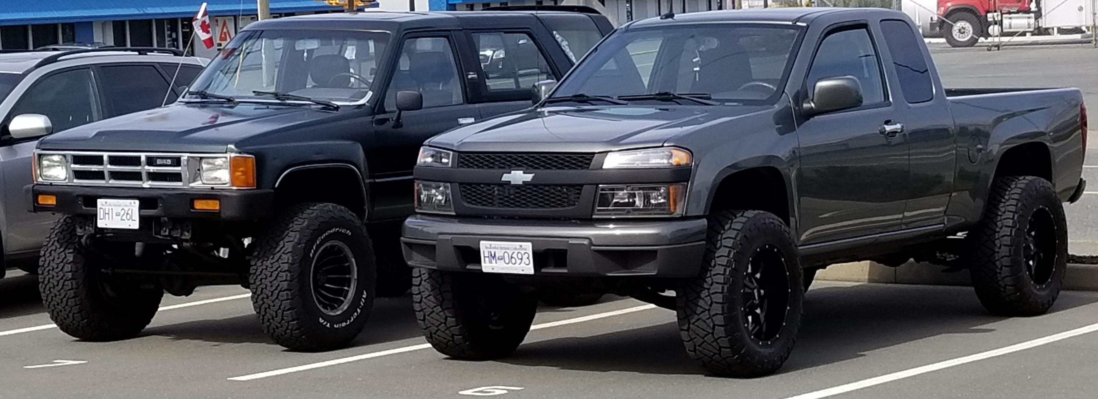

Heres my co-workers Colorado sitting next to my 4runner, it’s 5 speed, sitting on 33s and has great gearing. Will it be around in 30+ years, don’t know but he’s a mechanic, ya never know.
