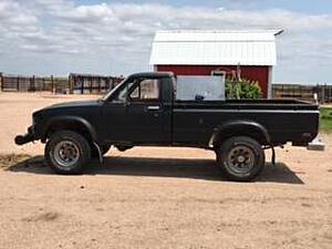

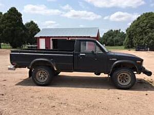

I'm looking for a small 1-3" lift/level for my truck, I definitely want to level it out a bit in the process...perhaps around 2-3" up front and 1-2" in the rear or just do the front and call it a day? I'm looking for reasonably priced options that don't require major modifications during installation. If I could soften up the ride in the process that would be ideal as this will see the street mostly with occasional light trail use. So if there is a "go-to" for this amount of desired lift please let me know. I know all trucks respond slightly differently to lifts I just want to do my due diligence before making a choice.
Thanks a lot!
The truck for reference:

Great question. I'm honestly torn between going a little higher end and going the bargain basement route. I would love to go with OME and it's on my radar but I'm slightly leaning towards going with cheaper route. Highly considering the 3" Pro Comp springs up front and add-a-leafs in the back. As I learned a while back with my Titan actually getting it level like I want may be challenging(from what I've read) since all trucks seem to "respond" differently. Thinking about doing the front before even buying anything for the rear. Fwiw the rear springs are damn near straight and the fronts are quite arched currently.
