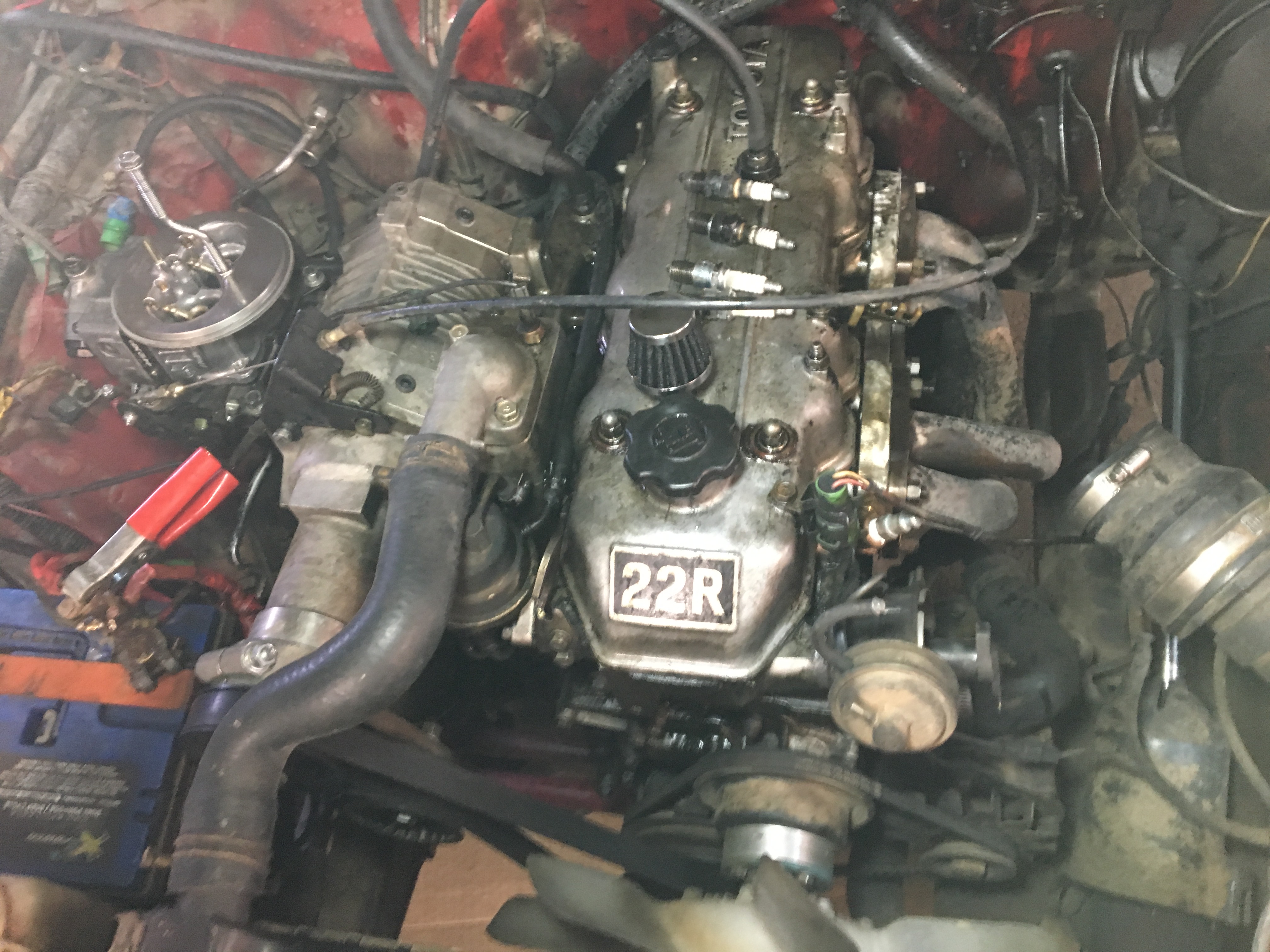

So to lay this out, I've got a motor out of an 82, has 71k miles on it. ( yes you read right, found it with 40k still under warranty)

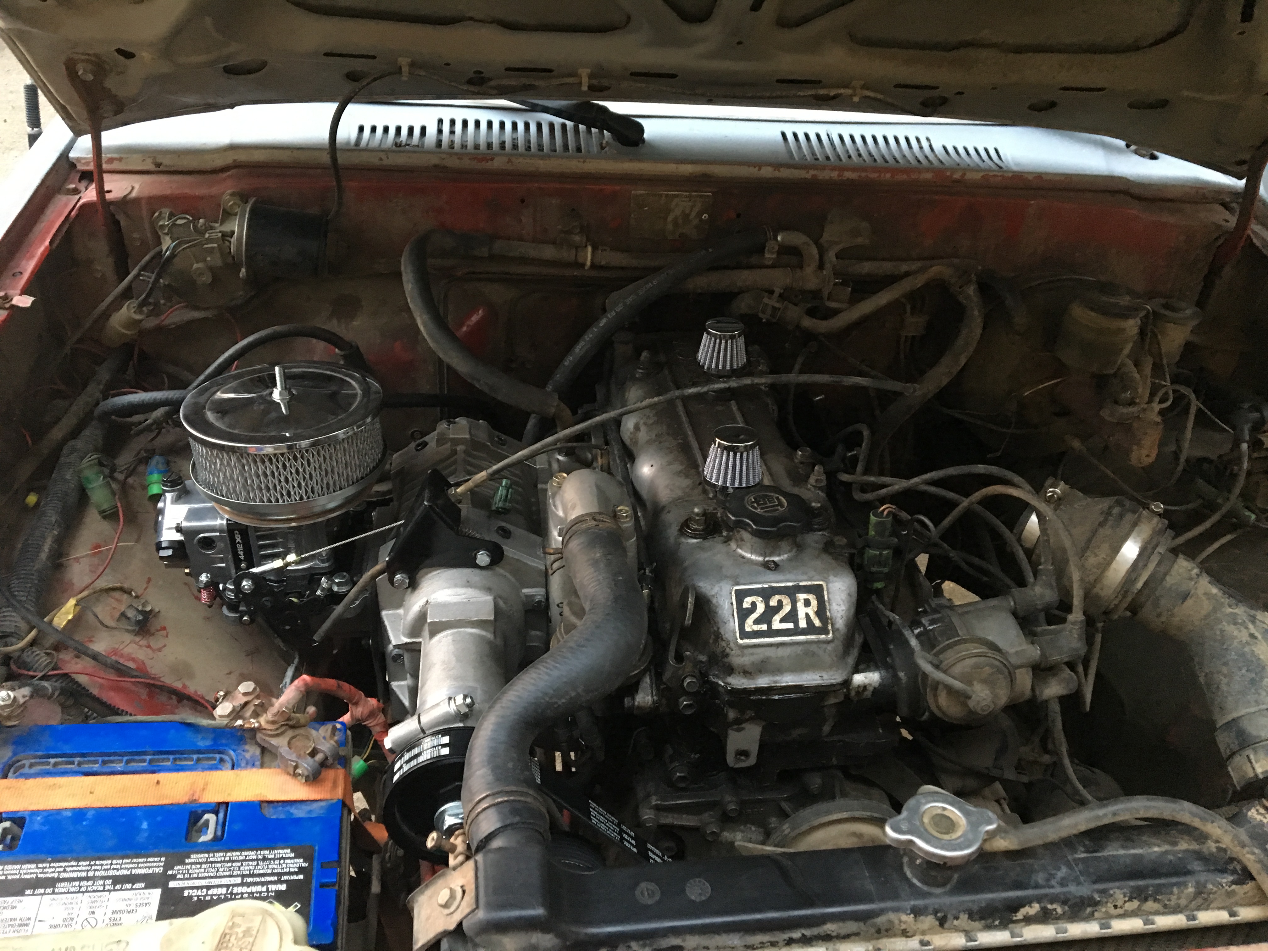

okay so over the fall I decided to go with a LCE supercharger w/ Holley 500 ( let's say this is not bolt on, instructions suck and they couldn't help over the phone at all)
so I winged it. Slapped it on and hooked up gas to the carb and oil to the charger
tore all my vaccines lines out (hated those)
had to move. So put somewhere around 600 miles on it, which was tuning it then hallling all my stuff, great power it's never liked hills and stalls randomly sometimes. Yay!! Never figured out if that was fuel problem or other

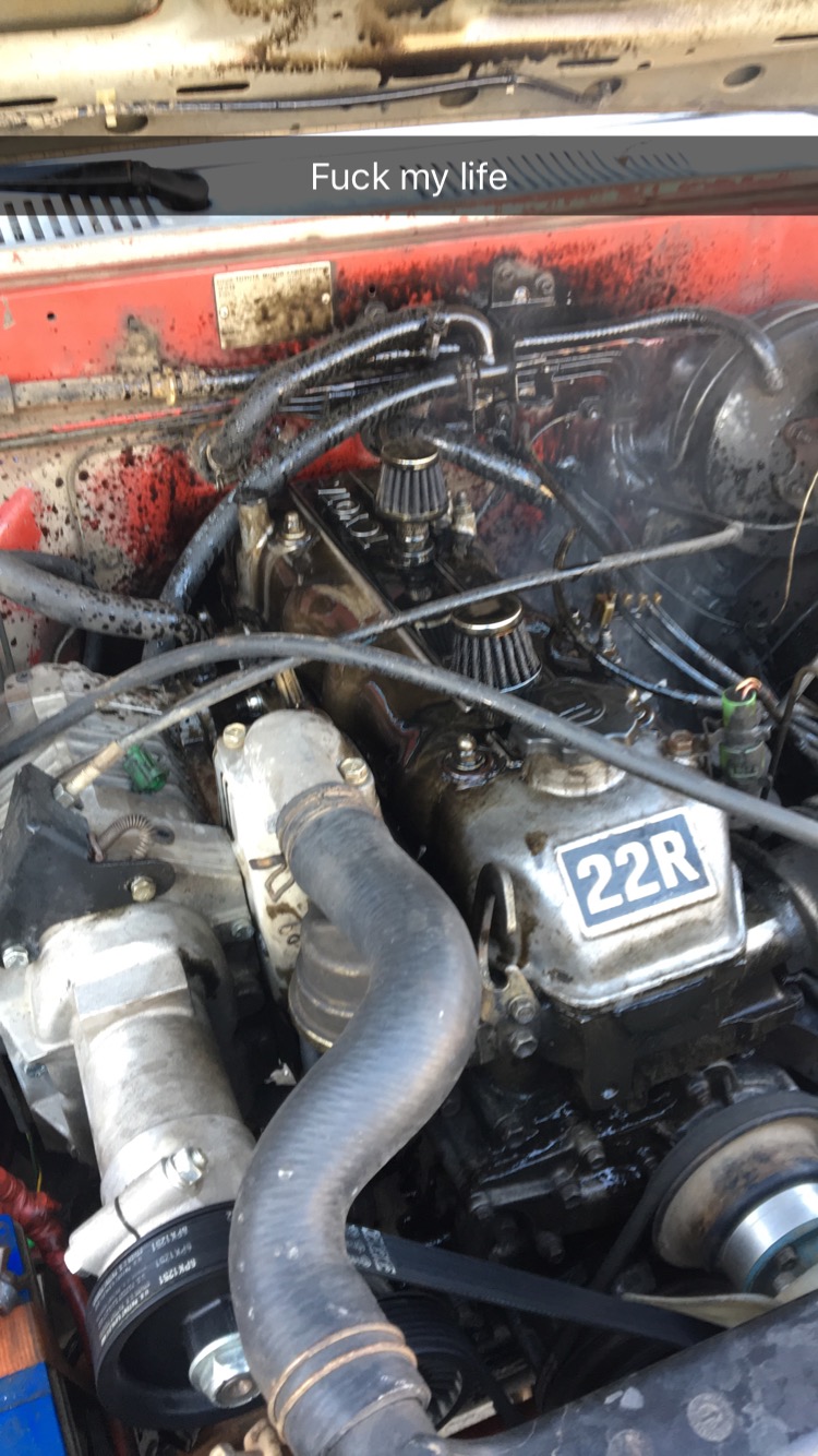

okay so the other day i smell burning oil at about 55mph.... smoke piling out from behind me, turn it off roll... it won't restart and there's oil everywhere. Looks like it blow out the valve cover seals and vents.

yeah, I'll try to take pictures, it seems my best bet is pulling to motor and trying my hand at a rebuild. I've got a 85 22re 280k no title and a 87 189k which is just on a frame. So far everything I see is that my 82 22r is the best to put boost into. But if anybody thinks other parts would be good out of those I'm open for opinions
Old Jan 5, 2017 | 09:42 AM
delmert's Avatar
Joined: Aug 2011
Posts: 271
From: Kansas City, Mo

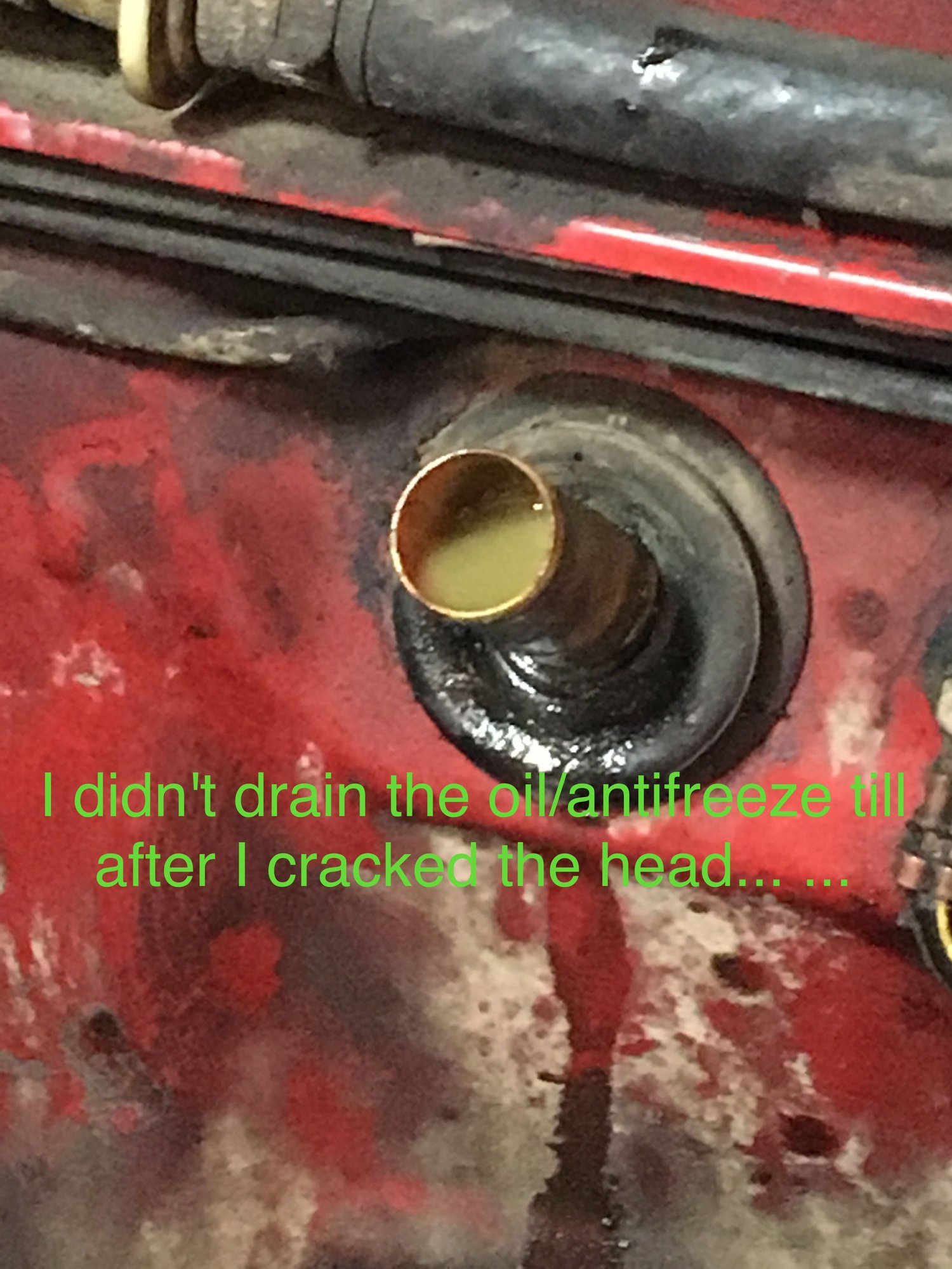

The back left bolt had oil come out. and the other two on the left had some rust and they were tight.
Timing chain is tight... gotta figure out how to unhook it. I like the double, don't forget the bolt under the timing gear
So I cracked the head bolts before I drained everything. Hopefully it didn't mix to much. But I figured the heater core would be the lest ranted from that... looks like I was getting a little oil coolant mix

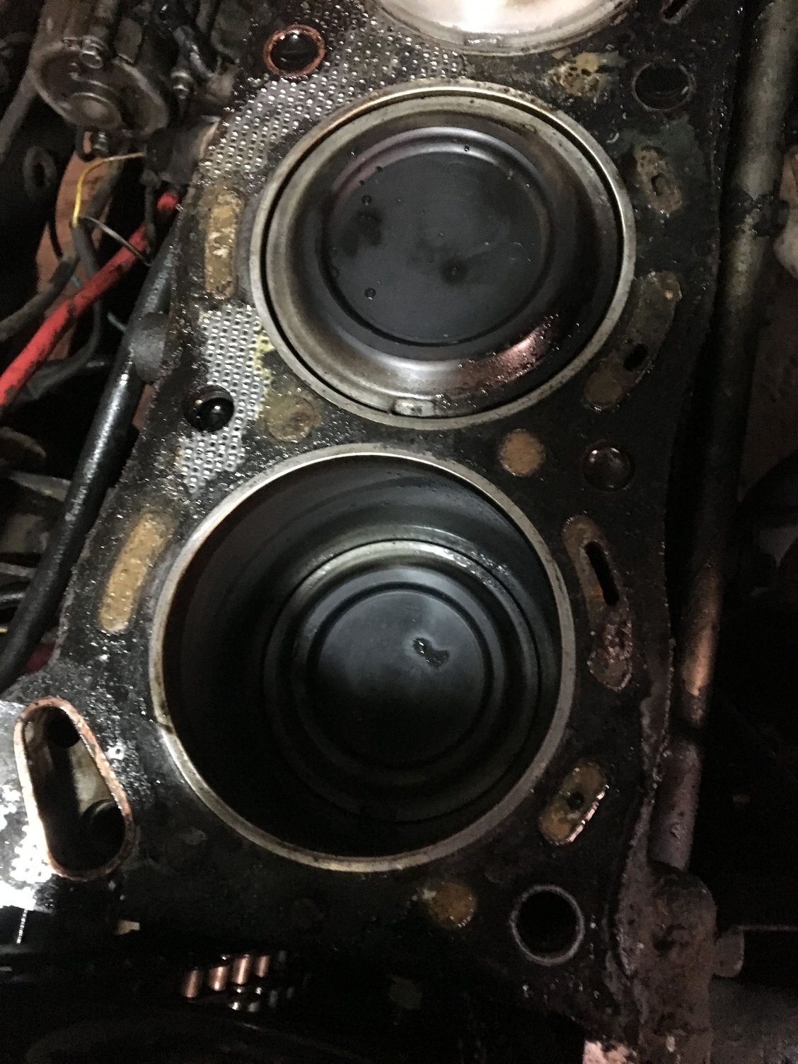

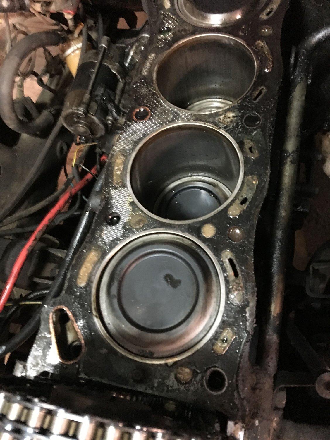

What did you do with the timing when running boost? Timing retard with boost is critical, how much boost were you running and how much total timing on boost? If timing was kept stock maybe you had detonation and damaged the rings which cause excessive blow-by and oil everywhere. Did you have a way to monitor the air fuel ratio when on boost? Around 12.5:1 is a good ballpark at WOT. Once the head is removed check the cylinder walls for scoring, check for metalic flakes in the oil, check for detonation signs on top of the pistons. Can you post a pic of the spark plugs? Cut one up and look at it with a magnifying glass to see if there are specs of aluminum on the porcelain.
Old Jan 5, 2017 | 10:35 AM
delmert's Avatar
Joined: Aug 2011
Posts: 271
Boost is estimated at 5 psi, bought a air/fuel gauge but had to get the truck up and going cause I moved, so that never made it on. Uh, so I adjusted the distributor till it sounded good and ran good. Don't know exactly where I ended up.
I was never able to find any information on that, nor the amount of fuel I was shoving in it. I was guessing the stock fuel pump ran about 7psi of fuel and the Holley 500 said 5-9psi.
Oil is somewhat reflective... not sure if some aluminum would be why.
Im not quite following you on the spark plug, cut a spark plug? Or just look at them up close
I'll get more pics and hopefully the head off tonight.

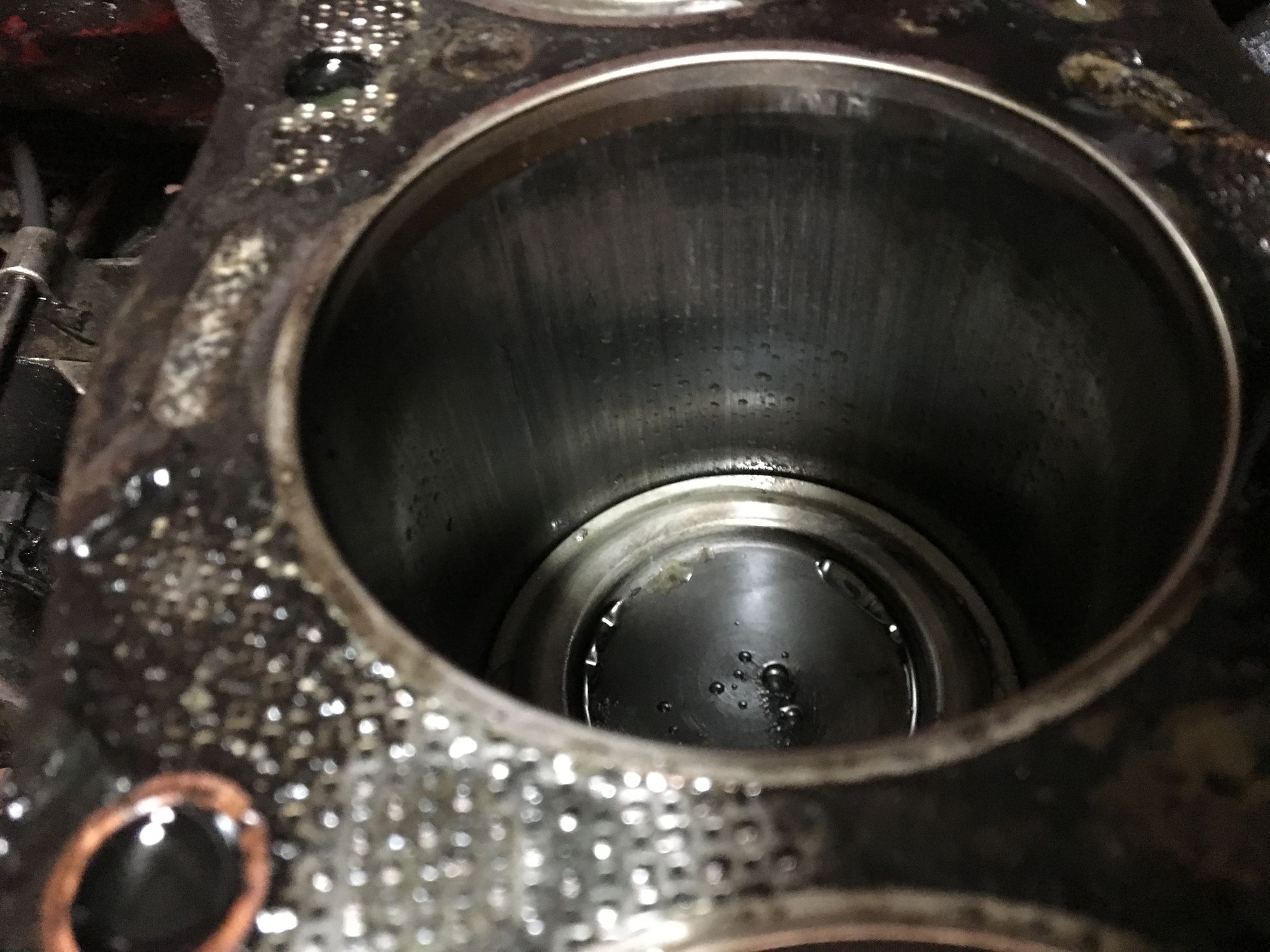

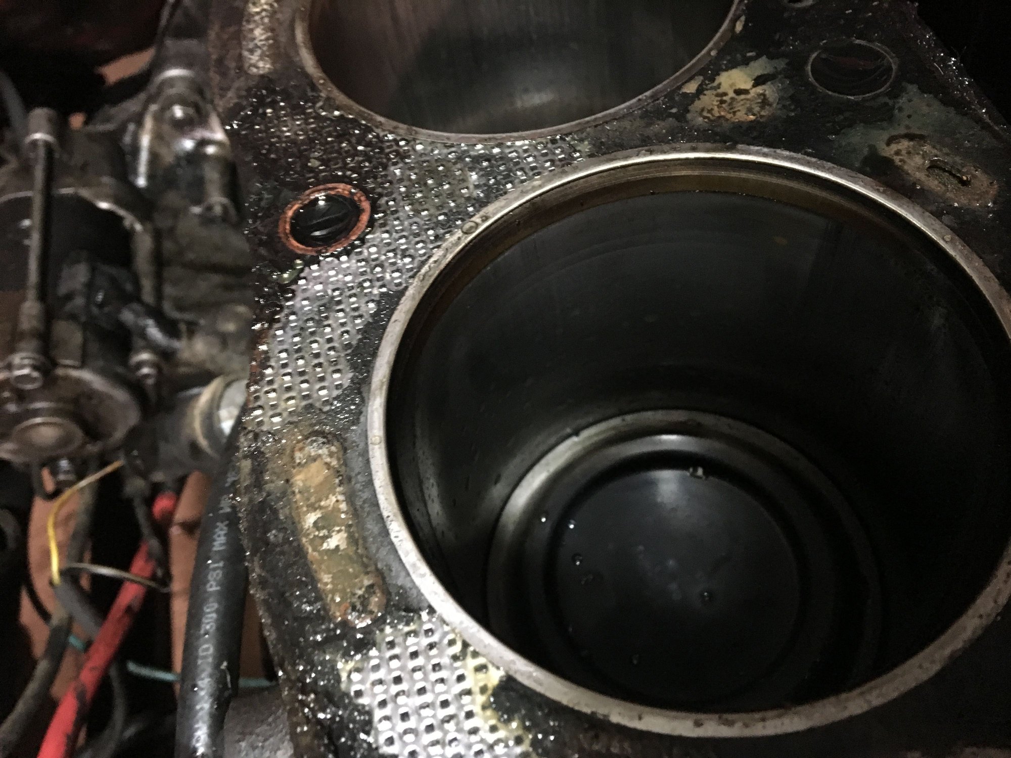

Here's two of my plugs. Not sure what cylinders thery were I
Cylinder 1 is very smooth
Think this is 4. Phones retarded. It's not got the growers like 3, bit it's not smooth like 1 n 2
Cylinder two is smooth
Cylinder 3 will catch on a findernail

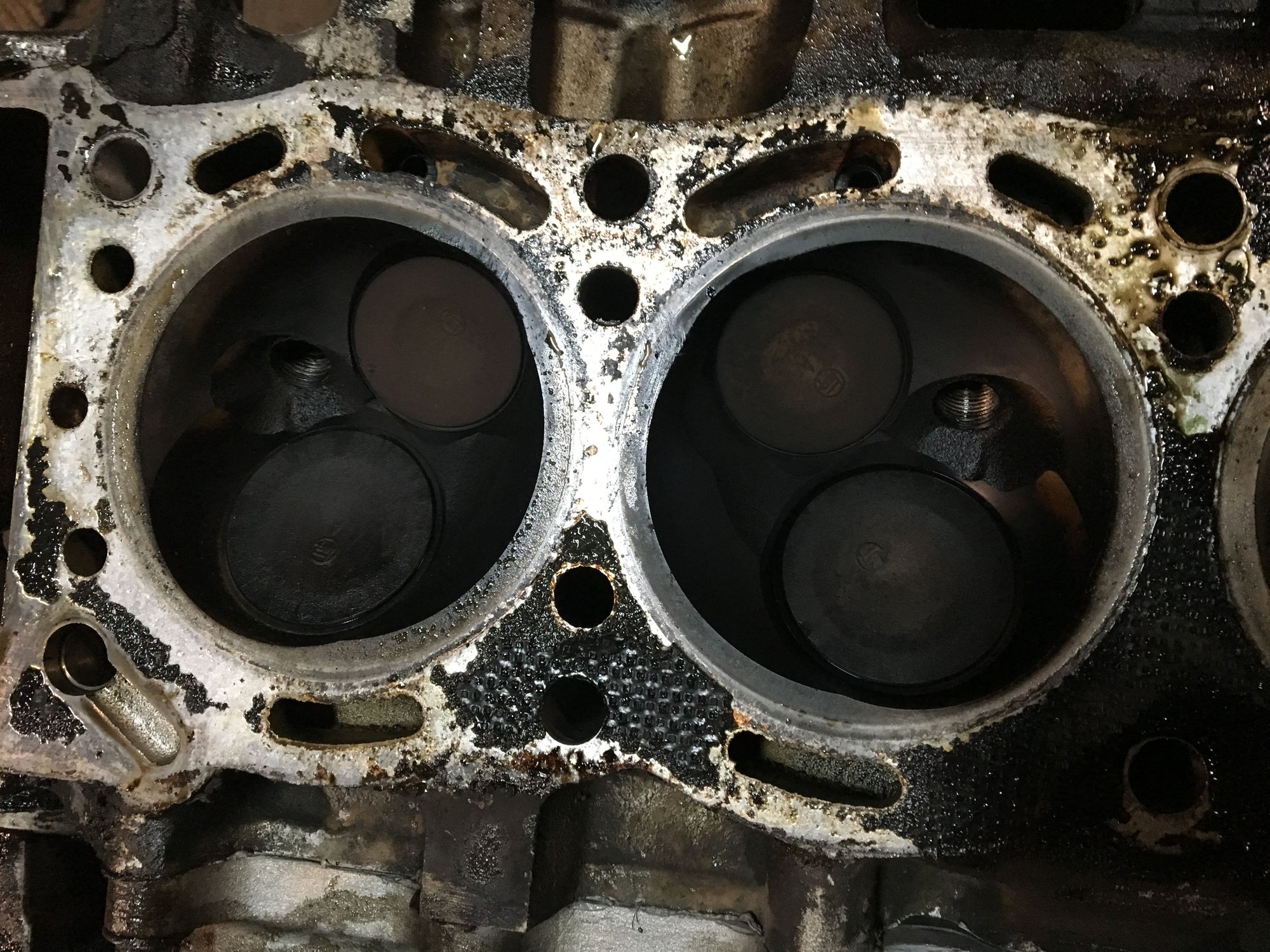

My heads, and intake. Thinking I might pull the valves.
The oil that was in the truck.

Well I'm no expert, but the color of the piston tops, valves and head look very good, no deposit or grayish colours. The scoring on the number 3 bore not so much. Can't really tell how bad from the pictures. As for the oil you can't really tell that way just from looking at it, more like look for metalic bits at the bottom of the pan, you can also cut up your oil filter.
thing is I'm not seeing nothing that's so bad it should be causing so much loss in compression. Maybe I'll find something in the valves.
Should I even mess with the short block... might have someone come look at it. Idk.
Not sure where the filter is, see if I can't add that to my cut open list.
