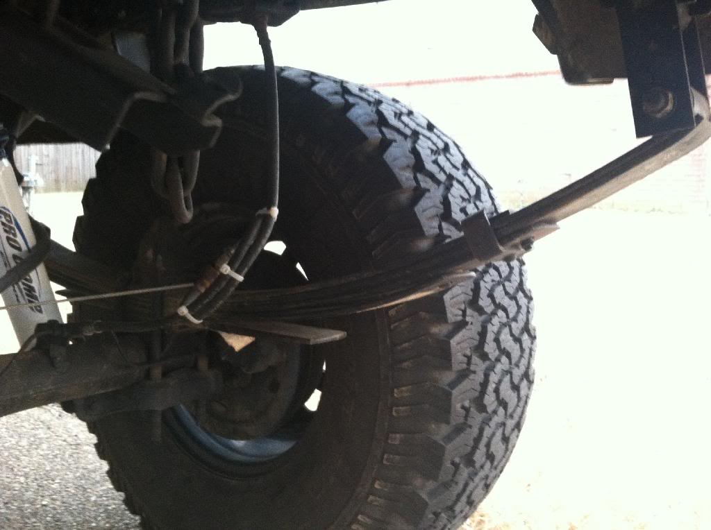

I just looked at and I'm not sure how to do it. I will take some pictures tomorrow and post them.
Little late but here is the picture. I think I could remove the second from the bottom spring.
Old Mar 9, 2014 | 10:09 AM
courtgordon's Avatar
Joined: Jan 2011
Posts: 179
shouldnt be a problem my stock leaf packs are just 2 leafs and an overload which would be the bottom leaf. all you gotta do is take the weight off the springs undo the U-bolts that hold em to the axle and remove the bolts holding them to the shackle/hanger then pull the springs out put a C-clamp on them to hold them together while you undo the center bolt and take off the keeper clamp that you see in the pic up near the shackle then slowly undo the C-clamp you put on and the leaf pack should come right apart. Not hard you might need a can of PB blaster if you have corrosion on the bolts tho. Good luck hope this helps
