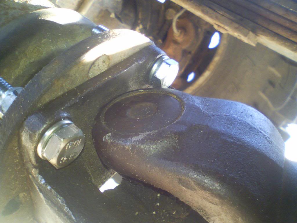

I recently lengthened my front driveshaft, and it the slip and all that is good, but the problem is the front u-joint is binding.
It will still turn on level ground, hitting lightly. But any axle travel and that thing would be locking up no doubt.

My question is if you all think that:
1. I could use the flange from an ifs shaft to alleviate the binding issue.
2. If that would allow enough flex to be safe to offroad.
From what I have seen, the flange for an ifs truck allows a great deal more flex than the one that comes on a solid axle truck.
And you think the u-joints would be the same?

I ordered the flange for the newer driveshaft, I already have a triple drilled pinion flange, I'll let everybody know what happens when I install it, hopefully I wont need any limiting straps or anything.
Then I gotta figure out how to flex my suspension in the driveway so I can see if there is any binding at full droop.

I'm not sure how much engagement I have, But i cut and sleeved the shaft myself, it has an extra 1.5 +/- .5" inches of slip.
Didnt really measure it too precise, but I know it won't bottom out, and it shouldnt come free when the axle drops

you need some degree shims to point the pinion back to the shaft
6* shims should be the ticket
+ those flange bolts don't look correct .. are they grade 11 ?

I also cut off the dust shield that is usually there when I lengthened the driveshaft, so it is showing more spline than a normal shaft anyways.
With the front axle flange not connected, the double cardan still has alot of droop left, so all the problems are in the front u joint, and I looked into taking apart and grinding(clearancing) the double joint, and that should help if I need to.

I really don't wanna mess with shims, as that would throw my caster off, and right now my truck drives beautifully in a straight line and the tires are wearing evenly.
Those flange bolts are 10.9 metric bolts, not the weakest bolts for sure but definitely not the strongest.

Your pinion angle should be parallel to your t-case angle for the driveshaft and u-joints to operate properly. Without actually cutting and rewelding the spring perches and steering balls, the ideal situation on these lifted solid front axles is to sacrifice a little bit of everything to get it to operate and ride as good as possible. A 3-6* shim will mostlikely solve your problem without causing any drastic adverse affects to your tire wear and steering

6 degrees will help the angle some, but handling will be greatly sacrificed. I cut and turned mine 10 degrees. Here's how it looks with 4 inch springs and stock length shackles.
