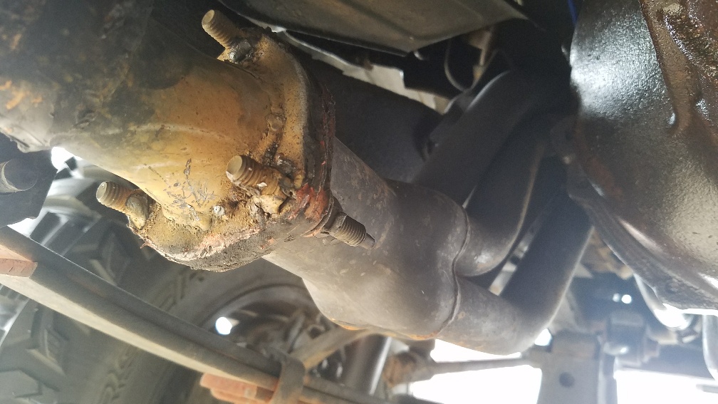

I got a headache from the 1 1/2 hr drive home, as the cab is full of exhaust fumes. There's a hole in the muffler which is located directly below the driver seat. And the exhaust is dumped just behind that (before it gets to the rear axle). The floorboard is not 100% solid, there's small holes in it, and the shifter boot is all torn up, so all that exhaust is coming right up into the cab. That will be the first thing I do to it. I will be using this a hunting vehicle, and can't be smelling like gas fumes..I'd really like to get it as "clean" smelling in the cab as possible. Whether that means a new muffler, extending the tailpipe out to the back of the truck, and sealing up the holes in the floor, replacing shifter boot, etc. Should I look into adding a catlytic converter or anything like that? I figure most people rip them off, they'd probably think I was crazy at the muffler shop asking to put one on. But I really would like to enjoy driving it, and right now it's pretty brutal (sound & smell wise).

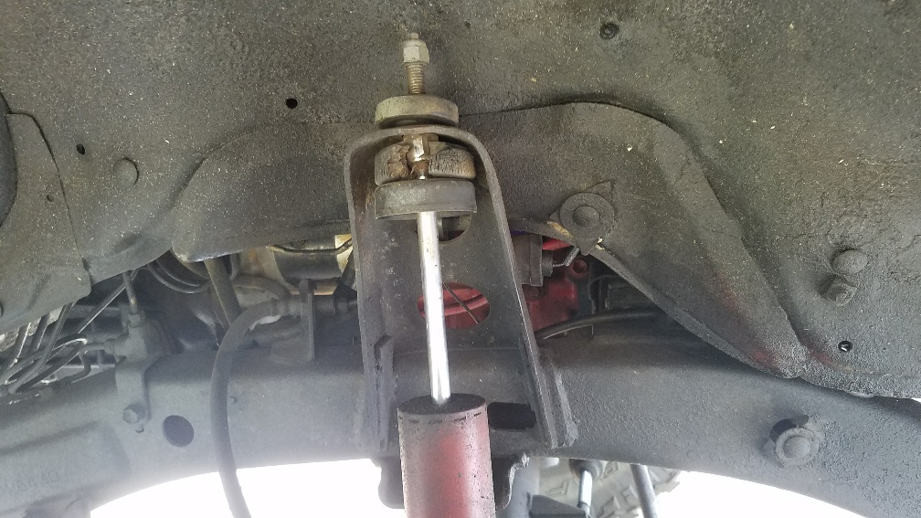

I noticed one of the shock bushings is gone up front. I need to figure that out.

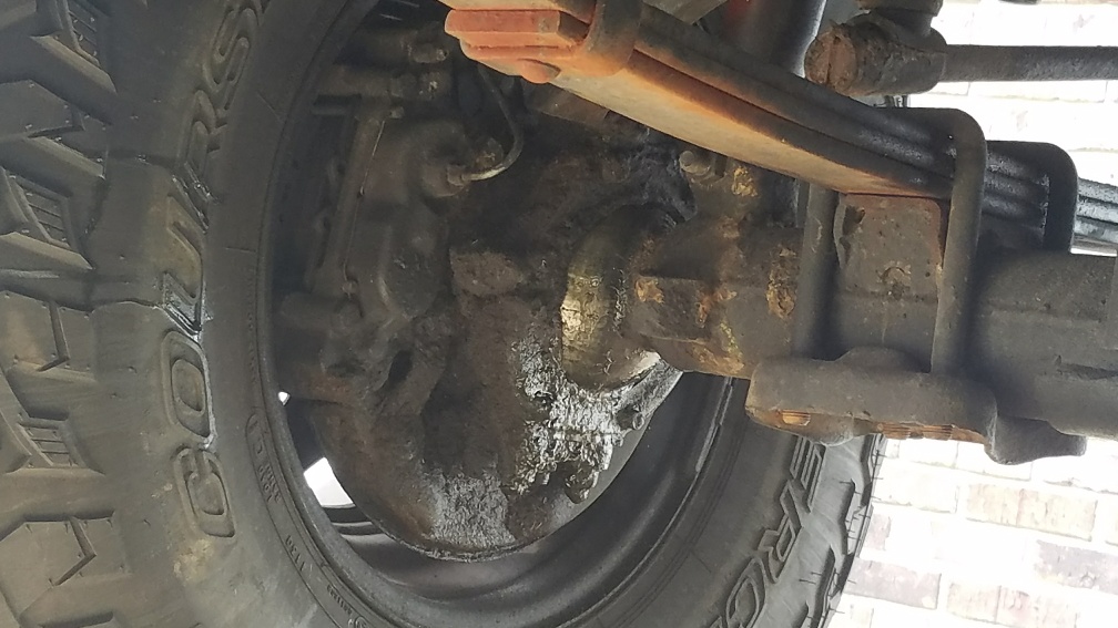

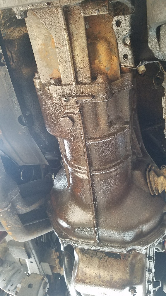

Leaking fluid/oil all over the front drivers side tire, what could that be? Axle seal or brake related?

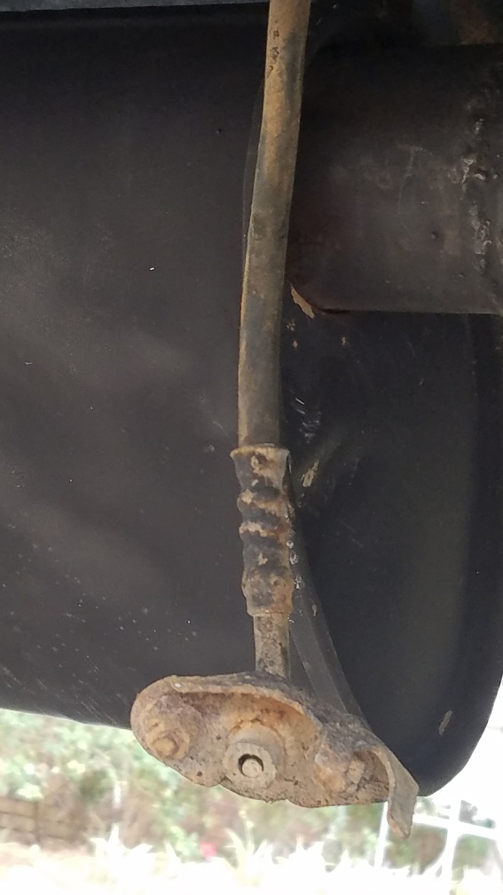

There's a wire hanging down underneath the truck with a metal thing on the end of it, right next to the muffler. The wires run up into the cab, underneath the seat. Looks like an electrical device maybe some sort of 02 sensor or temp sensor of some sort? I'll put a pic up.

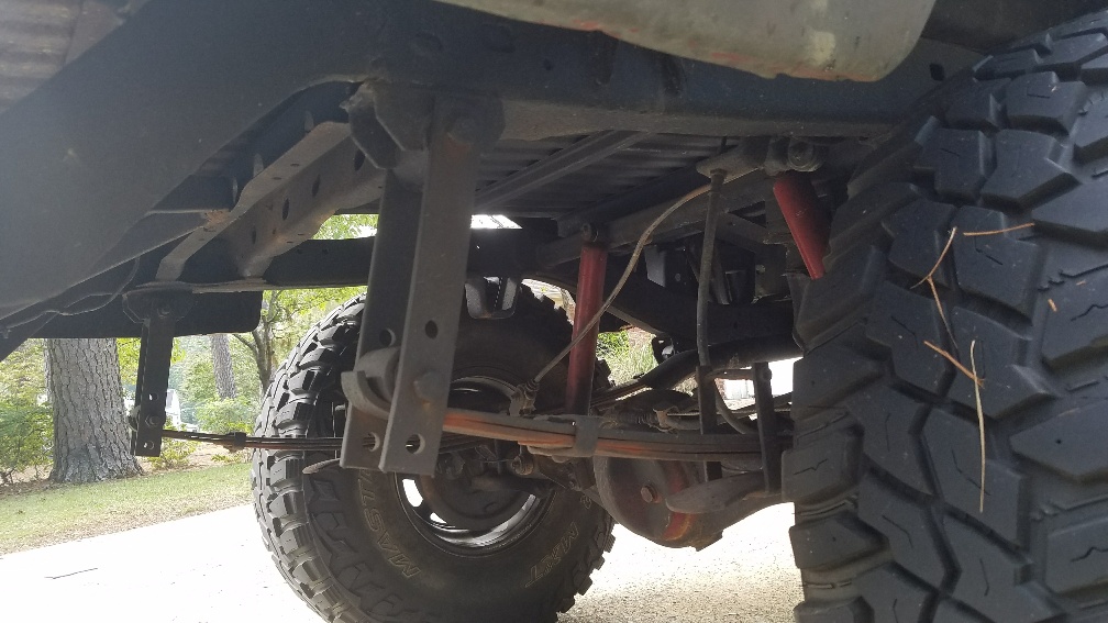

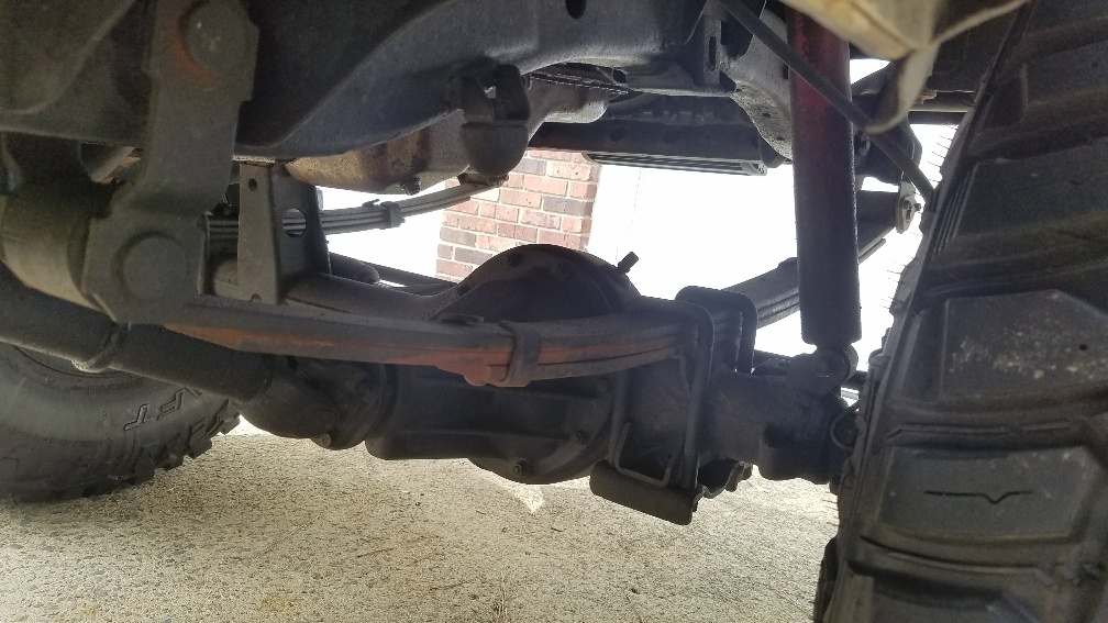

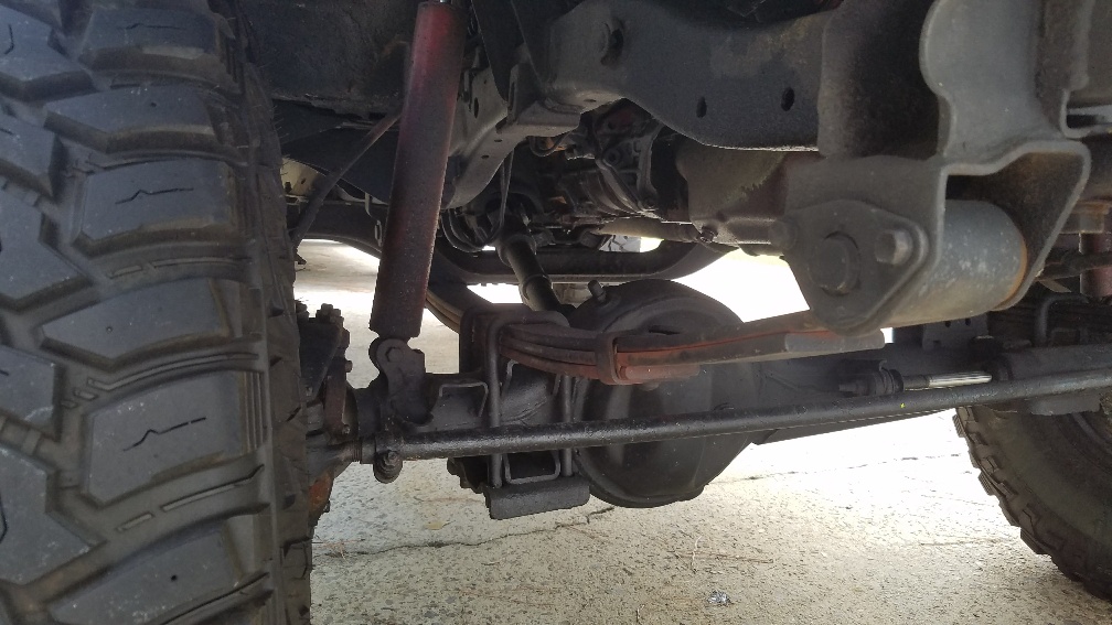

The front springs look to have more arch than the stock arch, which maybe the PO had put in to run the 35's. Here are some specs that you can check Width=2 3/8", 22 3/4" from the center of the eyelet to center bolt along the the spring surface in both directions, and the depth of the arch should be around 2 3/4" and the spring pack thickness should be around 1 3/16"

I'm looking at the axle/knuckle seal repair and it looks messy but do-able with a lot of patience and maybe a little swearing. It looks like the Marlin Crawler axle seal kit is the best of the breed. Should I go ahead and get the bearing kit as well, or would repacking the bearings be OK if I'm not having any problems with them? Not sure of the miles on the truck, the odometer doesn't work. Should probably just spring for the new bearings to keep from having to do the whole thing again.
I will look into the distributor grounding, hopefully that's what it is...would be an easy fix.

So the truck has been in and out of the muffler shop all week. They welded in a new straight pipe (in place of the original header flange which was loose, and was a "weak point" according to them), and then fixed a leak at the muffler, and then welded in a new pipe out to the back of the truck. There were a couple leaks in their welds that I would find when I got home, but I think we finally got it right this last time. There's still a pretty bad exaust smell from the truck in general, but it must be just because it's an older truck with no cat? Do all of them smell like that? When I'm moving it doesn't bother me, but sitting at a red light with the windows down it's pretty strong. Is that just something I have to deal with? The exhaust now exits behind the drivers side rear wheel. Would running the pipe over and dumping it on the passenger side do anything to help with that, or is it just something you have to live with, with these older trucks?

I will be checking & cleaning up the ignigtion coil ground this weekend, in hopes that it takes care of the chugging/rpms dropping issue. Will keep you posted on that.
I'm moving on to the axle seal leak now. Getting ready to order the kit from marlin crawler. It looks like the only difference between the "knuckle service kit" and "knuckle gasket & seal kit" is the addition of the knuckle bearings in the "knuckle service kit"? Are the knuckle bearings typically necessary or recommended for this job? Anyone with experience doing this seal replacement have any recommendations there?

Lons81- I haven't measured my front springs yet but I will to confirm if they are original or if they've been upgraded to something larger. Thank you for the specs on that. I will report back shortly.

Since you're unsure of mileage & service interval, I'd recommend replacing wheel bearings while you have the front apart. Also, you'll need to get the o-ring for the manual hub dial separately (got mine from dealer). It doesn't come w the Marlin kit.
If you have have access to a parts washer for the knuckle rebuild - It'll make the job slightly less crappy
