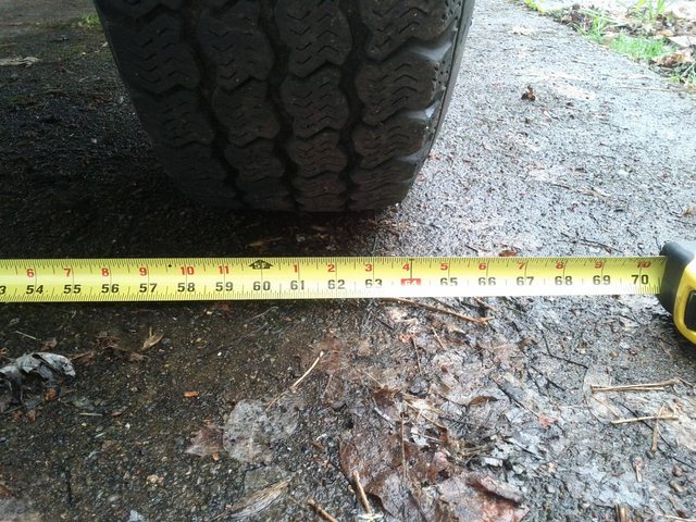

Here is a picture I took yesterday of my stock 81 4x4 with stockish tires:
It looks deceiving, but the number I got was around 65.5" from the passenger side outside tire to the outside driver side tire.

Damn, that's going to be close , thanks for taking time to do that for me . Looks like a 1/4 on each side will be all ill have

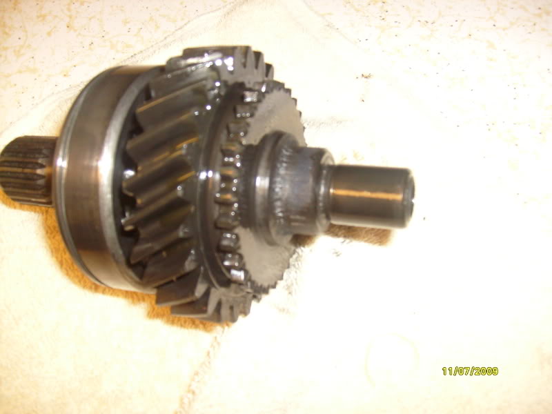

here is a pic of some of the damage I did...input shaft to my crawl box.
here you can see the fubarred bearings:
i don't think the spline coupler in the tranmission is supposed to come out when you pull the transfer case
as near as I can tell the t/c went into low range or the transmission went into gear. destroyed one L52 transmission and a t/c...all because I was too lazy to lay on the ground and pull 4 bolts

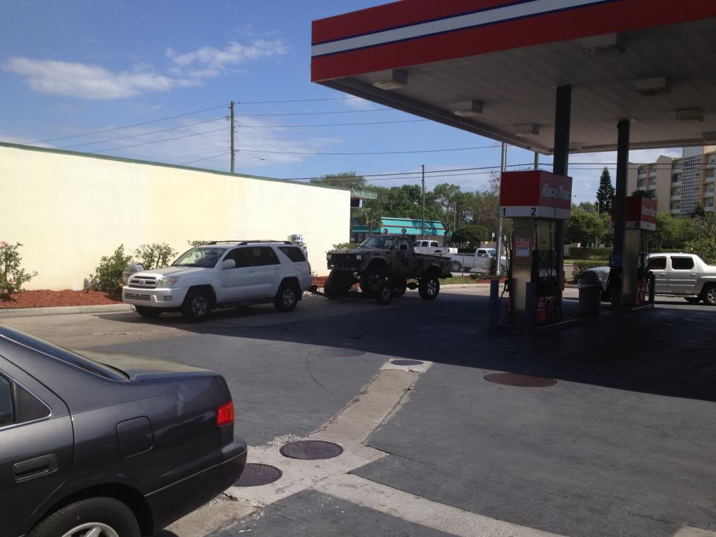

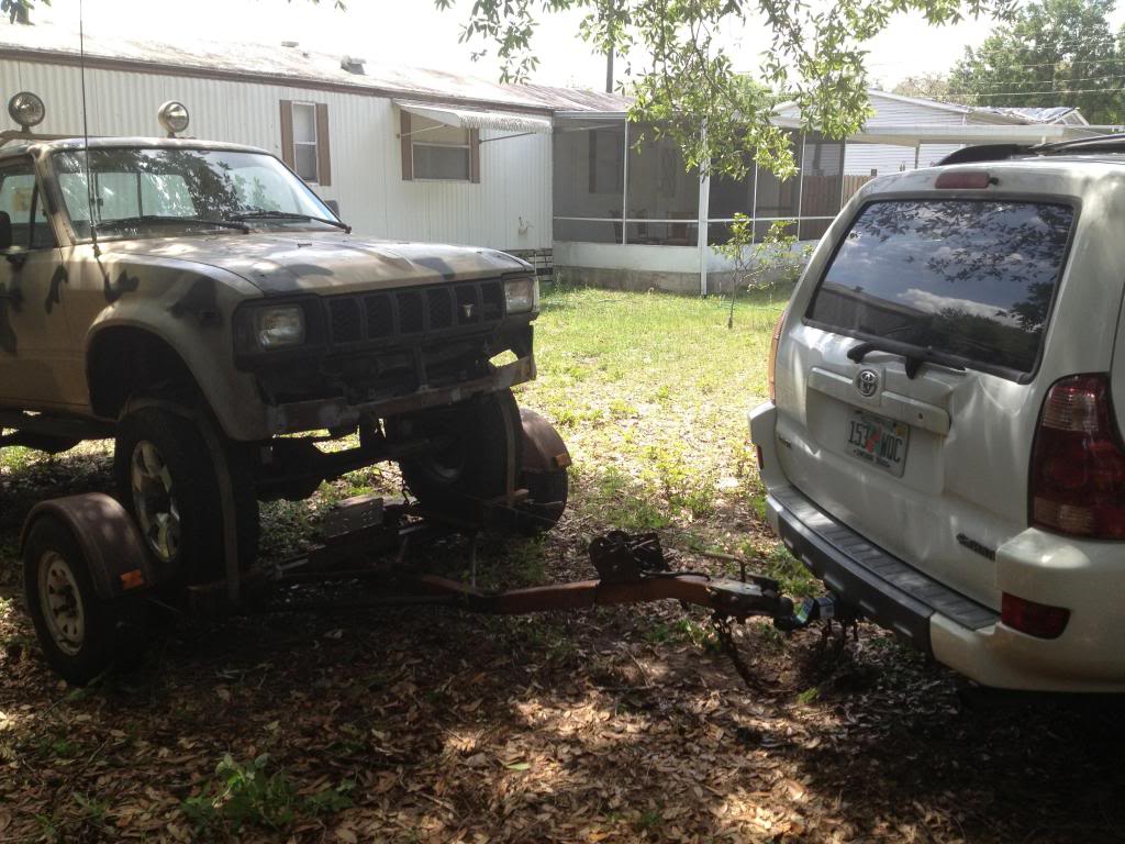

Old Apr 8, 2013 | 02:37 PM
1980 Pinellas's Avatar
Joined: Mar 2013
Posts: 88
So it made it home ok. Thanks for all your help
