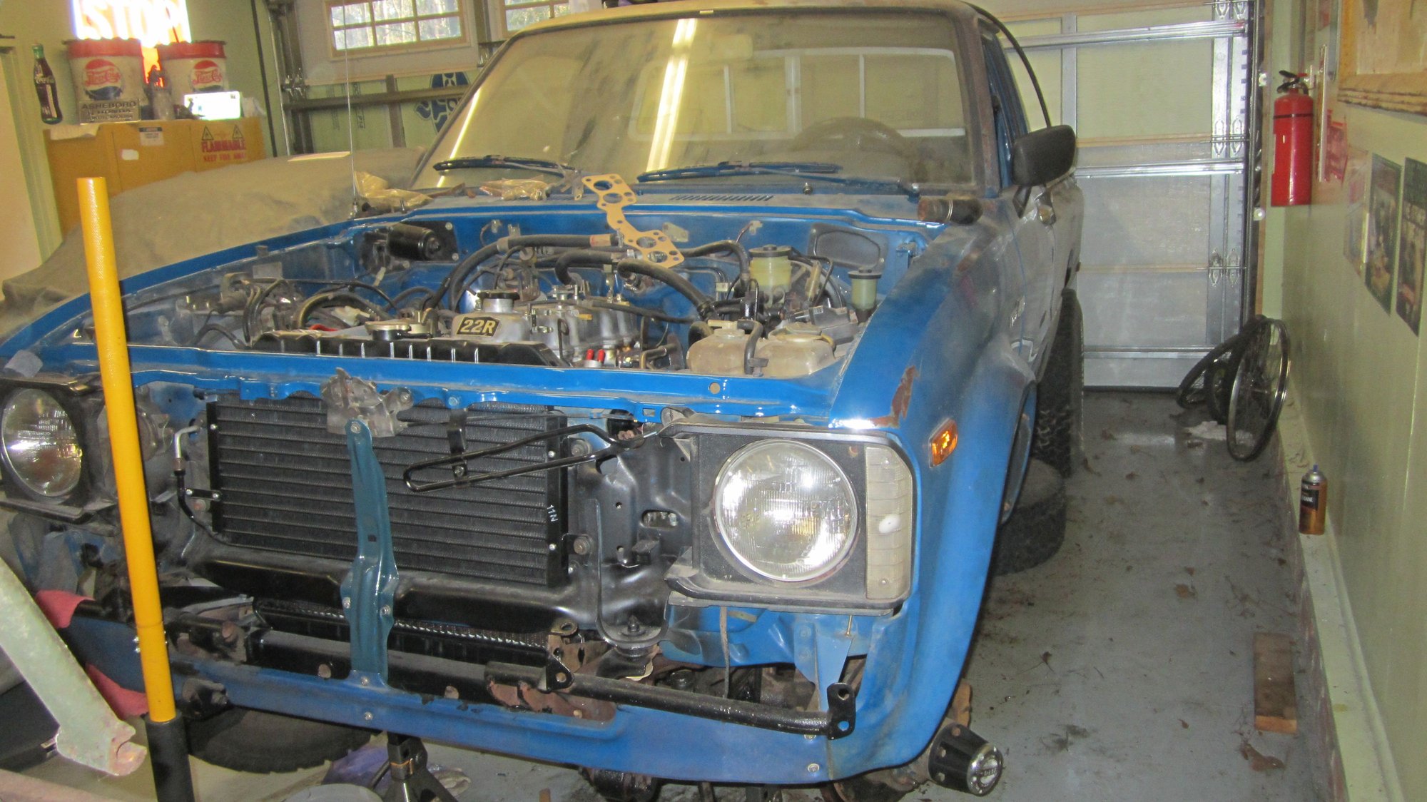

Need help with stalled project 1981 Hilux
At over 200K, replaced the timing chain and rebuilt the top part of the engine.
Can't figure out where all the smog lines go back to re-install the rebuilt carb.
Need advice and help to get it going again.
Should I de-smog and go with the Weber? or keep the stock setup.
Installed power steering while it is down.
Also can't keep front axle seals from leaking for long. Should I go deeper or use different seals, ECO seals, of Trail Gear?
Any help and advice will be appreciated. Also have a spare tranny and transfer case. Dual transfer case and lockers may be in the future.
Front of Yota truck
Thanks for any advice and help you can give.
Dave
