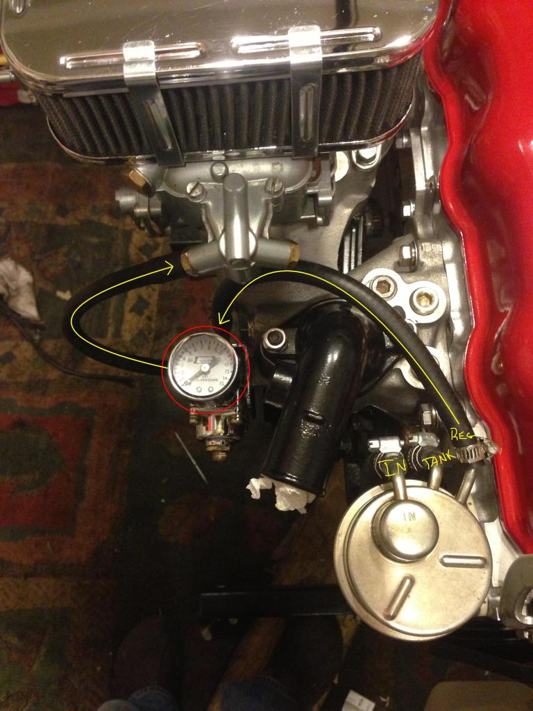

I am not getting enough fuel into the carb. I hope i didnt put the wrong hoses on the wrong ports on the fuel tank, but I think thats the issue.
Does anyone know which ports from the top of the tank are what?
I have scoured the googlez, and I sometimes find fuel tanks for Landcruisers that should be similiar, but I think I put the wrong lines on to the fuel filter.
They are easy enough to get to but I cant find the labels for the right ports.
Outlet, Return and Vent.

If you stand on the passenger side of the truck and face the gas tank the port on your left (towards rear of the truck) should go to the filter. The port on your right (facing the front of the truck) is the return line. Have you verified the hoses on the fuel pump are hooked up correctly? See pic below:
(in this pic is a weber carb. where the line is going to the fuel regulator is where it should connect on your stock carb)
If they are hooked up correctly then I believe you have a carb problem. Your float and needle may not be letting any fuel into the carb bowl. I had that problem after a carb rebuild I did.
Did you mean that you had that problem before you did the rebuild, or after. Because I'm having that problem and I want to try the rebuild kit.
I just got done verifying all the fuel line connections to the tank and even took out the (OEM) fuel filter I just replaced a week ago to put in a see through filter (regular 1/4").
83Toyota88, you are a beast! Thanks for the photo, that really helps!!!
