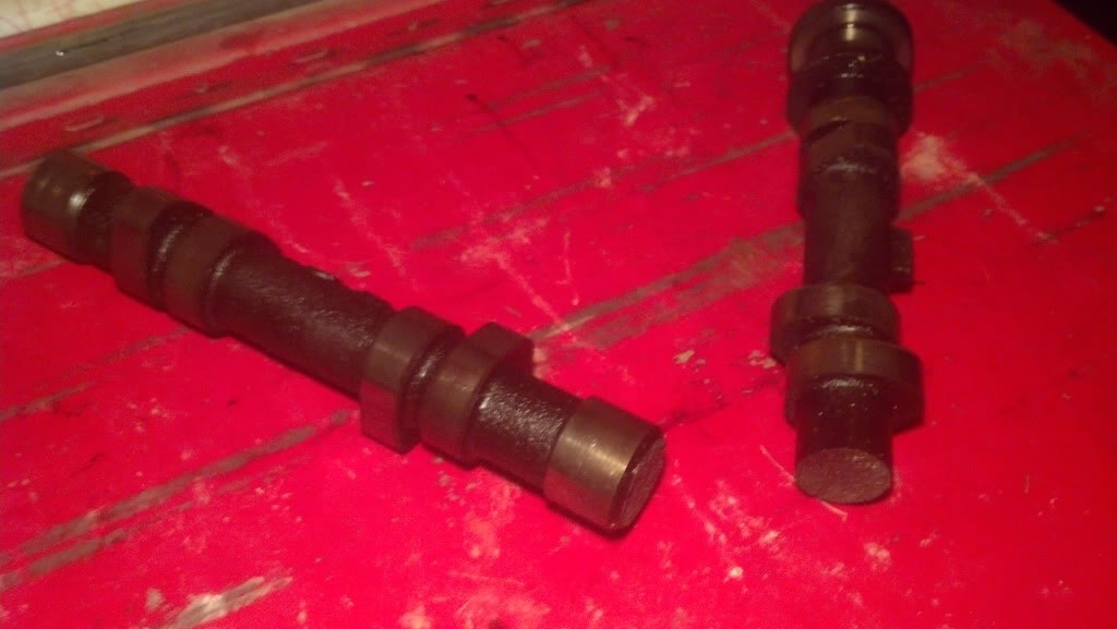

It still was idling. Very rough, however. I managed to limp it home BARELY. I checked compression the next day expecting a thrown rod. 1-110 / 2-60 / 3-20 / 4-60. So I pulled the head. I did find a failed ring on the head gasket ( felpro printoseal ). I checked the block and head for any warpage .003 lengthwise and .001 across total. I installed a new head gasket kit. Then upon re-installing the cam notice that it is CRACKED!!! in half just before the middle cap.
I picked up a complete 22r head and cam setup from a local yard. I swapped out the cams and used the 22r aluminum rockers. I adjusted the lash .008 and .012.

it was about 0 deg F out. I started the truck and let it warm up. When it had it's 15 min. I kicked the idle down with a tap of the throttle and putted down the road as any other morning. I stay below 55 on the interstate as it seems to really work hard to go any faster. I get 3 miles away and while climbing a medium hill at 45 in 4th I hear a LOUD! THUDUDUD DUD DUD DUH!!!! it felt and sounded as though the drive shaft broke and I was getting nowhere quick.
