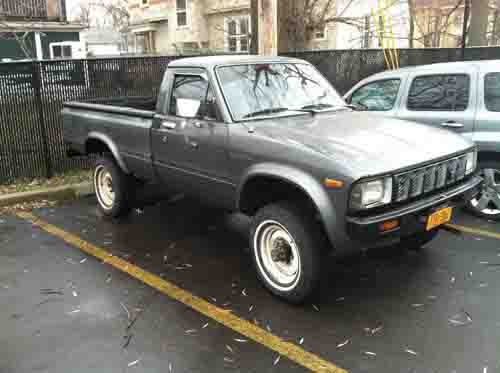

Man your truck is looking great! Here is a small pic- don't know how to post the big ones yet- of the truck I saved from the scrap metal dealer in town. Sorta looks like your grey one.
