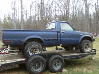

first off im new to yt. I inherited my uncles 1983 toyota p/u and i need so ideas to help it run better and stronger. i need things to be cheap since im only 15 and dont have a job. the truck sat behide a barn since 1994 and has problems. it will crank but wont idle and now the freeze plug decided to spring a leak so im waitin to get a new one. so till i get that ive been searching it for other problems like rust. does any one no where some hidden spots are at for rust. i havent found any but on bolts, bed, and surface rust on the frame.
does any one know where i might find a good cheap long bed at in north carolina. i will hopefully get some pics up soon.

Attached Thumbnails my '83 p/u-0305111643.jpg
Old Feb 7, 2012 | 04:58 PM
DrSnow's Avatar
iTrader: (4)
Joined: Jan 2012
Posts: 56
From: Hood Canal
Looks like great project truck. Bed is most susceptible to the rust.
